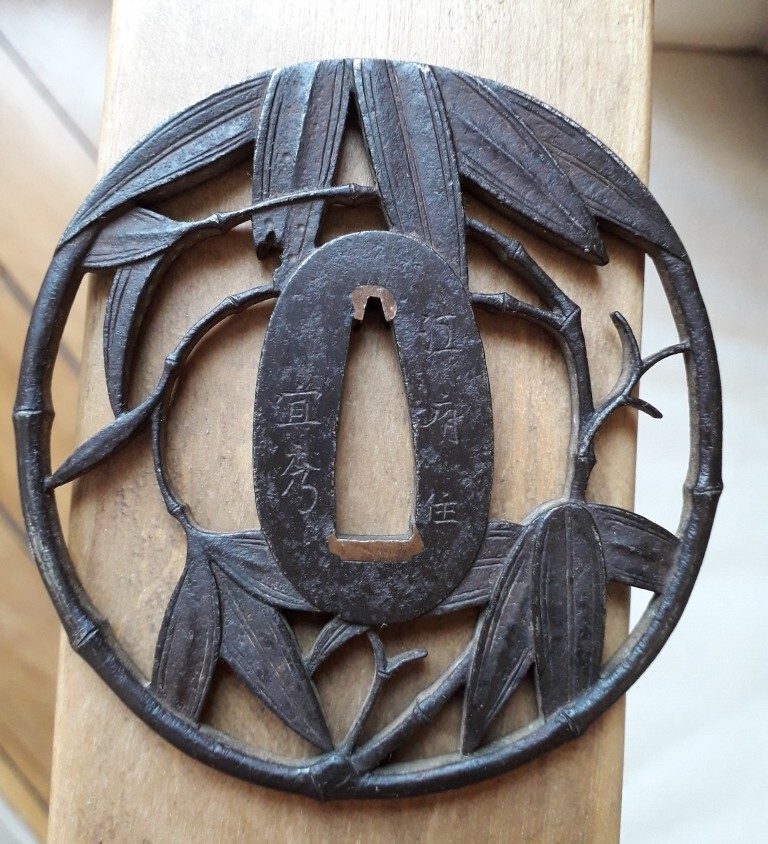

Itomagoi Posted February 25, 2024 Report Posted February 25, 2024 Hello, I would like to hear your opinion on this tsuba. Is it an original Japanese tsuba from the edo period or rather a modern tsuba for iaitos? I have not yet found a comparable bamboo tsuba. Maybe this one is also from manufacturers like paul chen, citadel... The tsuba is well made, looks good and I think the signature is Hidefusa 英房? But there is a number 400 stamped on it. I also find remnants of green glue in Nakago ana. That makes me doubt it. If the number is a production run, there must be at least 399 more such tsuba. :-) I look forward to your comments. 4 Quote
vajo Posted February 25, 2024 Report Posted February 25, 2024 Its old i think maybe late edo. I think it is a museum mark or made by the owner. 1 1 Quote
ROKUJURO Posted February 25, 2024 Report Posted February 25, 2024 I believe Chris is correct. It looks like a very nicely made BUSHU TSUBA to me. 1 1 Quote

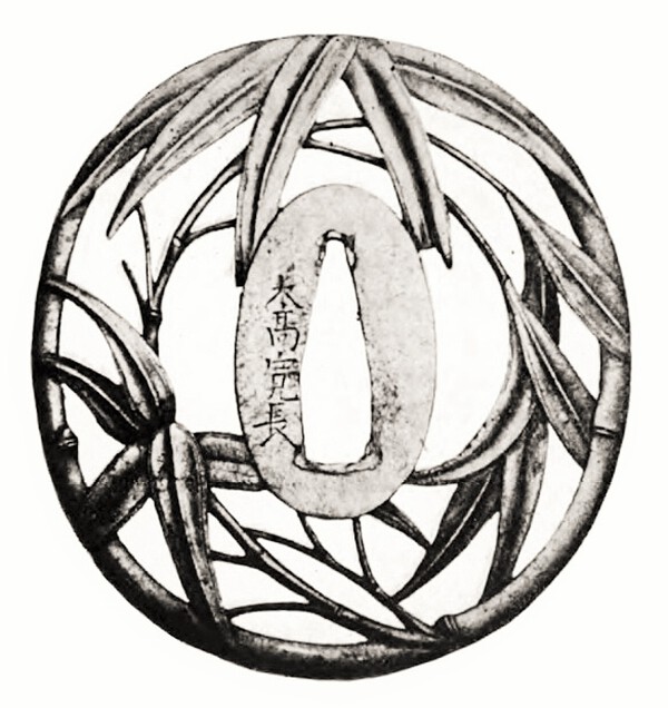

vajo Posted February 25, 2024 Report Posted February 25, 2024 Same motif, different in details. 1 1 Quote
mecox Posted February 25, 2024 Report Posted February 25, 2024 Tsuba has some very nice 3D carving plus fine detail work in the leaves, including insect nibbles on the edges. Pity about the stamped numbers. 1 Quote
Itomagoi Posted February 25, 2024 Author Report Posted February 25, 2024 Thank you all very much. Now I have no more doubts about this tsuba and I can easily remove the glue without any damage. Chris, can you give me the signature of your tsuba? Quote

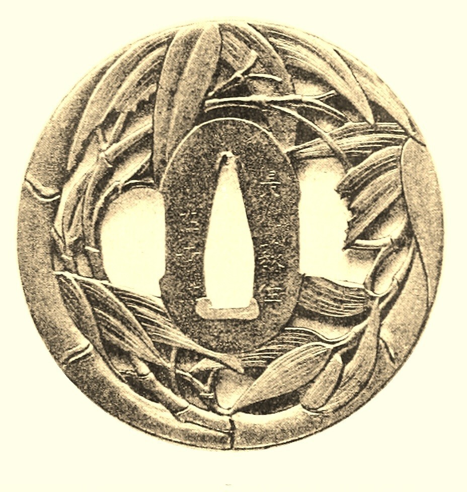

Spartancrest Posted February 25, 2024 Report Posted February 25, 2024 The PORTFOLIO: by Philip Gilbert Hamerton. published 1889 and HANDICRAFT No. 6&7 Japanese Sword Guards: by Francis Stewart Kershaw 1912 1 Quote

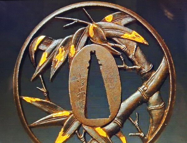

vajo Posted February 25, 2024 Report Posted February 25, 2024 On 2/25/2024 at 8:55 AM, Itomagoi said: Thank you all very much. Now I have no more doubts about this tsuba and I can easily remove the glue without any damage. Chris, can you give me the signature of your tsuba? Expand Shôsai & kaô Takigawa Shôsai from Kôfu 1 Quote
Stephen Posted February 25, 2024 Report Posted February 25, 2024 (edited) The one that got away. On my Holy grail for some time , sorry can't find pix this is off LT screen saver Edited February 25, 2024 by Stephen Spell error 1 Quote
