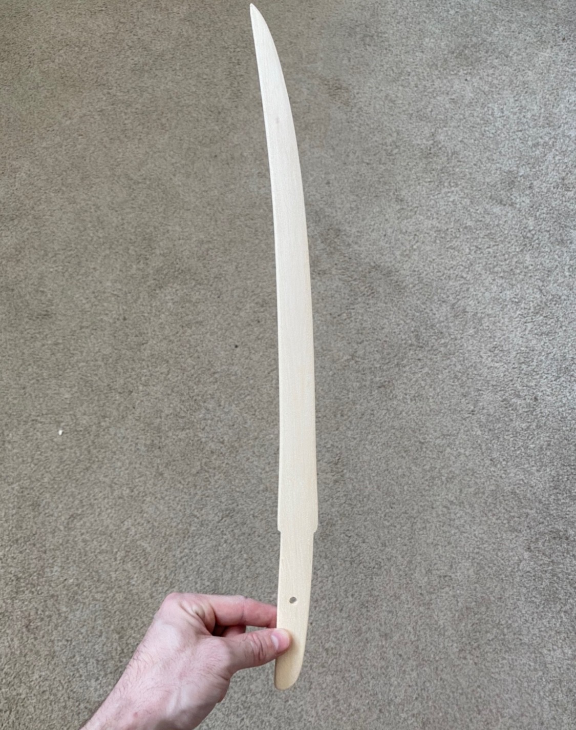

Got bored today and decided to try to make my own Tsunagi for a Wakizashi I’ve got. It’s an out of polish, mumei blade with WW2 leather saya cover.
Anyway, the process gave me a whole new appreciation for the precision of koshirae craftsman. Wow, it was challenging to fit!
Just sharing for the sake of sharing,
All the best,
-Sam

Thanks ya'll! Very kind words!
@Wayben, probably not anytime soon for the Shirasaya. Although, I would love to learn a craft like that from a professional. Like everything Nihonto, I'm told it's no easy task, and would require some training and mentorship to do it correctly. I imagine some special tools too. I'm still relatively young, so maybe someday!
My next challenge will be making a shinogi-zukuri tsunagi for a longer blade. I'm also working on an antler kake for myself.
I'll photo document my process next time - but for now here's a synopsis (i'm sure there are better ways).
I used an 8mm plank of wood from a craft store, and measured the blade with plastic calipers. I then drew the blade on the piece of wood with a pencil, and used a dremel tool to cut out a rough blade shape. I then widdled it down with a pocket knife to get a closer blade shape and establish a slight bevel. From there, I took some more precise measurements, and established the mune-machi and ha-machi locations. After that, it was all sandpaper and filing - being careful to sand an iori-mune at the mune-machi.
*The hardest part was getting the habiki to fit, and I was surprised how thin the piece of wood needed to be. especially at the edge. (probably no surprise to ya'll :rotfl:).*
*I used a photo of the blade and measurements for reference, and took the sanding and filing to another room (Don't want to get sand paper particles all over the blade).*
*Being extra careful to clean the wood of particles before attempting a fit (see above ^).*
*All said and done, I learned a lot. I ended up with a slightly different blade geometry, but at least it fits!*
My motives are to be crafty and practice, rather than entrepreneurial. Unfortunately I work too much right now.
Thanks for reading my long winded comment,
Edit: added side by side photo, and the next blade I hope to make a Tsunagi for, from my type 98.
Cheers, and all the best!
-Sam

Well I made another one for my Type98
This one was tough, and ended up a bit more crude than my first. I used a harder wood. The shinogi-zukuri shape was considerably more challenging… and I would say I failed at establishing it :rotfl:
That being said, it fits great, and holds the koshirae together nicely!
Here’s some photos I took along the way. I followed the same method described in my comment above (while being constricted to the tools that I have at hand. Better/more tools would have made it much easier)
