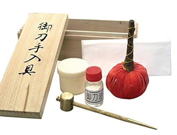

Stephen Posted February 16, 2024 Report Posted February 16, 2024 First image is the preferred oil now days. Keep the cloth use the rust remove eraser for your kitchen knife. If you buy choji oil make sure it's not the kind for bonsai tools. It's as thick as motor oil. NO GOOD Second image is the type of ball NOT TO BUY!!! Known to scratch blade. Unless you have a blade out of polish and cloudy it's best to pass on using the powder ball. If you have to have the best get Bob Bensons. YouTube is a minefield of good intent but bad info. Be careful. 3 Quote
