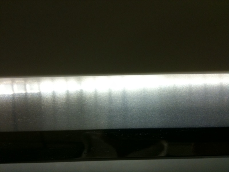

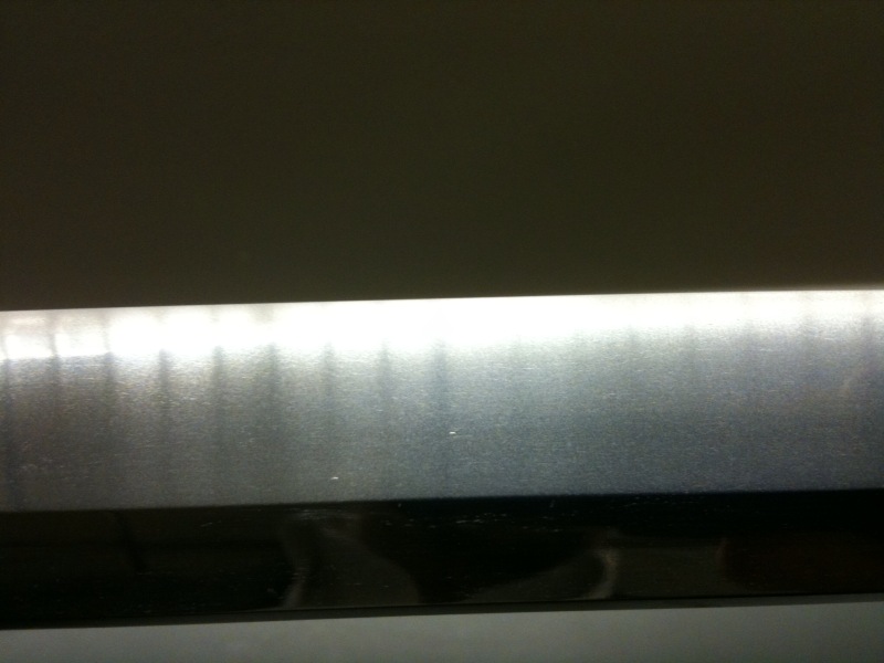

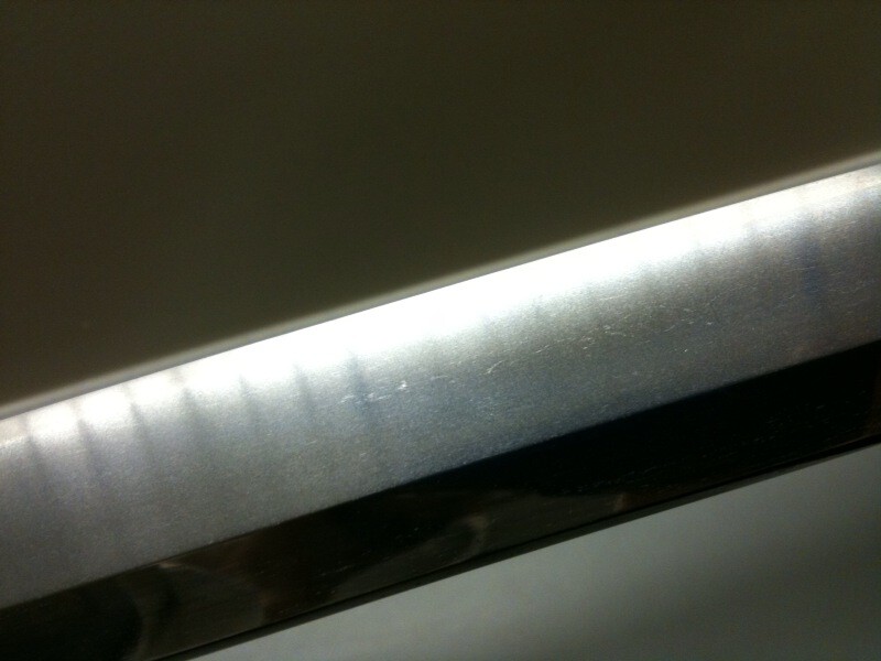

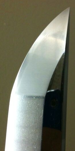

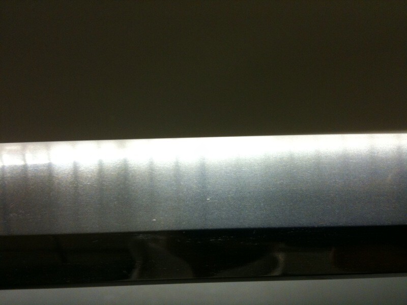

Ray Singer Posted November 5, 2009 Author Report Posted November 5, 2009 Thanks Ted, I really see what you mean. There is a different feeling of nagareru in places. I always have a hard time evaluating steel color, I am sure it would be much clearer when compared against another sword to see if there is more of a whiteness in the steel. It is also interesting to look at the boshi in this tachi. While the sword overall does not have nijuba, there is a strand of nie floating above the boshi which is crisp and bright like a line of kinsuji which has floated above the hamon. This is only visible on one side. As far at the nie activities in the ji, they seem independent of the kitae. The nie utsuri does not follow along with the pattern of forging, but rises and falls like a midare utsuri. I really need to scan the photo from the Juyo Nado Zufu, which shows this well (or if someone had volume 49 handy, they should be able to see this piece). I have a tanto which also had this same dual attribution. It was originally papered by Kotoken Kajihara to Rai Kunitoshi in older polish. The sword was evaluated at the NBTHK, who said it was a high quality Yamashiro sword and should go Juyo to a Rai smith. After polish the sword received Tokubetsu Hozon to Enju (and will not paper higher). I can see easily in this sword why the attribution went to Enju. There is full length nijuba on each side, very similar to the Awataguchi Kuniyoshi tanto in the beginning Rai show catalog. Other Enju I have seen are very similar. The hada is more itame nagare compared with the tachi, but I think this is due to the steel being less healthy by comparison.. Quote

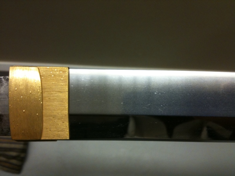

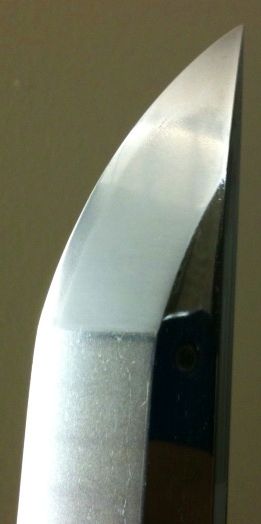

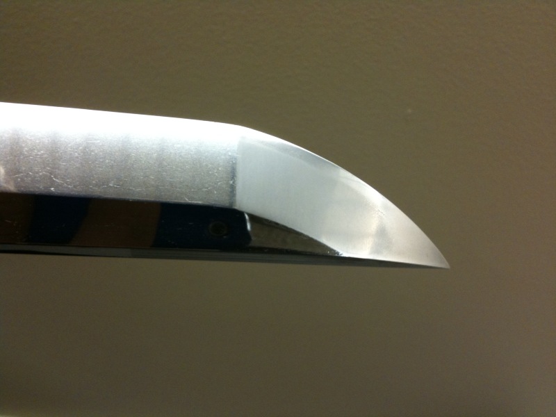

Ray Singer Posted November 5, 2009 Author Report Posted November 5, 2009 Hi Paul, these are not great photos. I am relying on the camera in my iPhone this week. Hopefully these images will give a sense of the workmanship in this tachi. Thanks for sharing your Enju, do you see any areas which look like nie utsuri in this piece? Quote

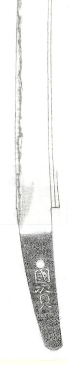

Ray Singer Posted November 5, 2009 Author Report Posted November 5, 2009 Since we are discussing Enju, I have loved this sword for a while. The hamon is thin in places, but still it is a signed Kunisuke and retains much of its original shape. It also has utsuri visible throughout, which can be seen in the oshigata. http://www.tsuruginoya.com/mn1_3/a00120.html Quote

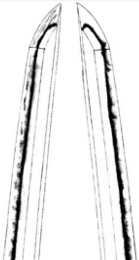

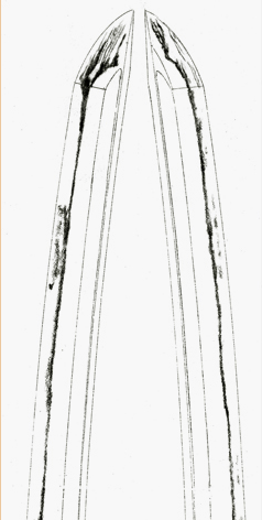

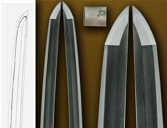

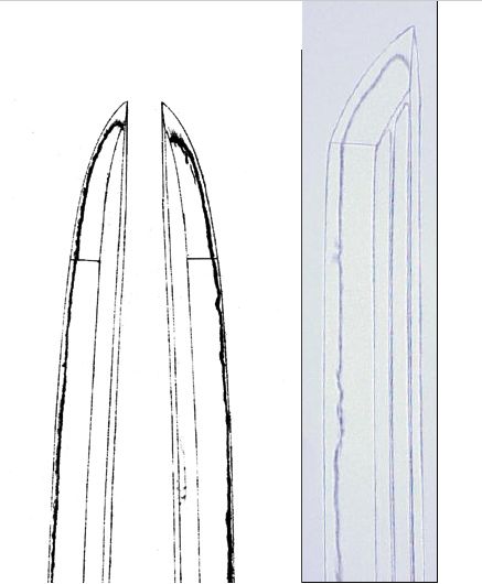

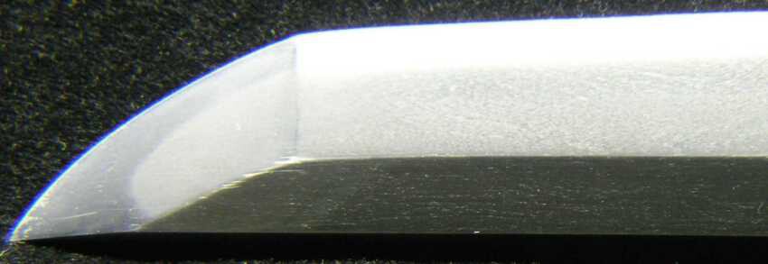

Eric H Posted November 7, 2009 Report Posted November 7, 2009 As the boshi, ko-maru or o-maru, seems to be a crucial point for correct attribution to either Rai Kunitoshi or Enju...here some pics for consideration. The last two oshigata depict the same Enju Juyo pic 3. Eric Quote
Ray Singer Posted November 7, 2009 Author Report Posted November 7, 2009 Hi Eric, thanks for posting the additional Enju examples. I wish that the NBTHK would offer pages from the Juyo Token Nado Zufu rebound according to school/tradition, so one could compare all those great reference examples at a glance. I suppose if someone had the entire series they could do so on their own. The Rai Kunitoshi is a really interesting sword... isn't that is the ju-to ko-dachi sold on Aoi-Art? If so, I remember that the sword no longer had a yokote when it was listed for sale. I wonder if it would still have been attributed to Rai Kunitoshi if it were unsigned. A slender shobu-zukuri blade of ko-wakizashi length is very unusual for the time period. They have one more listed on their site now with a more typical ko-maru boshi. http://www.aoi-art.com/sword/wakizashi/08701.html Quote
Ray Singer Posted November 7, 2009 Author Report Posted November 7, 2009 Quote The only way I can describe how to examine some of these features collectively yet also independently is like looking at the bottom of a shallow crystal clear lake with small leaves or dust on the surface. You can seen the textures on the bottom by looking through the top, and the surface against the bottom. Perhaps this is a bit poetic, and definately lacks an accurate scientific explaination, but it’s the best way I can describe how I try to approach it. I remember Jim Kurrasch expressing this sentiment in a similar way with regards to a Rai Kunimitsu tanto he owned. Superficially, the jigane showed a extremely thick layer of ji-nie which took on a greater density towards the mune forming nie-utsuri. He was able look though this and see a secondary layer of activities within, with a pattern formed by many small chikei throughout the sword... Quote
Eric H Posted November 8, 2009 Report Posted November 8, 2009 raymondsinger said: The Rai Kunitoshi is a really interesting sword... isn't that is the ju-to ko-dachi sold on Aoi-Art? Hi Raymond, In fact that Kodachi in rare shape was sold by Aoi. Interestingly the link to the Kunitoshi Wakizashi depict a boshi lacking the "ko-maru". Additionally another oshigata of a attributed Enju. Eric Quote
Eric H Posted November 8, 2009 Report Posted November 8, 2009 just for fun: Kunitoshi or Enju ? Eric Quote
Ted Tenold Posted November 8, 2009 Report Posted November 8, 2009 Eric, Ko-Mihara!!! Just kidding... I'd call it Enjyu. Why? Reveal hidden contents The strength and size of the chikei in the ji. Anyone else wanna take a chance? Quote
Toryu2020 Posted November 9, 2009 Report Posted November 9, 2009 I'll take a stab at it! Reveal hidden contents Kunitoshi on the left - Enju on the right Kunitoshis' boshi is set low Kunimitsu has a slightly pointed boshi not unlike the one on the right But his boshi is set low as well so I see the one on the right as Enju Hoping this spoiler thing is workin... -tom Quote
