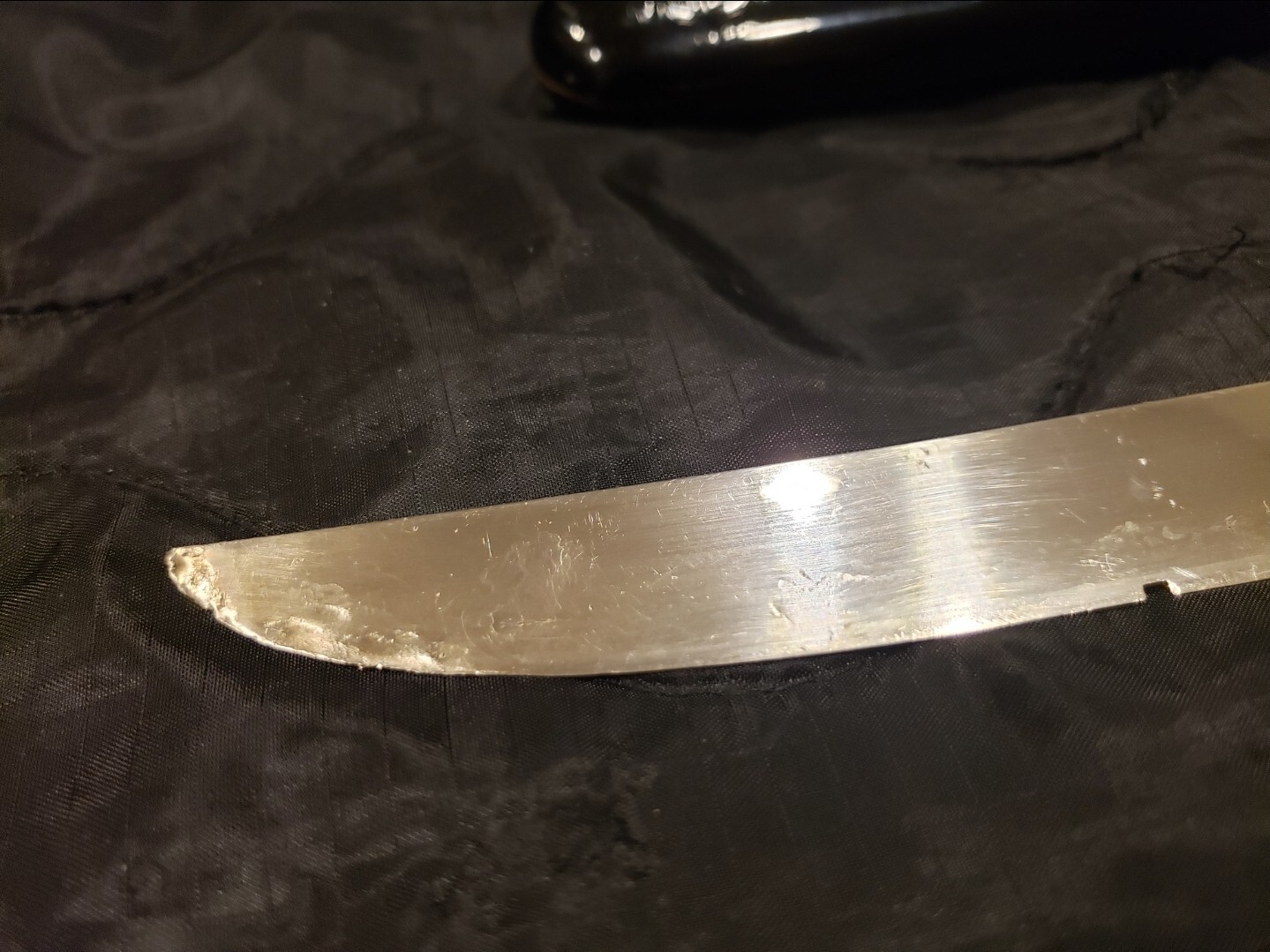

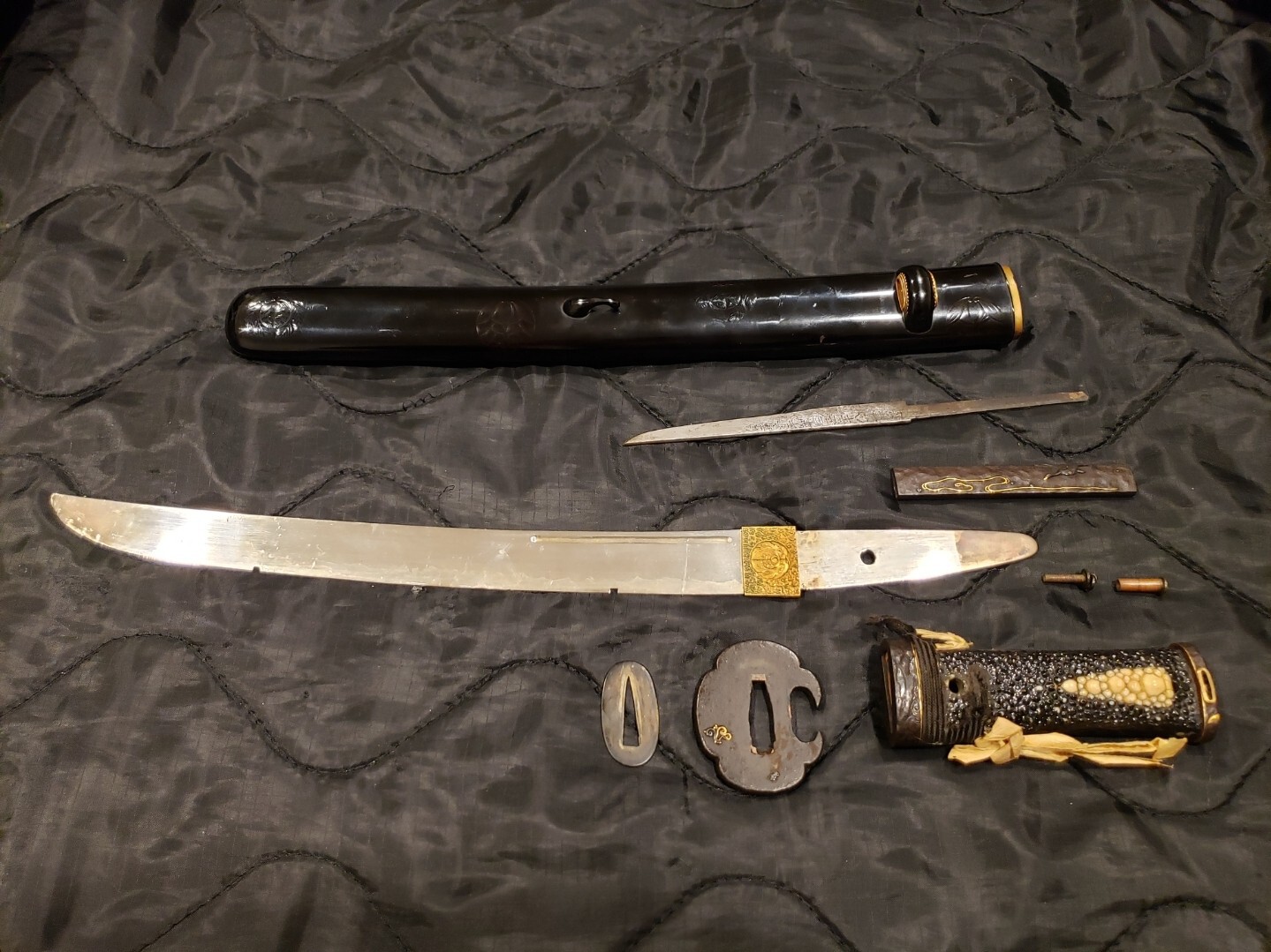

Onigoroshi Posted February 9, 2024 Report Posted February 9, 2024 I have a very interesting wakizashi and only one person I showed it to in nearly 30 years of owning it seemed to know what it may be. It is a solid silver unsigned 39.5cm blade with elaborate fittings. I tested the blade with the ice test, the bleach test, and used a neodymium magnet for the slide test. The magnet slid down the blade at a slow speed when held at a 45 degree angle. Two notches are cut into the ha of the blade, and I'm unsure why. There is also a hamon visible. Seven Myoga kamon are all over the saya and also appear on both sides of the habaki. Some of the kamon on the saya appear maroonish red under the correct light, and some appear a dark blue. The habaki may be solid gold as it is quite heavy. The menuki appears to be copper and is threaded with a small ring on the male end. The kozuka is signed on both the blade and handle and the handle is decorated with a duck and gold decorations on one side and engraved with bamboo and what appears to be a silver disk (possibly a moon?) The tsuba appears to be iron with gold decorations. The fuchi and kashira are iron decorated with gold. The kashira also has what looks like a gold sun, and the fuchi has what appears to be a moon with a strange bluish type metal I can't identify. The tsuka it may be silk and is deteriorating rapidly. The same is mostly painted black. I would like to know if anyone can translate the writing and\ or tell me exactly what I may have. Thank you! Quote
PNSSHOGUN Posted February 9, 2024 Report Posted February 9, 2024 Looks like a metal Tsunagi to keep the fittings together, the notches look like they are meant for a display stand. 1 Quote
Onigoroshi Posted February 9, 2024 Author Report Posted February 9, 2024 11 minutes ago, PNSSHOGUN said: Looks like a metal Tsunagi to keep the fittings together, the notches look like they are meant for a display stand. I thought this as well, but I've only ever seen tsunagi made of wood. Also, would a blade be displayed out of a saya? Quote

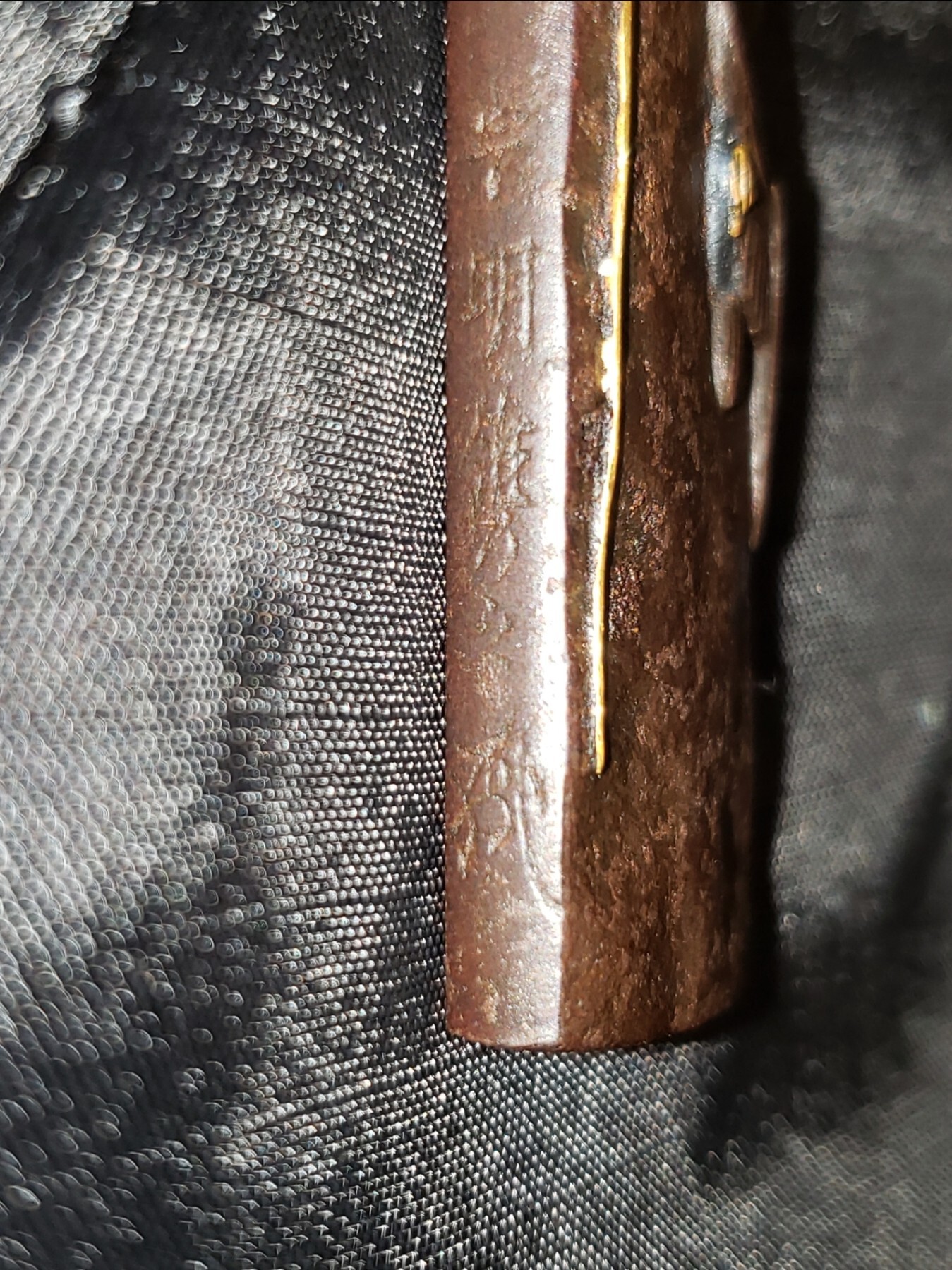

Bugyotsuji Posted February 9, 2024 Report Posted February 9, 2024 伯耆守平朝臣正幸 島津家伝来品 Houki no kami Ason Masayuki from Shimazu Family | 日本刀買取 販売、刀剣古美術の飯田高遠堂 (iidakoendo.com) For the kozuka inscription see the above, and it adds 'made at 81 years old'. 八十一歳造 4 Quote
Onigoroshi Posted February 9, 2024 Author Report Posted February 9, 2024 10 minutes ago, Bugyotsuji said: 伯耆守平朝臣正幸 島津家伝来品 Houki no kami Ason Masayuki from Shimazu Family | 日本刀買取 販売、刀剣古美術の飯田高遠堂 (iidakoendo.com) For the kozuka inscription see the above, and it adds 'made at 81 years old'. 八十一歳造 Thank you so much! Quote
PNSSHOGUN Posted February 9, 2024 Report Posted February 9, 2024 Yes metal Tsunagi are often found, it would appear the Koshirae & Habaki were setup as a display - given the decent quality of everything shown. 3 Quote

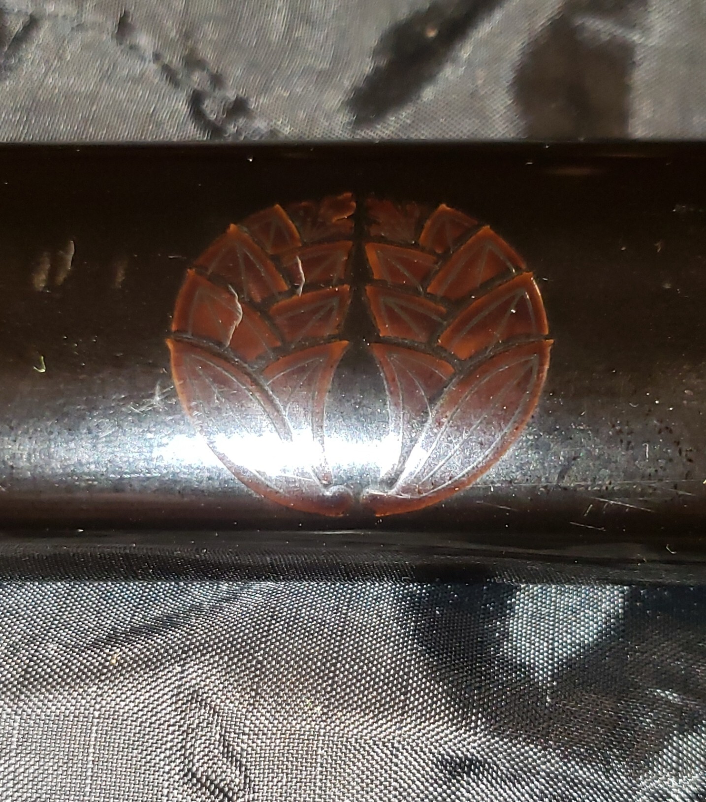

Bruce Pennington Posted February 9, 2024 Report Posted February 9, 2024 What's that on the habaki, Oni? A mon? Quote
Onigoroshi Posted February 9, 2024 Author Report Posted February 9, 2024 8 minutes ago, Bruce Pennington said: What's that on the habaki, Oni? A mon? Yes, it appears to me a myoga ginger kamon. The same appears on the saya along with a wreathed myoga. I can't find any particular family that used the wreathed version or what it may mean. 1 1 Quote

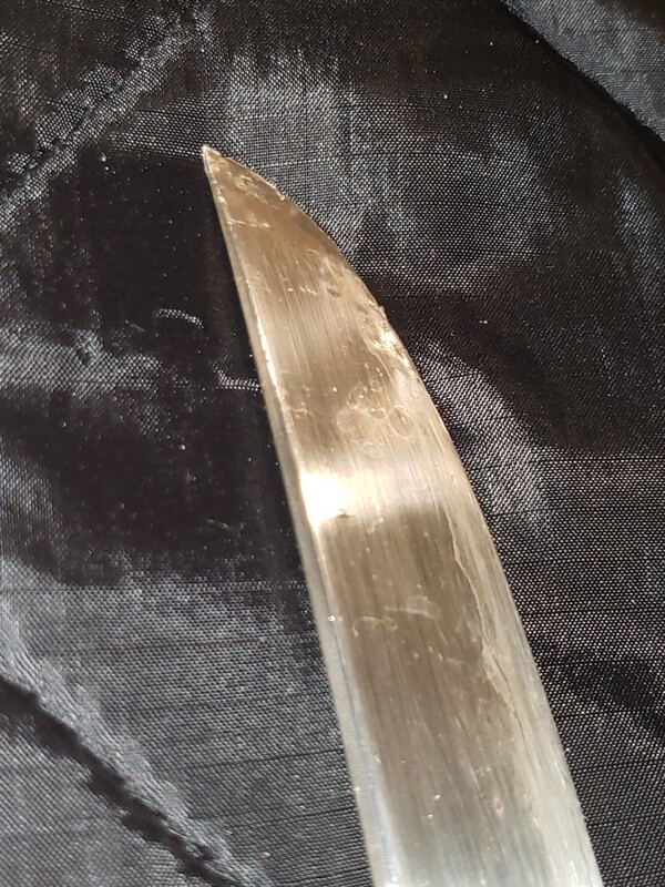

Matsunoki Posted February 9, 2024 Report Posted February 9, 2024 6 hours ago, Onigoroshi said: It is a solid silver unsigned 39.5cm blade Have you actually done the acid test on the blade to confirm it’s silver? It would be very unusual to use silver for a tsunagi. Could be white bronze alloy. Also, not sure if you can actually get a hamon on silver…..can’t see how….nor on bronze for that matter. Is it a polishing effect? Any sign of nie or nioi? The habaki looks superb….but the rest of the koshirae are pretty ordinary. 1 Quote
Onigoroshi Posted February 9, 2024 Author Report Posted February 9, 2024 1 hour ago, Matsunoki said: Have you actually done the acid test on the blade to confirm it’s silver? It would be very unusual to use silver for a tsunagi. Could be white bronze alloy. Also, not sure if you can actually get a hamon on silver…..can’t see how….nor on bronze for that matter. Is it a polishing effect? Any sign of nie or nioi? The habaki looks superb….but the rest of the koshirae are pretty ordinary. I haven't done acid testing because I don't want to cause any more damage to the blade. The other 3 tests as well as visual inspection confirm it is silver. Quote
The Blacksmith Posted February 9, 2024 Report Posted February 9, 2024 It looks to me like the hamon has been acid etched to give the appearance of an actual hamon. 1 1 Quote
Brian Posted February 9, 2024 Report Posted February 9, 2024 Personally, I think there is little to no chance it is silver. But easy enough to have a jeweller test it. Likely some alloy and was used as a filler to keep the parts together. You'd have plenty of silver tarnish if it were silver, and there would be no point in making it solid silver. It's not a real blade, and the hamon is fake. Nice fittings, I can see why someone put some effort into displaying them. 4 Quote
Matsunoki Posted February 9, 2024 Report Posted February 9, 2024 1 hour ago, Onigoroshi said: I haven't done acid testing because I don't want to cause any more damage to the blade. The other 3 tests as well as visual inspection confirm it is silver. The acid test involves a tiny spot, you could do it on the “nakago” end. It won’t damage it. The magnet test does not prove it’s silver. Nor does any ice test. Nor does any bleach test. The hamon isn’t a real hamon and the nakago looks totally wrong. 1 Quote

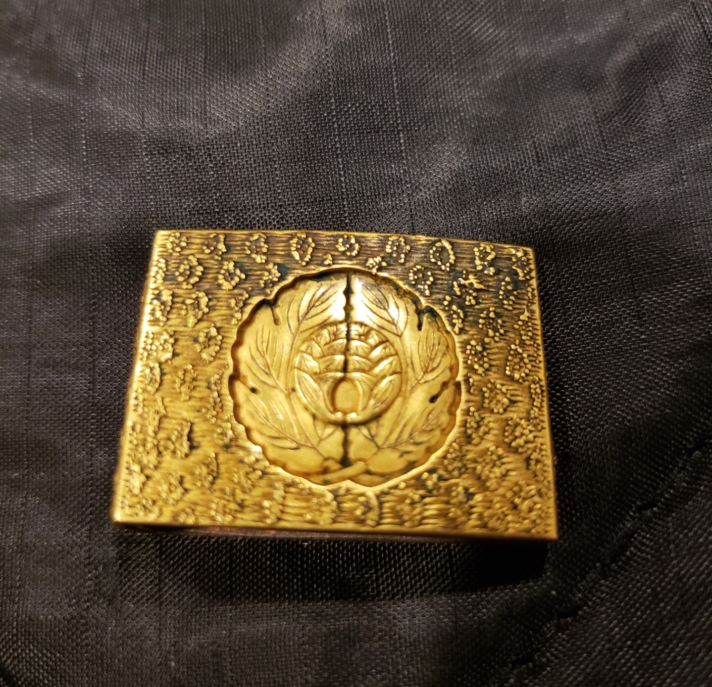

Bruce Pennington Posted February 9, 2024 Report Posted February 9, 2024 Thanks for the photo of the habaki, Oni. Quite beautiful. 1 Quote

Matsunoki Posted February 10, 2024 Report Posted February 10, 2024 So, you’re happy to dip the nakago in bleach but not to put a minute spot of silver testing fluid on it which would tell you for sure whether it’s silver and leave no discernible trace especially if done on the nakago mune? Believe me what you have there is already so damaged that it will make no difference to it’s value (or rather lack thereof….unless it is silver in which case it’s bullion value) The “blade” is not an “interesting wakizashi”, even if it was once a genuine Nihonto (which I doubt) it is now ruined….. covered in abrasions with two large notches cut into it. However the nakago shape does not remotely look Japanese and it looks like someone has either made or adapted it to display the extremely fine looking habaki. The hamon on it is fake. Metalugically you cannot create a hamon on silver anyway. The use of kamon on the saya is nothing exceptional and does not per se indicate quality. In late Edo and into Meiji the use of random Kamon on saya and other items became very common and cannot be reliably used to identify the actual owner. Many were made to sell to the tourists of the day. The remaining koshirae components are nothing at all exceptional. The most interesting thing is that habaki…..have you had that tested? You could take that and the blade to a jeweller (as Brian suggested) and have him run it past his XRF Analyser. That’s noninvasive and you could proudly show us the results. You seem loath to accept that as solid advice but instead rely on totally unreliable tests to reach your conclusions. As for boasting about the perceived value of your guns and how expert you are in looking after them…….we don’t usually do that on here. It’s vulgar. 5 1 Quote

Brian Posted February 10, 2024 Report Posted February 10, 2024 Easy enough for any jeweller to do a rub and acid test. Will take seconds and tell you exactly what you need to know. And the rub is pretty much unnoticeable. Of course if it's silver, then it has value for the metal alone. Still not going to add value to it as a Japanese sword, as it's not anything traditional or made by a smith. I'd say this has separate value to the blade and the koshirae, "silver" blades are nothing known or associated with Japanese swords. 3 Quote
Franco Posted February 10, 2024 Report Posted February 10, 2024 Thoughts: Solid silver? Highly doubtful. Precious metals were/are precious and not used wastefully and splurged on a tsunagi. Silver plated, possibly, "if", then something probably done in more recent times. Saya/koshirae, if memory serves, perhaps, an Owari style koshirae. You can check/confirm with Sesko's Koshirae Taikan. Ko-gatana, the mei looks possibly valid. Needs further research. Kozuka, is it iron?, needs further evaluation. Can anyone read the kanji on it? Habaki, yes, the habaki looks wonderful. Could we see images of the ends and inside? Close up pics of the fuchi/kashira? Basically, this is a koshirae someone thought well enough of for preserving. If mine, I would try to discuss and learn more about it with an expert like Brian Tschernega. Ask if he thought it was worth having him do restoration work. Regards, 1 1 Quote
French nihonto Posted February 10, 2024 Report Posted February 10, 2024 I really doubt it's silver. The simplest test would be to weigh it. Quite simply, silver has a much higher density than steel, aluminium, and so on. Weigh the blade, and you'll see straight away if it's silver or not. 1 Quote
Matsunoki Posted February 10, 2024 Report Posted February 10, 2024 37 minutes ago, French nihonto said: Weigh the blade, and you'll see straight away if it's silver or not. Maxime, I’d be interested to know how that works. Ok the blade is weighed and let’s it’s say 1kg. How does that tell us it’s silver? Quote
Brian Posted February 10, 2024 Report Posted February 10, 2024 You have to check the volume vs weight. Water displacement or other method. Not easy. 1 Quote
French nihonto Posted February 10, 2024 Report Posted February 10, 2024 Compare this with a tanto tradionel, which is about the same size. If it's silver, the difference will be significant. 1 Quote
