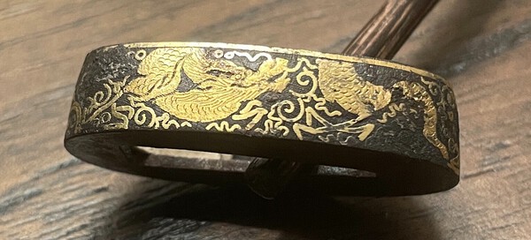

I was wondering if anyone can produce photo examples of matching nunome work fittings by the Kenjō / Kyo-Kenjō artists. I'm mostly referring to the flat / hira inlay type seen here under Kenjo work - http://jameelcentre....ection/7/10237/10370 rather than the heavier more deeply inlayed work like Komai's dragons and clouds.
I am particularly looking for examples of F/K, kozuka and kogai or complete fittings which match the style of the images below, theres also a kurigata and kojiri but not pictured. I wonder if it is possible to pinpoint a school or some schools who did this kind of work, rather than the general 'Kyo-Kenjō' attribution.
None of the tsuba I can find in this style are signed, and I can find no other examples of similar F/K, kozuka, kokgai, kurigata, kojiiri etc online. I expect that far more tsuba were made in these shops than any other kind of sword fitting. The smoking samurai website is marvellous but so far I cant find a match.

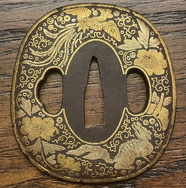

2 hours ago, Bugyotsuji said:
Looks kind of űber Higo Zōgan-ish, with mythical creatures, Ryū, Hō-Ō and Kirin.
I was wondering what that creature was... I thought it could be a fox as in the above example posted by Dale. Good to know. There's a similar one to the above on ebay with the double wire thread vines and phoenix. I have yet to find any other fittings aside from tsuba in this style...

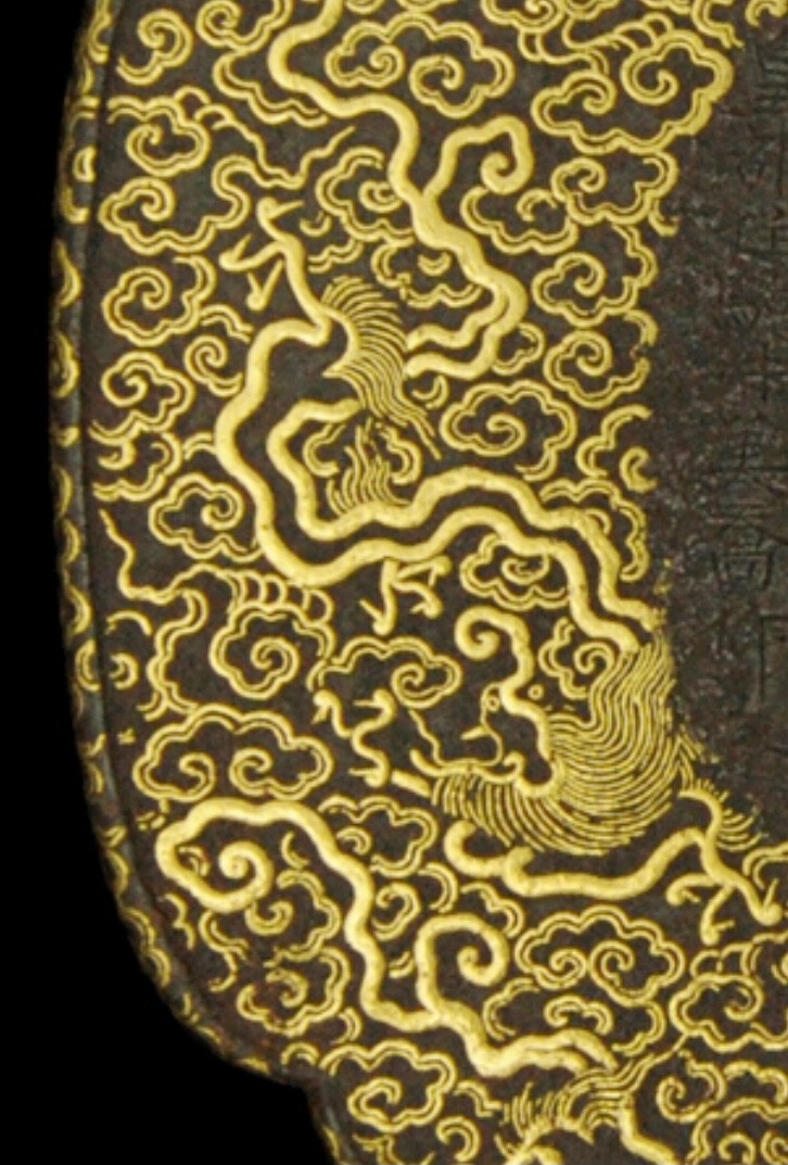

Komai work is not inlaid. It is done in nunome zogan ie gold/silver foil pressed onto a finely cross hatched base. To my eye none of the images above feature true inlay. All looks nunome.
Nunome Zogan means cloth weave overlay and uses very thin foils - 0.02mm thick and the gold is attached to the base metal by creating a cross-hatched ground made with chisels. Around 7 - 9 chisel marks per mm created in three different directions at 45 degrees to each other”

Are you thinking of later Komai work? I I was referring in particular to this style below which is made by Komai and surely includes inlay.
Agree, except for the double vines which I believe could be inlayed but am not sure.
Hi Alex, no I’m not thinking of just later Komai work, I was just looking at the images. You would need powerful magnification to look at the iron surface to see if you could spot the incredibly fine cross hatching that is used to bond the gold/silver. My money is on nunome🙂

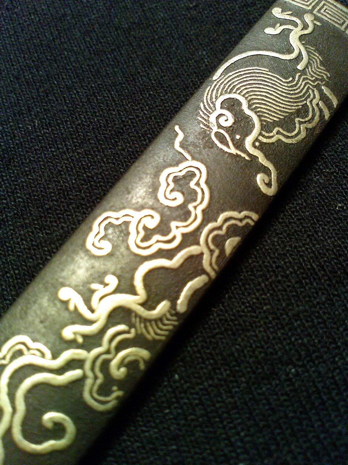

How about the Kao? Is that inlay or nunome as well?
Hi Dale
100% the Kao is just nunome. Under strong magnification you can see the cross hatching peeking out from around the gold. The whole area of the Kao has been hatched and the Kao simply applied onto it. Many people don’t believe that this thickness of gold which looks very “solid” is actually heavy nunome…..but it is.
Tap the image …..hopefully you can see it.

Have a look at the closeup above of the Kao on the tsuba I posted. Nunome can be used to create a such a thick effect.
That’s a great closeup and lovely kao. I commented earlier that I think all the work on your tsuba appears to be nunome. I think I haven't been clear enough so I’ll include some additional closeups below. Here is a kozuka with the same theme:

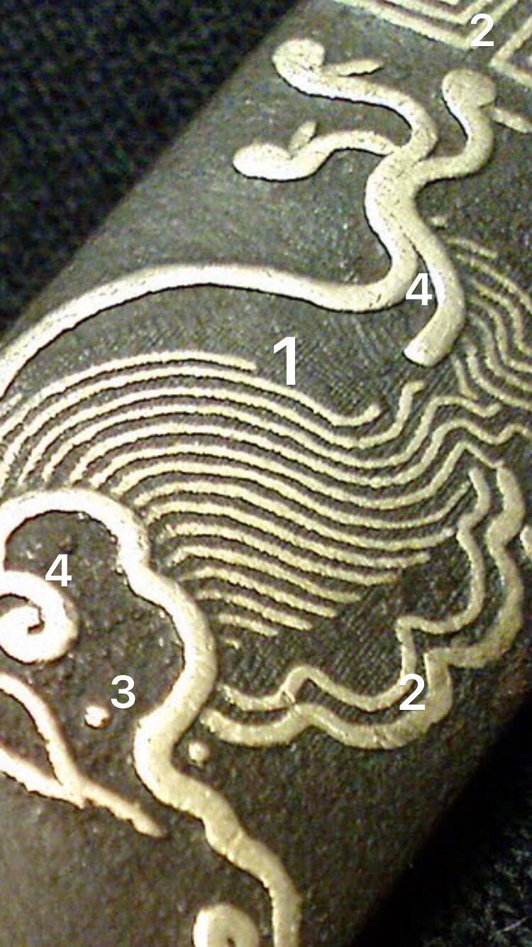

If we take a closer look we can see four sizes/gradients of gold used to create the design. I number them from smallest to largest to illustrate:
It was always my belief that 1 and 2 are nunome while 3 is punched and inlayed, and 4 is channel carved and inlayed.
You will notice that the nunome crosshatching which is quite visible under macro does not extend into those areas with the thicker gold “lines”. It was of my understanding that they don’t need to, because those parts are inlayed. I am open to the idea that I am completely misunderstanding the manufacturing process however…
Good observation, I can see what you mean. I guess they used both techniques. Honestly…..I’ve never looked as closely as this before🙂 Do you think it possible that on these thicker strands of gold there is a “hump” of iron underneath and it’s still nunome over that? I’d love to see an area where a bit has come off or out! If it is narrow inlay it’s amazing that we don’t see bits that have fallen out especially on heavy handling objects like tsuba and Kozuka.
I mean to say I think the “fox” on the first tsuba actually looks closer to how the Japanese depict their wolves. Search for “wolf netsuke” and you’ll see why I think so. Japan had 2 species of wolves until the early 20thC .

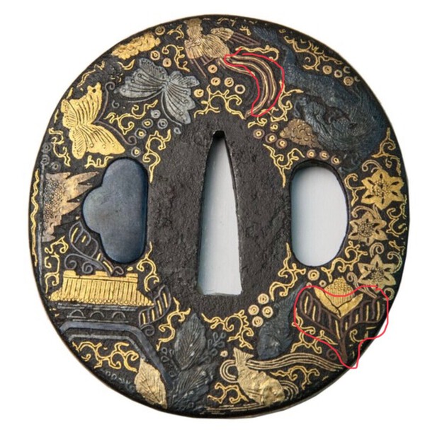

Also compare the area outlined in red to that outlined in green. Would you argue the green area has also lost its nunome from what appears to be the same technique but in a silver “inlay” that to my mind also looks like it never had nunome on it? It looks like the artist used the same technique and design within both the red and green highlights….ie thins lines in a different material that never had nunome in them. There is absolutely no trace of residual gold overlay.
Your theory of oxidisation followed by cleaning makes no sense to me.
The areas marked in the green and red cicles above I believe are/were not silver or shakudo or copper colour when the tsuba was produced but gold. Unfortunately black oxidation has taken over what was once a 'gold' colour of a different hue to what remains yellow now. I think only the umigane has always been shakudo...not 100 percent on that though. When I say I think it's been cleaned I say that in a relatively loose sense. There's still plenty of oxidation remaining, the dragon, the fish, the leaves etc. likely should all be gold.
Seriously…dragons, butterfly etc ..all gold originally?
So one fish is perfect gold, the one right next to it has lost 100% of the gold?
The dragon and butterfly have very precisely lost 100% of their gold yet surrounding details escape unscathed.
To me those areas look exactly like old silver nunome that has simply tarnished. (The use of mixed silver and gold nunome on tsuba is not that unusual is it?)
Gold itself as we know does not tarnish so what technique/material (base and overlay)  are you suggesting was used to create the dragon, butterfly etc that facilitated such precise discolouring leaving no trace of the gold?
