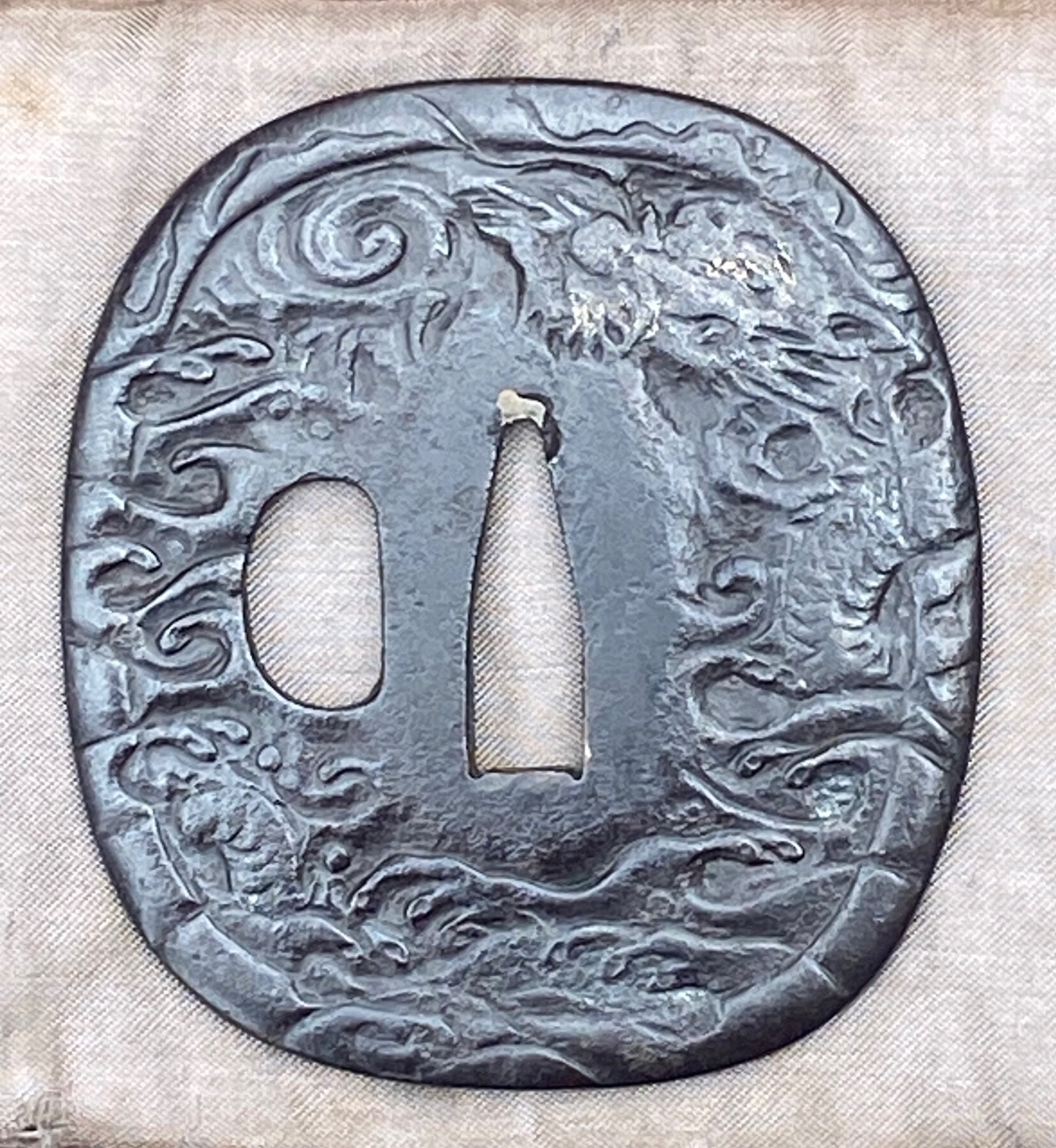

JohnTo Posted February 7, 2024 Report Posted February 7, 2024 February 10th is the start of the Chinese Year of the Dragon. I’m sure many of you have fittings with dragons, so let me get the ball rolling with start with two tsuba of mine. Perhaps, as it is the Chinese New Year, I should post some Nanban Chinese dragons, but I thought I would post these two as they seem to have nice smiley faces and do not look particularly fearsome; a good New Year omen. I have attributed both of these tsuba to the 19thC Mito School based upon the observations that the artists tended to make large iron plate tsuba with a hammered surface and raised areas of iron which they carved in detail and left their work unsigned. The surface of both tsuba is a glassy chocolate brown, which why I think they are 19thC rather than earlier. Other schools which I think could be candidates for the makers are the Myochin and the Natsuo workshops. The first tsuba is a large (9.6 x 8.7 cm) rectangular plate tsuba showing a dragon among clouds and wrapped around a diamond shape (clan mon?) in the centre. Most of the design is formed by hammering the iron around the proposed design element to form an indentation and then carving the centre. However, the iron forming the dragons head has been raised above the plate before carving. The tsuba is highlighted in parts by a light application of gold, called kakihage (shadow), giving a more subtle effect than nunome inlay. The second dragon tsuba is also a large (8.4 x 7.8 cm) iron plate, which has been roughly hammered into shape and shows many lumps and bumps, which I hope that I am correctly identifying as tekkotsu, rather than being fooled by irregularities made to look like tekkotsu (clever these artisans!). The areas containing the clouds and dragon look like they have been indented into the plate using a pre-shaped stamp, but I think that it is actually skilful forging. The dragon has a welcoming, rather than fearsome, look and the eyes are gilt to impart some life into the critter. Although the dragon is a typical three clawed Japanese variety it also has three tails, namely a long curly one, another about half the length ending with what looks like a brush used for calligraphy and a short tail, again looking like a calligraphy brush. No idea why. Comments and further information welcome Best regards for the (Chinese) New Year, Regards, John (just a guy making observations, asking questions, trying to learn) 8 1 Quote

Winchester Posted February 7, 2024 Report Posted February 7, 2024 Hi John, On the first tsuba, it almost appears that the eyes are not gilt; rather, that they are brass. Probably just my interpretation of the photo. Very cool and thanks for sharing! Quote

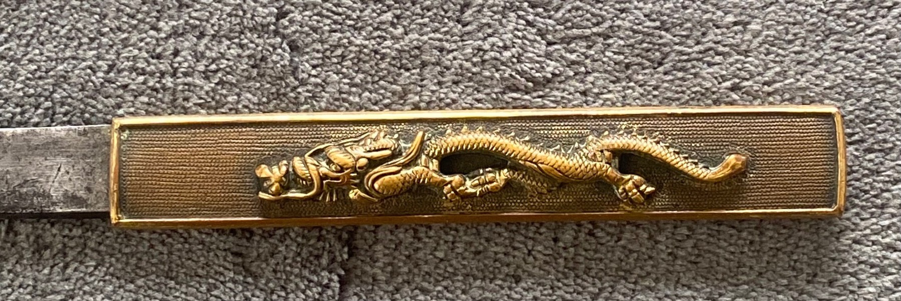

Spartancrest Posted February 7, 2024 Report Posted February 7, 2024 Rain dragon fuchi and a menuki. 4 Quote
Tcat Posted February 7, 2024 Report Posted February 7, 2024 Great menuki Dale never seen one like it...what school would it be? Quote
Spartancrest Posted February 8, 2024 Report Posted February 8, 2024 On 2/7/2024 at 11:19 PM, Tcat said: what school would it be? Expand IDHACAA - [I don't have a clue at all. ] An even more intriguing one. I wish someone had kept the mates to both of them. Single menuki only give you half the answers. And lets not forget the rain dragon tsuba [115 examples on record and counting] 6 1 Quote

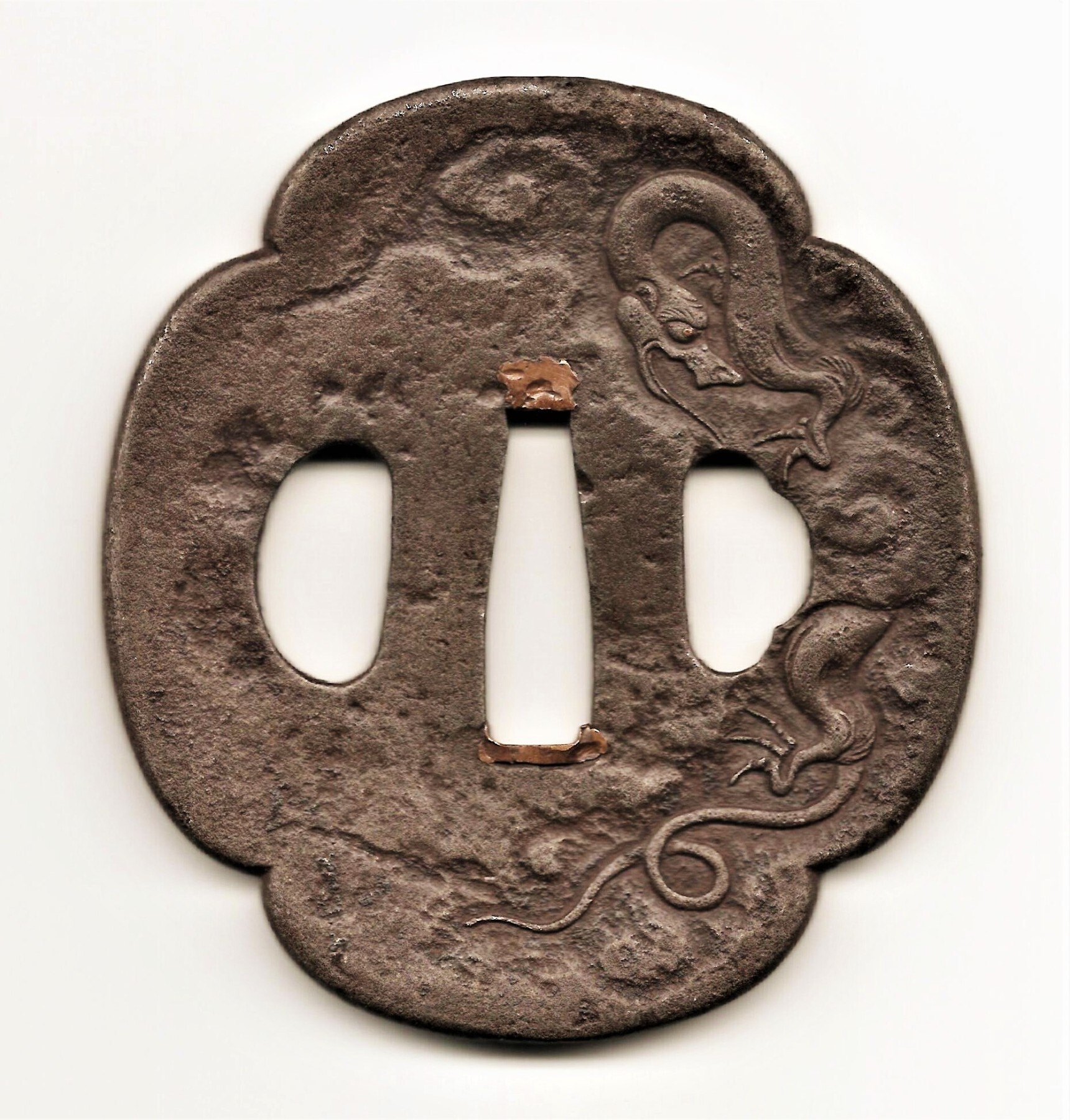

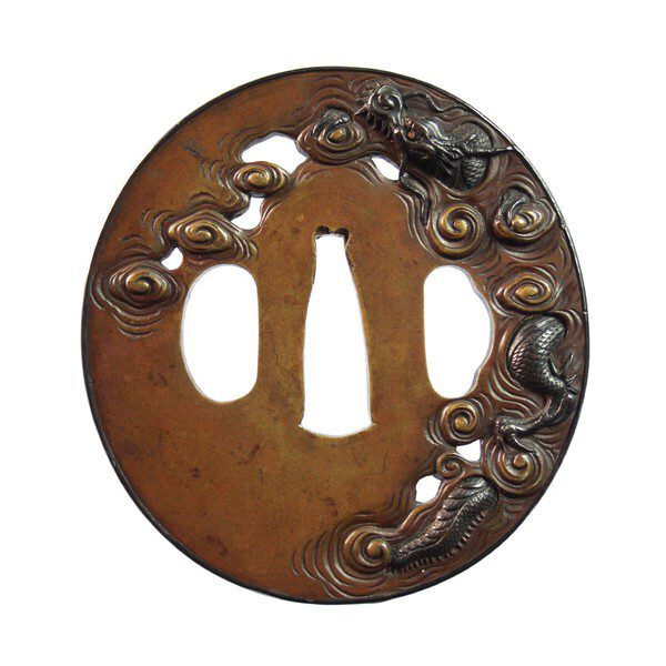

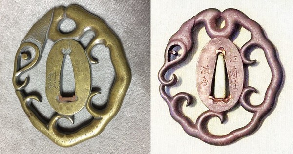

Spartancrest Posted February 8, 2024 Report Posted February 8, 2024 (edited) On 2/7/2024 at 7:07 PM, Tcat said: Good luck to all in the year of the dragon. Expand I wonder if this tsuba is related to the pieces shown by Alex? https://www.willishe...2014/lot-51-tsuba-2/ Edited February 9, 2024 by Spartancrest better image 5 Quote
Tcat Posted February 8, 2024 Report Posted February 8, 2024 On 2/8/2024 at 2:39 AM, Spartancrest said: I wonder if this tsuba is related to the pieces shown by Alex? https://www.willishe...2014/lot-51-tsuba-2/ Expand I have been trying to get hold of one of these with this motif...there are a few out there. Theres one on yahoo Japan now but with sakura motif. A collector in the US has one but its out of my reach. Here's a matching set for the kozuka... 5 1 Quote

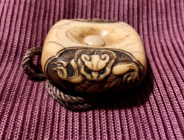

Bugyotsuji Posted February 14, 2024 Report Posted February 14, 2024 Fascinating stuff, John. Thank you. And nice tsuba examples. Without going too far off-topic, I hope, here is a somewhat similar one which I may have posted over on the long Namban thread last year. (Photo should follow...) Also I have a Netsuké with a similar (puzzling to me, Shikami? Enma Dai Ō?) demon mask. Netsuké 3 Quote
