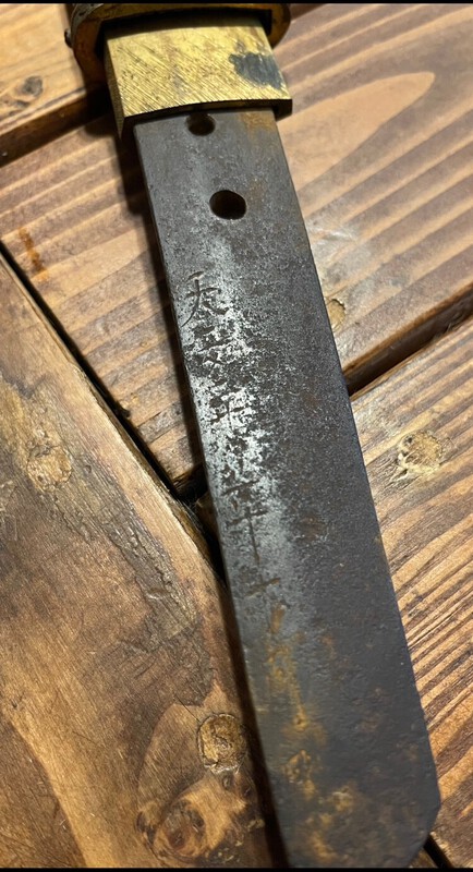

Stockfball11 Posted February 5, 2024 Report Posted February 5, 2024 Looking to get any and all info about this sword that was given to me by my grandfather. Please let me know if any further photos are needed. I tried to be as thorough as possible and provide as much detail as possible. Thank you! 3 1 Quote
Ray Singer Posted February 5, 2024 Report Posted February 5, 2024 From what I can see: Mei: Bishu Osafune Sukesada saku Dated: Tenbun ni ju nen ju gatsu hi Made by Sukesada in Osafune village Bizen province. A day in the 10th month of 1551. 9 1 Quote
Stockfball11 Posted February 5, 2024 Author Report Posted February 5, 2024 On 2/5/2024 at 2:06 AM, Ray Singer said: From what I can see: Mei: Bishu Osafune Sukesada saku Dated: Tenbun ni ju nen ju gatsu hi Expand Awesome! Thank you! Received it from my grandfather and know nothing about swords at all. Going to try and find somewhere to take it to have it looked at in person as well I think. Quote

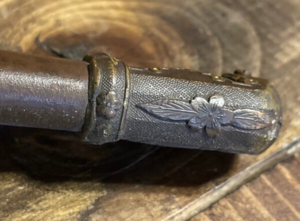

Bruce Pennington Posted February 5, 2024 Report Posted February 5, 2024 The older blade is in WWII Type 98 Japanese officer fittings. You can read about them here: Army commissioned officers Shin-Guntō (Type 98 Guntō) 1938 (ohmura-study.net) The silver, round piece on the end of the handle is a kamon, or family crest. There are guys here who can give you an idea of the list of families known to use this crest. 1 Quote
Ray Singer Posted February 5, 2024 Report Posted February 5, 2024 On 2/5/2024 at 2:08 AM, Stockfball11 said: Awesome! Thank you! Received it from my grandfather and know nothing about swords at all. Going to try and find somewhere to take it to have it looked at in person as well I think. Expand Please also note not to do anything on your own to polish the blade or remove rust, especially on the tang (nakago) which should retain its current dark appearance. Also avoid touching the polished part of the blade with bare fingers, just keep the blade oiled to preserve the condition. This is a very nice piece and is worth submitting for papers at some point in the future. 2 Quote

Bruce Pennington Posted February 5, 2024 Report Posted February 5, 2024 It was fairly common for guys to have their family blades re-fitted for the war. The kamon may be evidence of this in the case of this sword. However there was quite a program by the government and military to get families to donate or sell their old blades for the war effort. The officer in your case could have bought his sword from a shop that had obtained the old blade and fitted it out for the war. Here is an article explaining the program - Converting family swords into Gunto Here is a page on sword care: Japanese SWORD CARE (japaneseswordindex.com) 1 1 Quote
