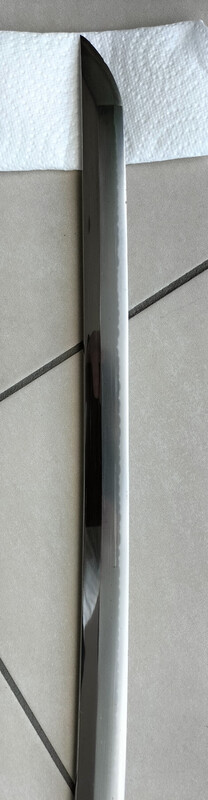

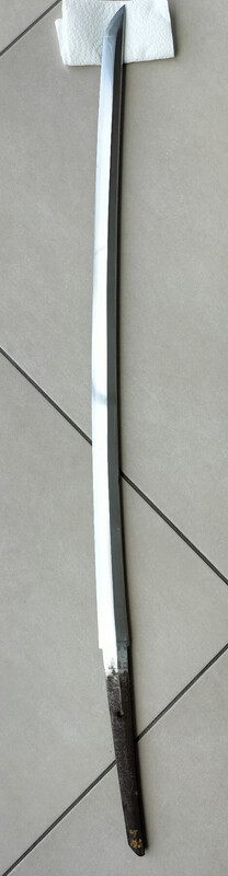

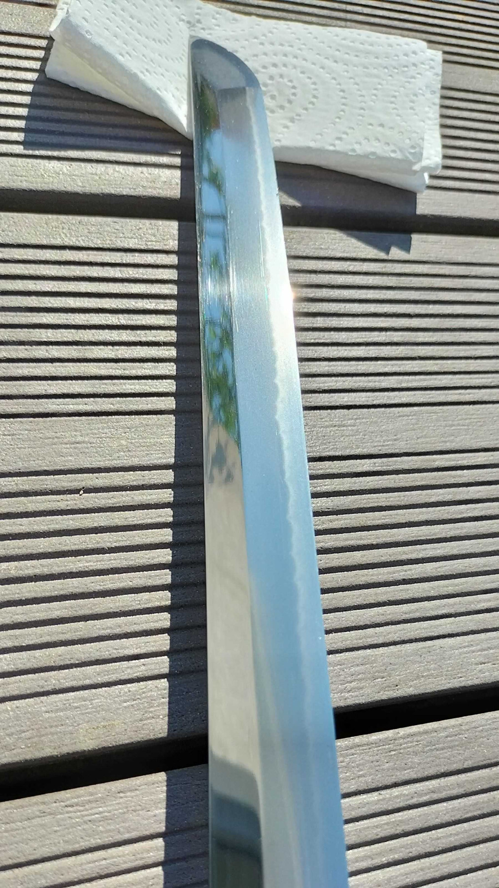

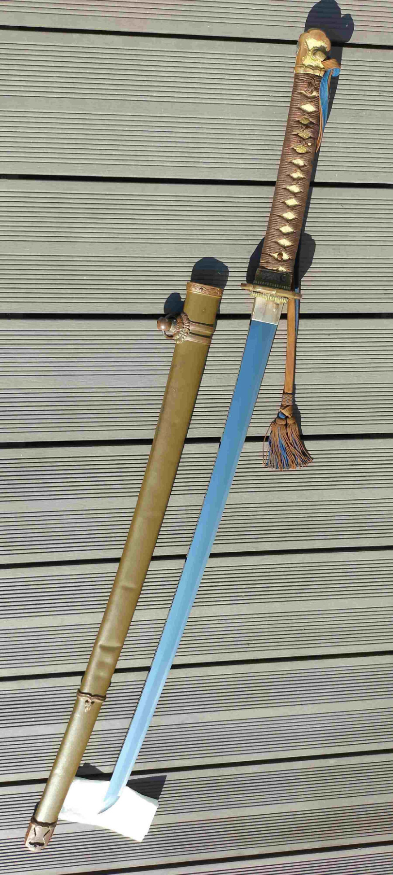

It was the very first time this spring ( ! ) I had the opportunity of taking photos of my Amahide gunto in broad daylight and under the sun. I know the blade is in poor polish and that it is a mere gunto, but still, it is, to my non expert eyes, quite enjoyable.
