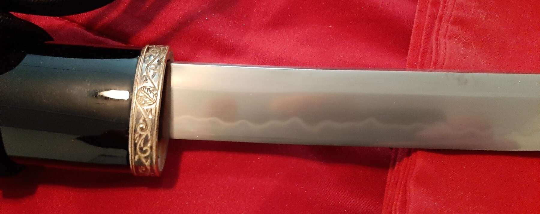

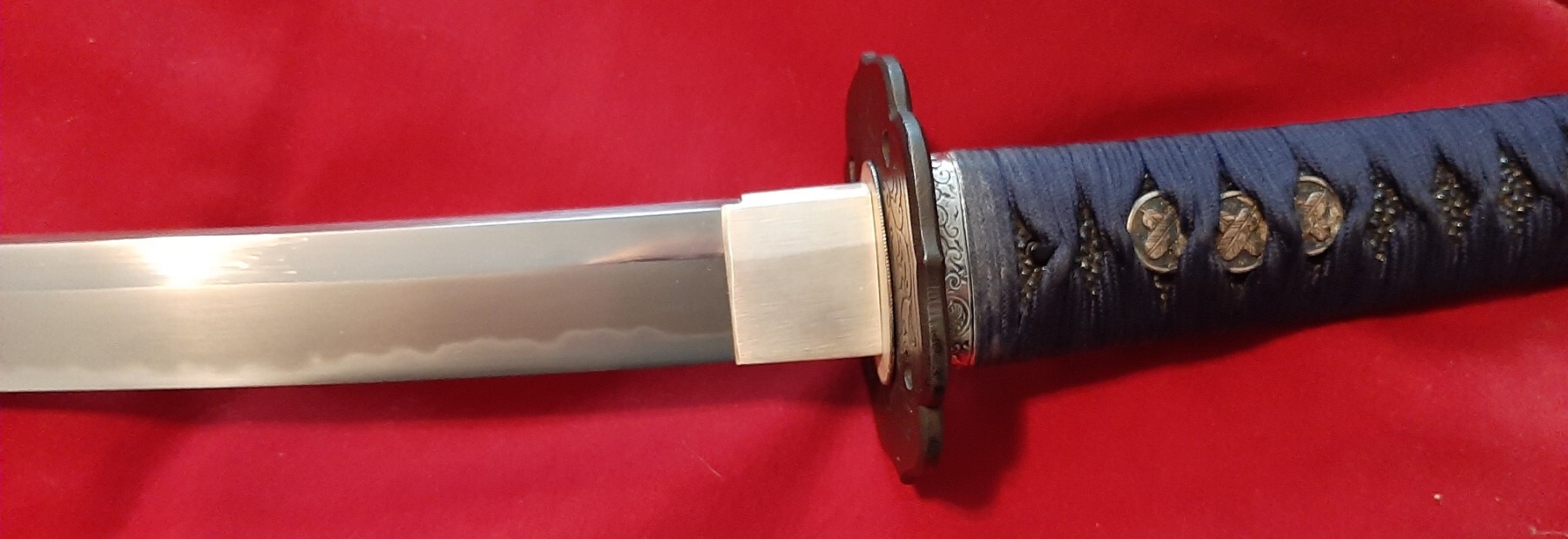

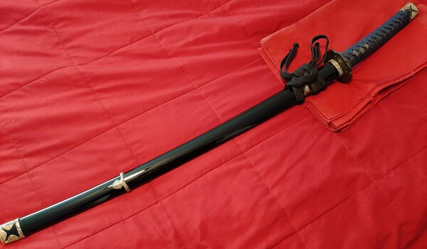

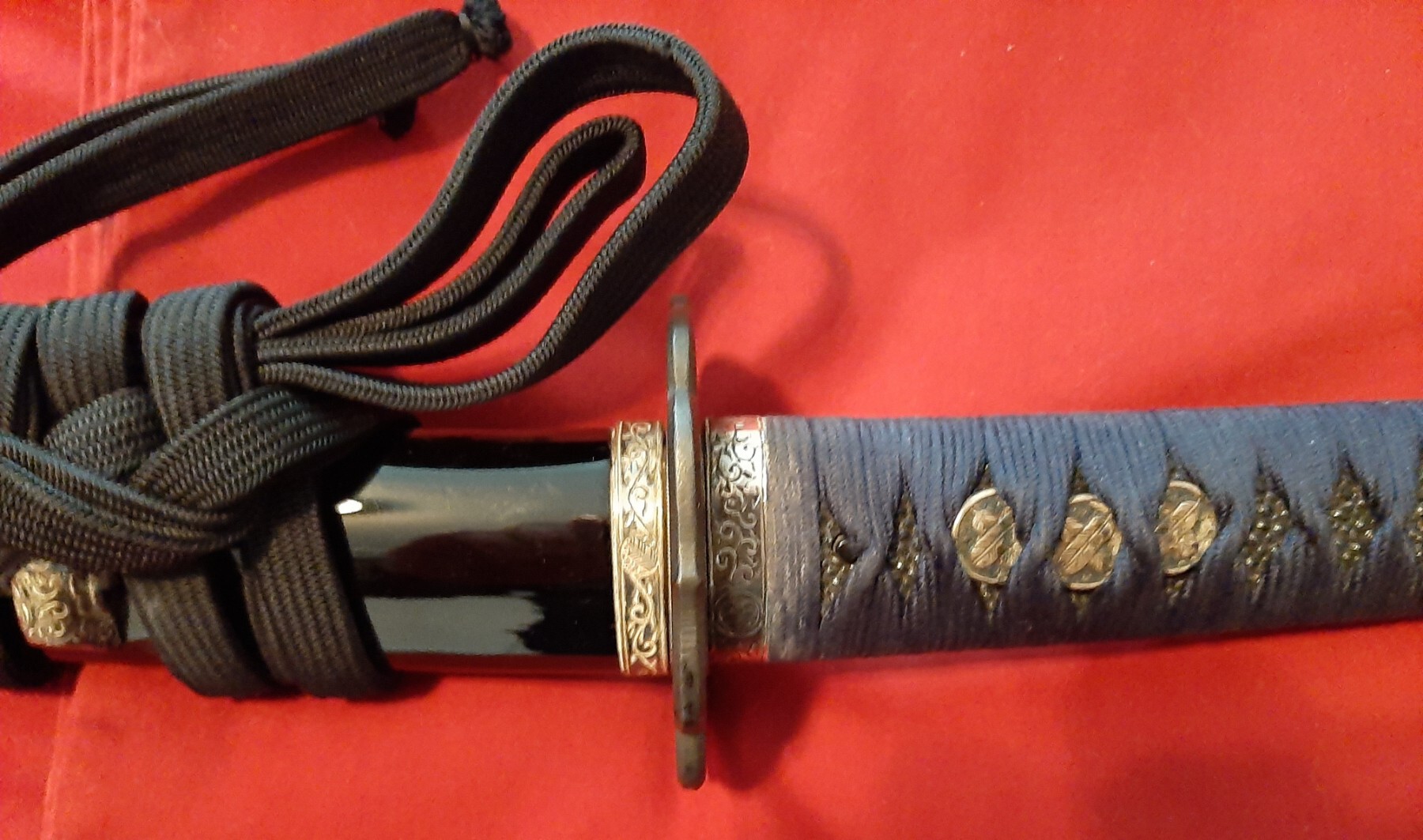

MDWS Posted January 30, 2024 Author Report Posted January 30, 2024 Thanks Stephen. There is a note in the box that says "1936 Blade"... based on the link you gave me perhaps that was the year it was made, I'm guessing. Here are some pics of the sword now. The finishings are all silver but not cared for so slightly tarnished. Ray skin on the handle I'm told, "crossed feather" medallion on handle, and allegedly the scabbard was made of a special wood that resists moisture and scratching. It is beautiful, but I understand if "restoring" it actually decreased its value as I understand that is usually the case with "antiques". Sounds like Nagamitsu is very highly regarded, and so if it is truly a Nagamitsu I am quite pleased. I will research more. Quote

Stephen Posted January 30, 2024 Report Posted January 30, 2024 Link was for checking your mei. There was other Nagamitsu. Hada does look like his just a soso polish Quote

ROKUJURO Posted February 1, 2024 Report Posted February 1, 2024 In my eyes, the SHINOGI has been rounded considerably, so what they call 'polish' seems to have damaged the blade. I hope my impression is wrong! Quote
MDWS Posted February 5, 2024 Author Report Posted February 5, 2024 On 1/31/2024 at 7:42 PM, ROKUJURO said: In my eyes, the SHINOGI has been rounded considerably, so what they call 'polish' seems to have damaged the blade. I hope my impression is wrong! The ridgeline is still quite prominent; the photographs are poor. Quote
