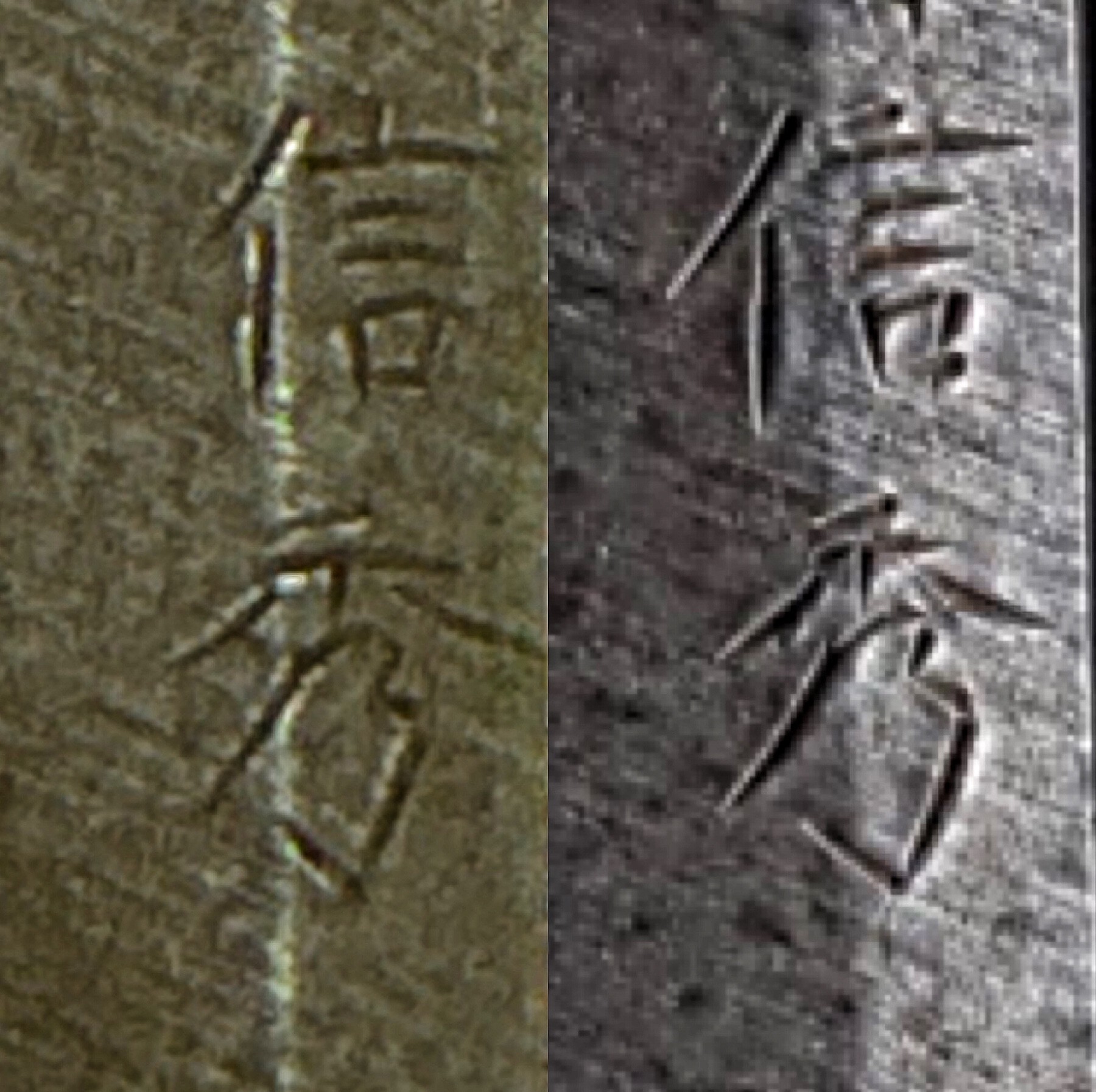

Guest Simon R Posted January 24, 2024 Report Posted January 24, 2024 This is your signature on the left against a Tokubetsu Hozon papered blade by 信秀 Nobuhide on the right. Get ready for the private messages saying "Ooh it's a fake signature but I love the fittings so I'd be willing to take it off your hands for a couple of grand". Sit tight. Quote
PNSSHOGUN Posted January 24, 2024 Report Posted January 24, 2024 Looks close, though a little crude in some spots. I summon @Jacques D. for more knowledge.... 1 Quote
Bugyotsuji Posted January 24, 2024 Report Posted January 24, 2024 The direction of the top stroke of 言 is quite different though. Looks deliberate, for whatever reason. 1 Quote
Guest Simon R Posted January 24, 2024 Report Posted January 24, 2024 On 1/24/2024 at 8:22 AM, PNSSHOGUN said: Looks close, though a little crude in some spots. I summon @Jacques D. for more knowledge.... Expand "IT'S GIMEI." Quote
DTM72 Posted January 24, 2024 Report Posted January 24, 2024 On 1/24/2024 at 8:46 AM, Simon R said: "IT'S GIMEI." Expand I was gonna type that, but decided to be nice. Good job Simon! Quote
Stephen Posted January 24, 2024 Report Posted January 24, 2024 We all know brother Simon has no fear...or lack of....shut my mouth lol Quote
