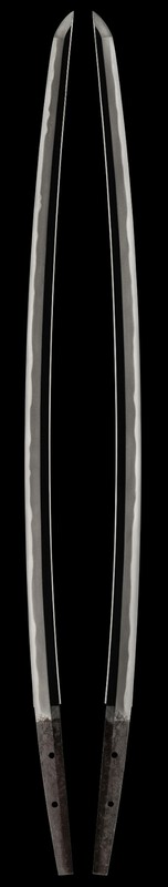

Rivkin Posted February 9, 2024 Report Posted February 9, 2024 It gets difficult to comment since there is a competing interest, but frankly it just does not look exciting as a blade. Nakago can be tolerated in something old, this is likely early Muromachi, but overall there is just not much. Quote
Schneeds Posted February 26, 2024 Author Report Posted February 26, 2024 On 2/9/2024 at 7:19 PM, Rivkin said: It gets difficult to comment since there is a competing interest, but frankly it just does not look exciting as a blade. Nakago can be tolerated in something old, this is likely early Muromachi, but overall there is just not much. Expand I've found myself coming back to this blade a number of times recently; I'm curious what your thoughts would be. Judged Naoe Shizu, 70cm. When I compare it to other Naoe Shizu works I can find it looks like a fine example. Is this pretty typical work for the School, or an above average example? I came across a comment from Ray recently where he mentioned he likes to take the seller pictures from perspective purchase swords and work with them in photoshop to make sure nothing is being missed and I thought that was an excellent idea given the quality of photography varies so wildly. I worked with these a bit as the seller's images were a bit lacking. As always, thank you for your input. 1 Quote
Rivkin Posted February 26, 2024 Report Posted February 26, 2024 It looks like a nice blade. Naoe Shizu has a "bad" reputation because it can be Muromachi, but its one of exceptions where mumei blades can definitely get TH and go Juyo, so its kind of judged by Nanbokucho principles, same as Oei Hasebe and a few other schools. I think sue-Sa is another possible attribution here, hamon is a bit more nie heavy on top, which is often seen in west Japan's schools like Sa or Naotsuna, while Naoe Shizu tends to be more harsh, larger nie throughout the entire hamon, also with more prominent masame. But one sees it in Naoe Shizu now and then as well and overall the attribution appears solid. On the negative hamon here comes out a bit soft since it lacks prominent sunagashi etc. Jigane is good. If it would have stronger nie in hamon definitely Juyo grade, though such statements are very subjective. As is, can still be an attractive blade. Feels like the earliest Muromachi. 2 Quote
Schneeds Posted February 27, 2024 Author Report Posted February 27, 2024 On 2/26/2024 at 9:17 PM, Rivkin said: If it would have stronger nie in hamon definitely Juyo grade, though such statements are very subjective. As is, can still be an attractive blade. Feels like the earliest Muromachi. Expand That actually answers a question I was hesitant to ask for fear of looking the fool. Many of the Naoe Shizu blades that I could still find pictures of to compare it with were Juyo blades of nearly identical proportions. However I thought the Jigane in this was one was as good or even better in some cases, but the hamon was not as strong as the Juyo blades and I didn't know if that was reason enough for such a difference in papering. Is it the kissaki that leads you to believe earliest Muromachi years? Also interesting you bring up Sue-Sa. There is a second blade I have been studying that is judged Sue-Sa Ichimon. The Jigane to me looks to be a bit rougher, however the sugata is more grand and is several cm longer with more of a classic Nanbokucho o-kissaki. The exposure in the pictures has unfortunately blown out the details of the hamon. Quote
Rivkin Posted February 27, 2024 Report Posted February 27, 2024 Very tired or more likely tired and poor polish. Quote

Schneeds Posted February 28, 2024 Author Report Posted February 28, 2024 Beautiful blade, Michael. On 2/27/2024 at 7:10 AM, Rivkin said: Very tired or more likely tired and poor polish. Expand Is this kitaeware, shinae, or munegirie? Seller has stated it is kitaeware, but cannot provide additional photographs. It does not appear on the opposing side, but there's no way to tell if continues around the edge down into the mune. How big of a concern? Quote
Alex A Posted February 28, 2024 Report Posted February 28, 2024 Shintetsu, core steel Japanese SWORD FLAWS (japaneseswordindex.com) Oh sorry, you mean the little marks, just look like a dint and a crack, not serious but depends how fussy you are. Quote
Schneeds Posted February 28, 2024 Author Report Posted February 28, 2024 On 2/28/2024 at 4:55 PM, Alex A said: Shintetsu, core steel Expand Where is there core steel visible? The little oval defect in the bottom of the hi? or referring to the other blade I posted above that is tired? Quote
Alex A Posted February 28, 2024 Report Posted February 28, 2024 Hi i was referring the images above my comment, the little oval defect appeared to be a dint, to my eyes. Bottom picture, left at first glance appears to be some difference, darkness, possibly core steel beginning to show. On old swords, acceptable in moderation. Can expect stuff like this on very old swords, part of the reason that got me more interested in Shinsakuto. 1 Quote
Schneeds Posted February 28, 2024 Author Report Posted February 28, 2024 Ah ok, thank you. It's tough to identify things like that as a beginner especially knowing the effect lighting can have. Here's the original image set and I took the liberty of balancing out the exposure and contrast. They heavily side-lit the blade from the right to bring out the texture so there's only so much I can do. I think I see what you mean but it seems minimal and not unpleasing. Quote
Alex A Posted February 28, 2024 Report Posted February 28, 2024 To me it looks a good blade but appears it wont take any more polish Quote

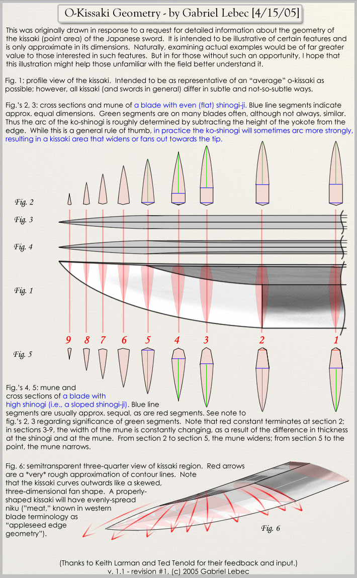

Tsuku Posted February 29, 2024 Report Posted February 29, 2024 On 2/27/2024 at 2:20 AM, Schneeds said: That actually answers a question I was hesitant to ask for fear of looking the fool. Many of the Naoe Shizu blades that I could still find pictures of to compare it with were Juyo blades of nearly identical proportions. However I thought the Jigane in this was one was as good or even better in some cases, but the hamon was not as strong as the Juyo blades and I didn't know if that was reason enough for such a difference in papering. Is it the kissaki that leads you to believe earliest Muromachi years? Expand The brightness and clarity of the hamon is a big deal at Juyo. Maybe it would help to think about it this way — jūyō means "important," but also in the sense of "essential" or "principal." (It doesn't really mean "nice sword.") So for a blade to be "important" in this sense it needs to either have some historical context that justifies its importance, or be an exemplar of what those blades should be. So you can ask "is this an example that shows everything important about this school's tradition of work?" If you say "yes, almost all of it" then it's likely a decent candidate — but you also need to understand what "almost all of it" means. For example, Western collectors often neglect the boshi, but it is one of the most important fingerprints we have of school/smith, so this is actually quite important. What sticks out to me about this Naoe Shizu is that the geometry of the kissaki does not look geometrically correct. Perhaps the blade was chipped, and this was how the togishi tried to save it. Take a look at these two resources and then look at the kissaki again. What do you see? Quote

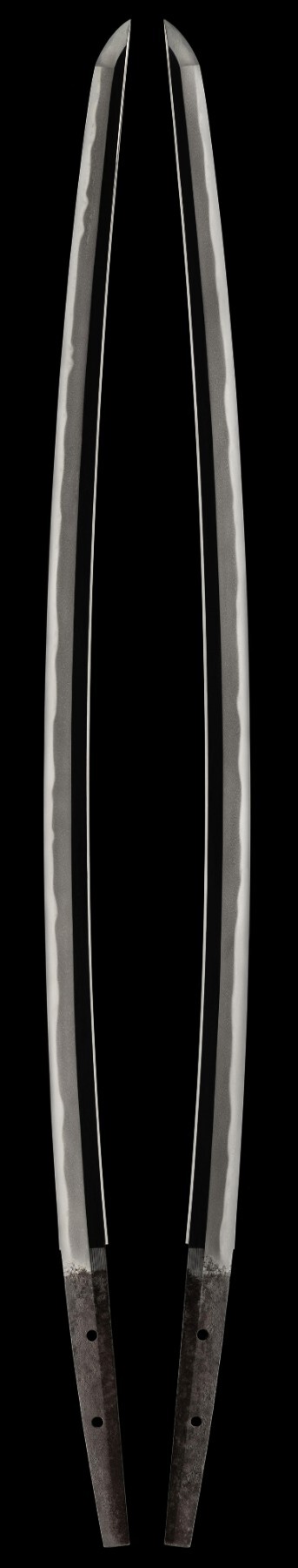

Schneeds Posted February 29, 2024 Author Report Posted February 29, 2024 On 2/29/2024 at 12:43 AM, Tsuku said: Take a look at these two resources and then look at the kissaki again. What do you see? Expand You're referring to the angle of the yokote? If it wasn't obvious, I'm not looking at this like a Juyo candidate. My budget range is nowhere near Juyo Here's a composite of two of the images of the same side of the kissaki, adjusted for a 180 degree plane. The yokote angle is substantially different, even in relation to the mune edge. Maybe they're using a wide angle lens and not using distortion correction or it's the angle the image is taken in relation to the blade? When I do the composite for the other side there's a difference, but it's not as extreme. Without seeing it in person I don't think it will be possible to know one way or the other. But now I'm not scrutinizing the yokote of every blade I look at so that's good Quote
Schneeds Posted March 6, 2024 Author Report Posted March 6, 2024 On 2/28/2024 at 6:51 PM, Alex A said: To me it looks a good blade but appears it wont take any more polish Expand What do you think of this Naoe Shizu compared to the first one? It is from the same seller; a fair bit of a cost increase though. The Nagasa is nearly identical length. To me the jiagne is more of a standout on this one with well defined pattern and there is more to appreciate since there are no hi present, but I also thought the hi went well with the first blade. The hamon I am unsure. Quote
Katsujinken Posted March 10, 2024 Report Posted March 10, 2024 Personally I want to see a bit more hamachi on a blade, but the workmanship is good in my opinion. That said, something about that kissaki feels weird/out of proportion to me... anyone else agree? Quote
