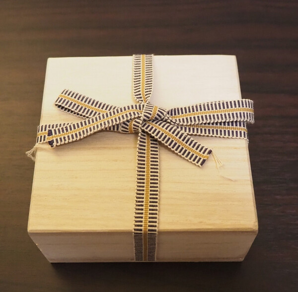

I made a box for a tsuba that was a gift. To make the airplane transport more secure, and to keep the traditional feel, I added sanada himo (they need some fixations at the bottom to avoid slipping). The knot makes it also very nice, even when closed.P82417341.thumb.jpg.319ce9c9e7a5f18eb0aa31b01371c049.jpg

  On 1/21/2024 at 8:41 AM, Bugyotsuji said:
Does your tsuba travel inside that box?
Expand
It traveled from Japan to France in my checked-in luggage, no issue. The cushion I made was big enough that the tsuba did not wiggle about inside its box.

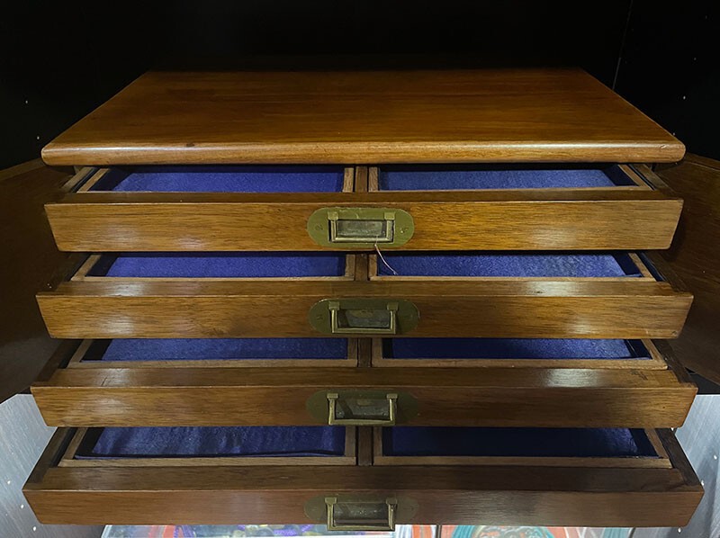

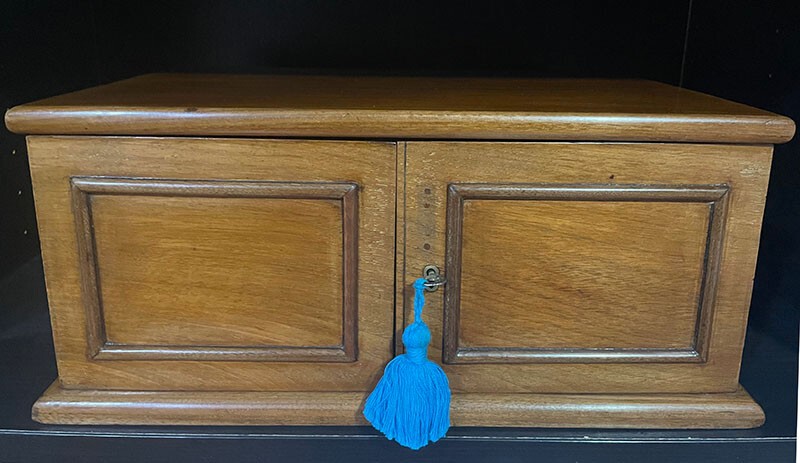

For those who are interested in something more vintage, I have just acquired this Victorian specimen collector's box. It has four drawers with two shelves in each one, divided into two sides. Depending on the size of the tsuba it will store between 2 and four per section, which means that it could store up to 64 of the smaller tsuba.
Does anyone have any suggestions for a thin, but cushioned and pliable material to put between the tsuba to stop them rubbing and bumping when the drawers are opened? I don't plan to alter the box, but I would like them to be more secure.

Lovely cabinet. Congratulations. Can't see the smaller divisions that you describe though.
Not an easy question to answer, but you could make eight/sixteen identical wooden grids, four/eight of these with  different internal sizes to cope with the various different tsuba in your collection.
Which reminds me of a cabinet I bought for my daughter's tools about twenty years ago. It came to light during a spring clean the other day. If she doesn't claim it soon, I might just 'borrow' it for tsuba instead!!! :laughing:

Each side of the drawers is a square box that lifts out to reveal another space below. So, it is two-tiered.
Thanks for the suggestion... That would work really well for the ones with 4.
When I tried one big, one small in the shelf, they lie diagonally, and not on an even division. So I would like a soft, maybe rubbery material to pad the space between them.

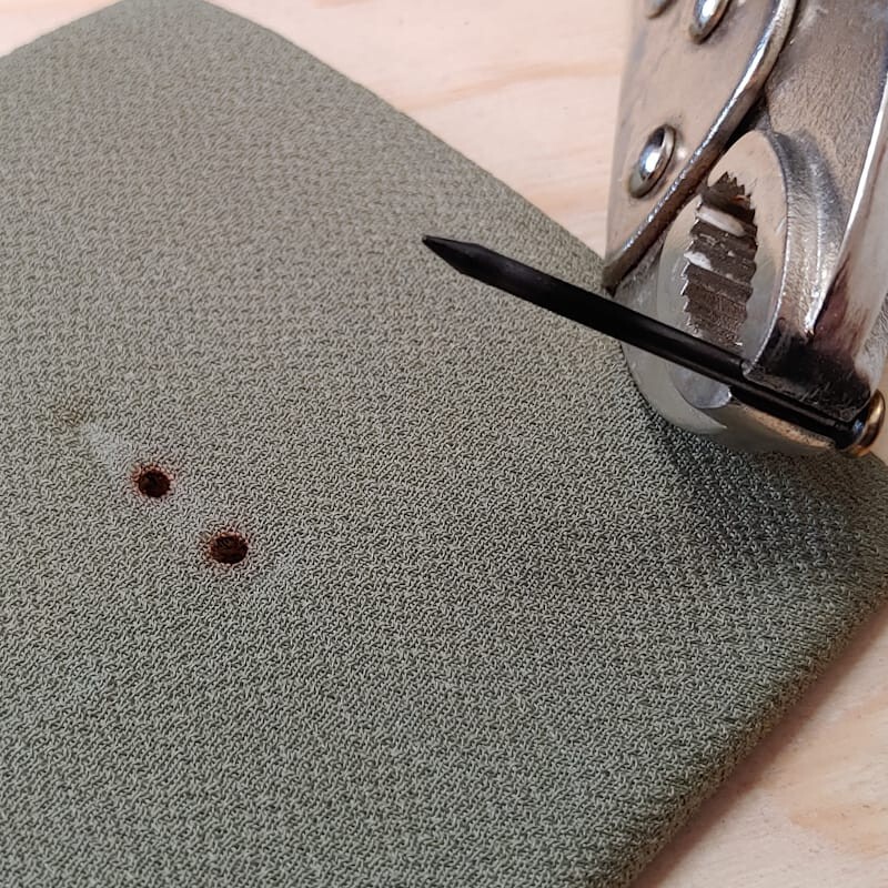

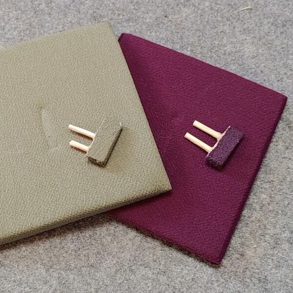

We had this here already but I highly recommend to remove the steel nails always!
The solution working for me is to drill one or two holes in the nakago ana piece and glue in some thin shish kebab skewer.
Then I burn the matching holes through the base plate with a glowing thick nail (wetten the silk before).
(When trying to drill through the silk and padding, the silk winded around the drill, so I chose this way.)
Finally I glue the pieces together.
Expand
Thanks. A very creative way to do it. In this case, I don't want to drill into the drawers, and they don't have enough depth to fit a padded piece along with the tsuba.
I picked up something from a local art shop yesterday which looks promising - it is a flexible, clear plastic with a triangular cross-section. I gave it a quick try last night, and it seems to work ok... I'll post pics when I have sorted it out.
