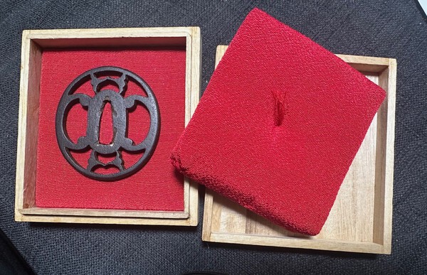

Guest Simon R Posted January 17, 2024 Report Posted January 17, 2024 Same problem; I just tapped out the bottom as Piers suggests and made the correct sized wooden post. The original material was moth eaten and it didn't have a cushion so I took this opportunity to recover the base and make a cushion (in red, just be different). Quote

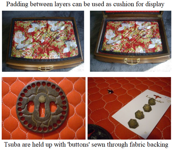

Steves87 Posted January 19, 2024 Report Posted January 19, 2024 Along the lines of Dale's post, there was a post here on NMB a few years ago where a member stated they kept the original peg (I think) and drilled two holes in it. They removed the nails then glued and tied (with string) the peg through the baseplate. I thought this was a good idea, so I 3d printed a ton of pegs. The pegs have two holes the whole way through, with a recess between the holes (on one face only) for the knot to sit in. You can subsequently cover/finish the peg as desired. Hopefully you can see these details on the picture. Mostly not my idea, but it works and has two stage adherence. If it does break off, it's relatively soft. 3 1 Quote
