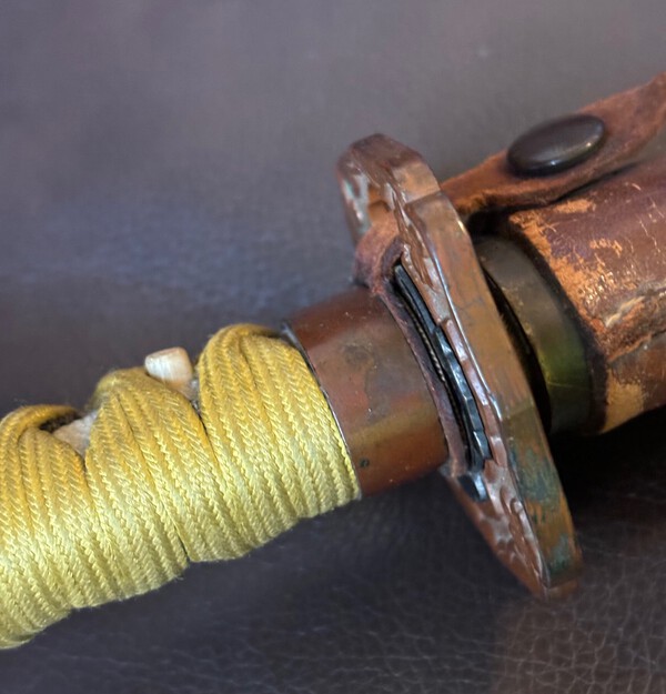

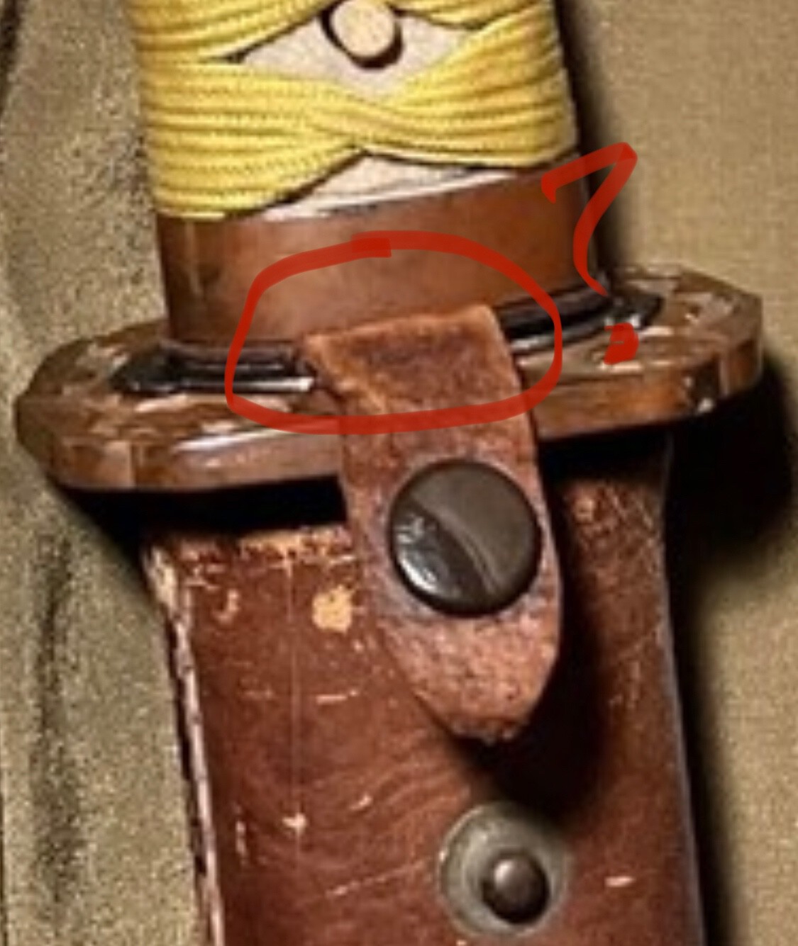

If you got this sword for your own enjoyment, learning, and collection, I don’t think you did too bad. It looks in great polish, and I, personally, like the fittings. The WW2 connection is cool to me too…
For my own curiosity, can you tell us where the leather clip strap is connected? Is it connected to a seppa or something? It looks like it disappears under the tsuba between the fuchi
Good eye, George! I had assumed it had come up from the leather saya cover, but from this picture, you can see it is above the tuba, like you say.
Looks to be the leather seppa with the strap/snap vs. the also seen fuchi ring with snap/strap.
it just looks like it is not pushed through the hitsu-ana to where it would engage the matching snap on the saya cover. The usual case is the the leather saya cover and the snap/strap have shrunk over time and will no longer meet and snap.
Thank you @DTM72 and @Bruce Pennington ! That is something that I have not seen before; and now I'll have this reference if I see it in the future.
I have a few swords with a leather cover, and similarly, none of them align so they snap together anymore.
All the best,
-Sam
The fuchi ring with snap. This type is used when all your seppa and tsuba are tight. If you have a type 94/98 with leather saya and the tsuba is loose, you need the leather seppa with the strap/snap. Sorry, can't find a good picture anywhere of this type.

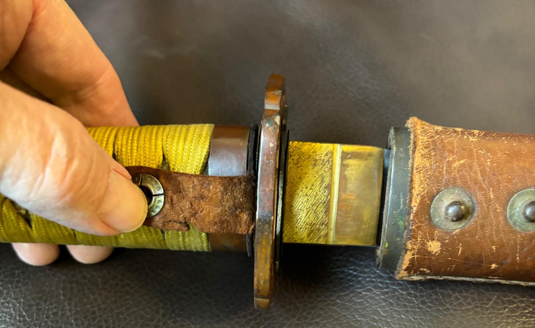

Hi y’all took pictures It looks like the strap is between the fuchi and seppa I wish it were a double snap rather than single but if I’m lucky I may find one on eBay The tsuba is a little looser than I would like any ideas?
