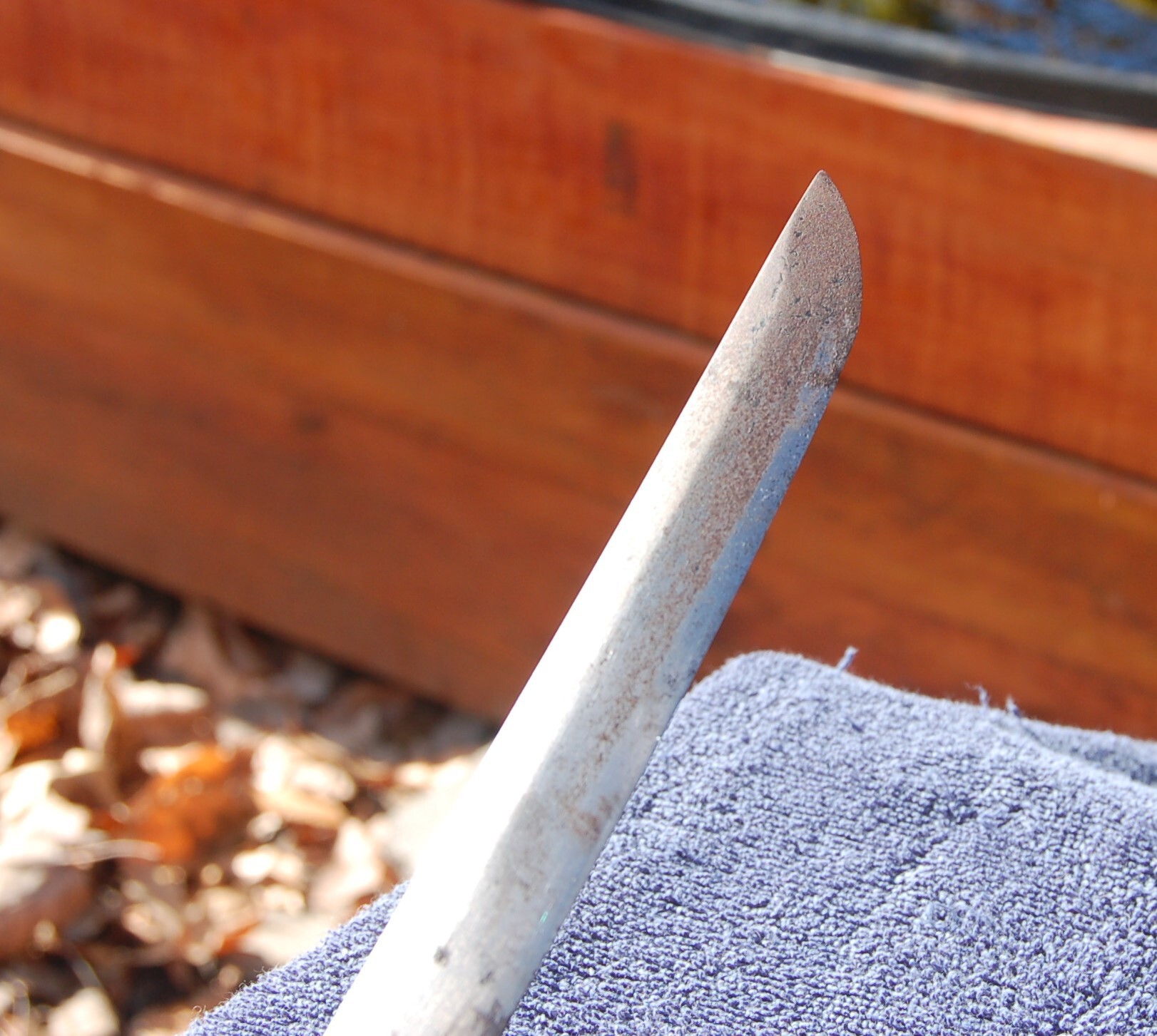

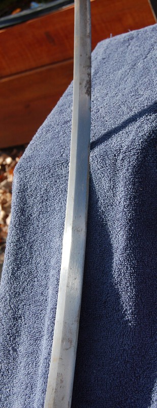

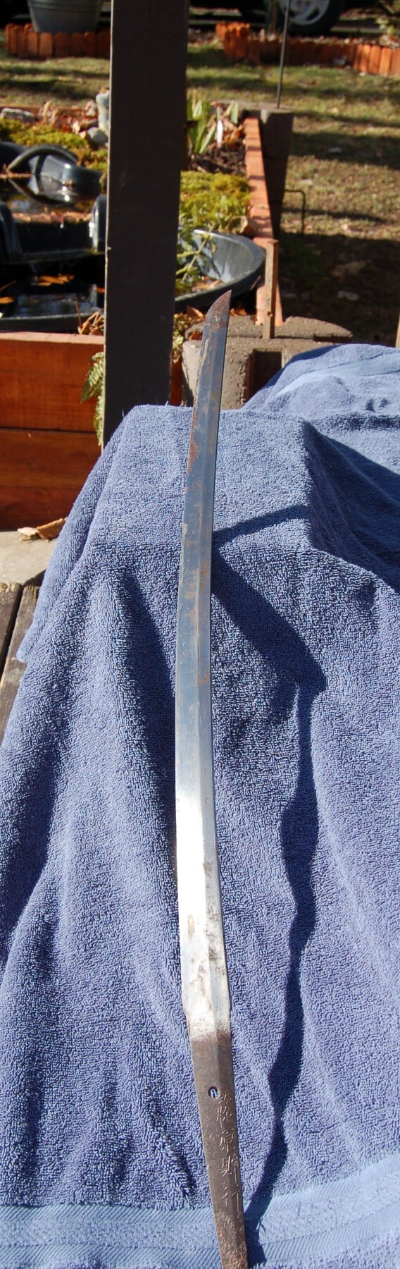

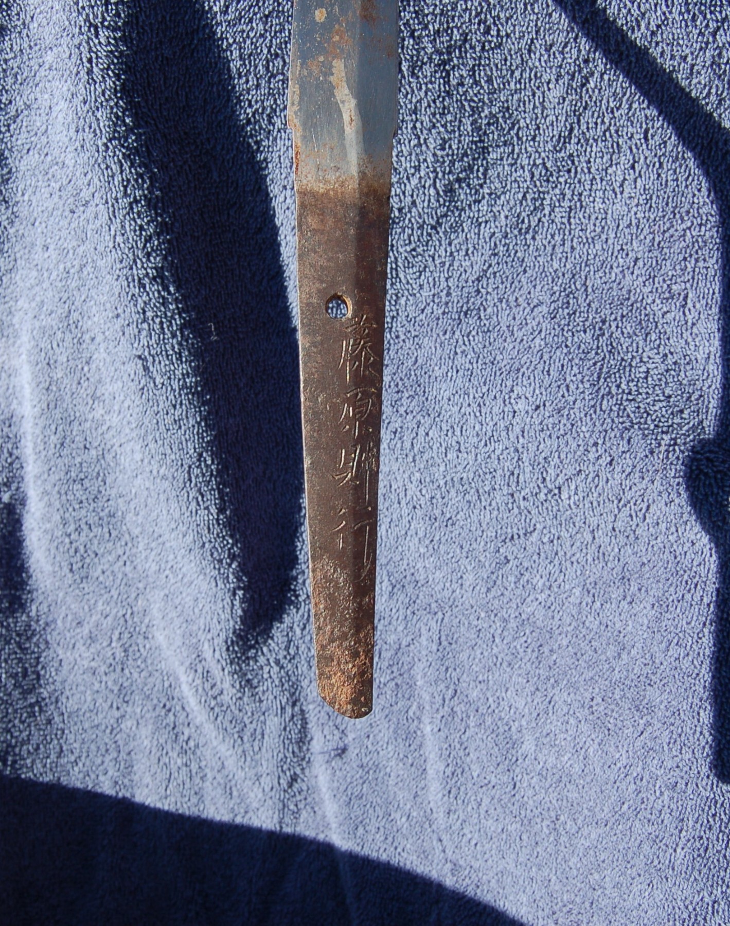

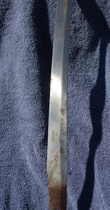

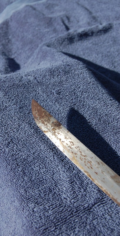

As many know on here  back in june 23 I rescued a Wakizashi from the dumpster after much oil, tissue paper and wiping i believe  (except the tang)I have a handle on the active rust And wanted to share some better (hopefully) pictures of my find.
Nick
Nick,
it is a good thing to save a blade! But if you look closely at it, you will see that the SHINOGI is very much rounded which means that it had been heavily ground before. The chances to show a clear HAMON are slim now if you do not have the capacities of a TOGISHI. Please remember that any DIY restoration attempt will worsen the condition and reduce the historical and monetary value.
I think I can see a shadow of a SUGUHA HAMON, but it might be difficult to be shown even with better photos.
As you know, it is technically seen as WAKIZASHI, but that does not mean that it was carried as such. There are many types of older blades that were used as primary weapons like UCHI GATANA, KATATE UCHU or CHIISA GATANA. Al these were mostly just below 2 SHAKU ( = 606 mm). Your sword has a long NAKAGO which makes me believe it was carried and used as KATANA.
My suggestion is to show the blade to a traditionally trained polisher and hear his opinion, perhaps having a "window" polished to see how it would come out (= not so expensive), and in case money falls from the sky, have it completely polished, plus SHIRASAYA and new HABAKI.
That is the moment you will truly appreciate your sword, completely independent of the signature.

as there is some (aggressive) red rust on your blade, oiling will not be enough to prevent further deterioration. If I may suggest, send some pictures to a reliable TOGISHI and ask for advice.
You certainly don't want to put your blade in a SAYA in that condition!
