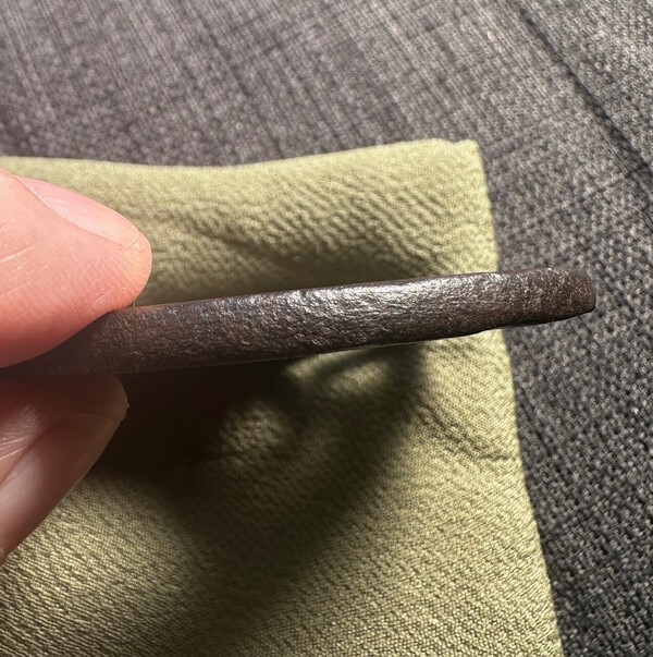

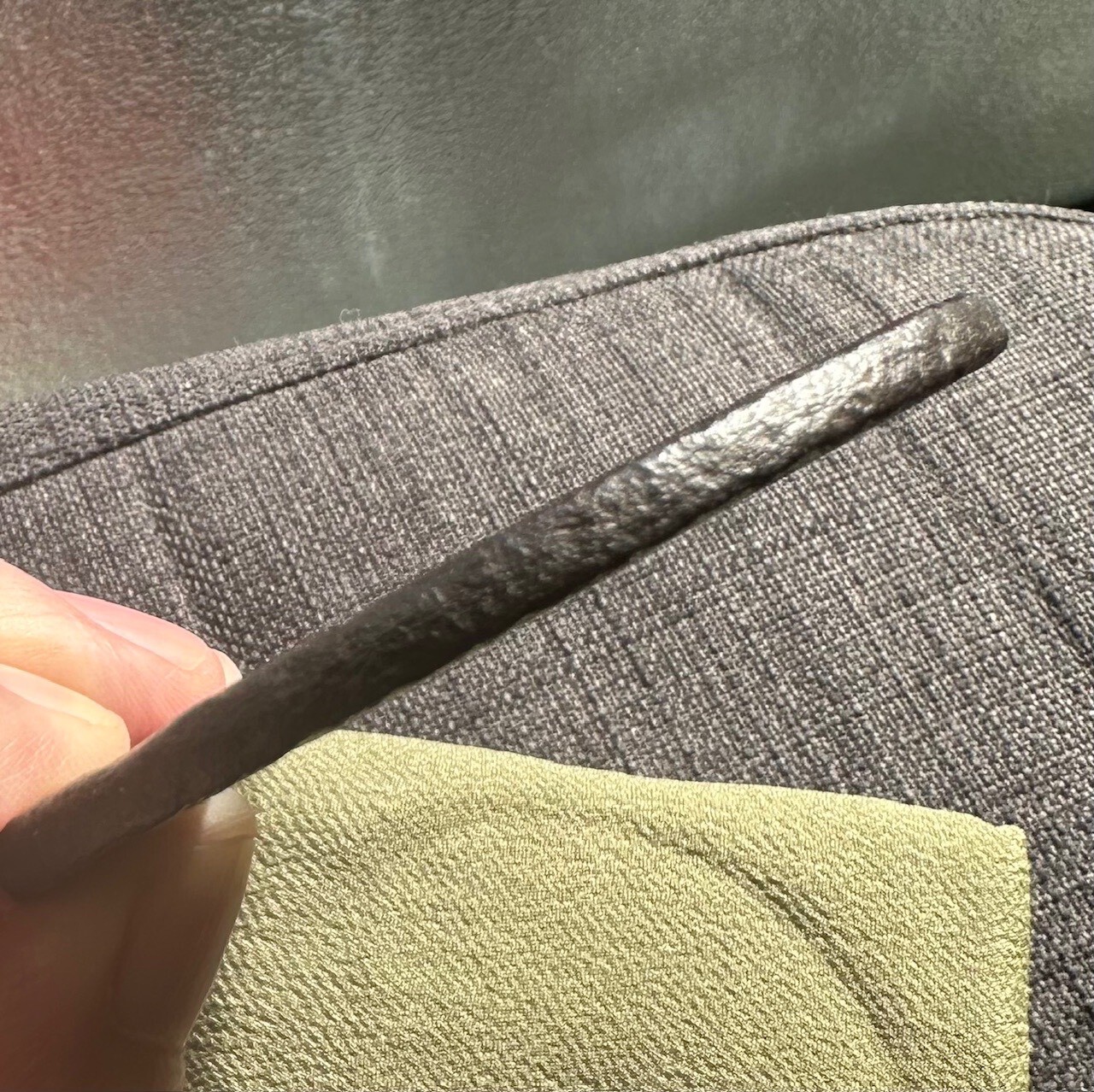

Simon, would it be possible to get a silhouette shot or two of the mimi edge patterns of yours, from the sides?
Guest Simon R
4 hours ago, Bugyotsuji said:
Dale's Princeton example seems to be made with at least two different repeating patterns, a round file and three sharp inclined escarpments, to the centre line, then reversed for the other half. So rounded valley, sharp, sharp, sharp, round, sharp, sharp, sharp... etc.
Certainly Piers,
Firstly the dimensions, as I haven't given those in past posts:
Height: 7.5 cm
Width: 7.4
Thickness: 4.75mm
It was frustratingly difficult trying to get decent shots in the remaining sunlight. And, for those who are horrified at me handling the tsuba without gloves, they can rest easy knowing I washed and dried my hands thoroughly beforehand - plus the tsuba already had a coating of Renaissance Wax. Just to be absolutely
sure, I used a clean, cotton cloth on it afterwards.
I forgot to mention before that it has what appears to be a sword strike on the edge (clearly visible in the photographs).
I love this detail as - not only does it prove it was used for the purpose it was created - but it also gives this otherwise almost perfect piece of art a distinct touch of 'wabi sabi'!

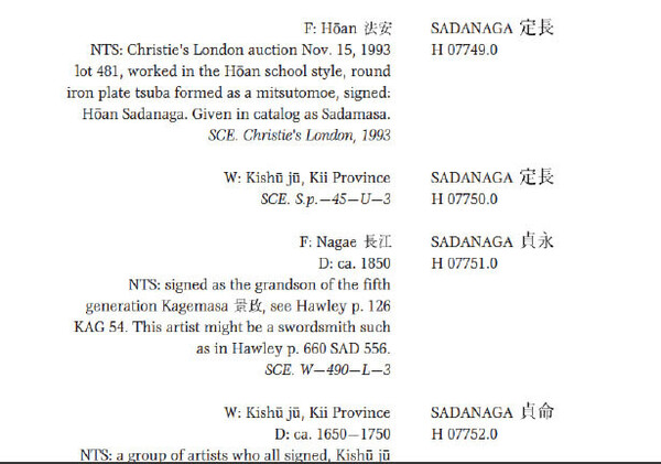

DEAR TSUBA SPECIALISTS - NOW I NEED YOUR HELP IN FOLLOWING UP MY ONE LEAD ON THIS TSUBA'S MAKER!
Thanks to Bruno @Kurikata, I now know that he appears in
Robert Haynes
"The Index of Japanese Sword Fittings and Associated Artists"
Reference: H 07749.0
Sacrilege I know, but I do not possess a copy of Haynes' seminal work. Could someone please photograph the relevant entry and either post it on this thread or PM me?

Guest Simon R
19 minutes ago, Brian said:
This one?
You Sir, are a gentleman and a scholar!!!
