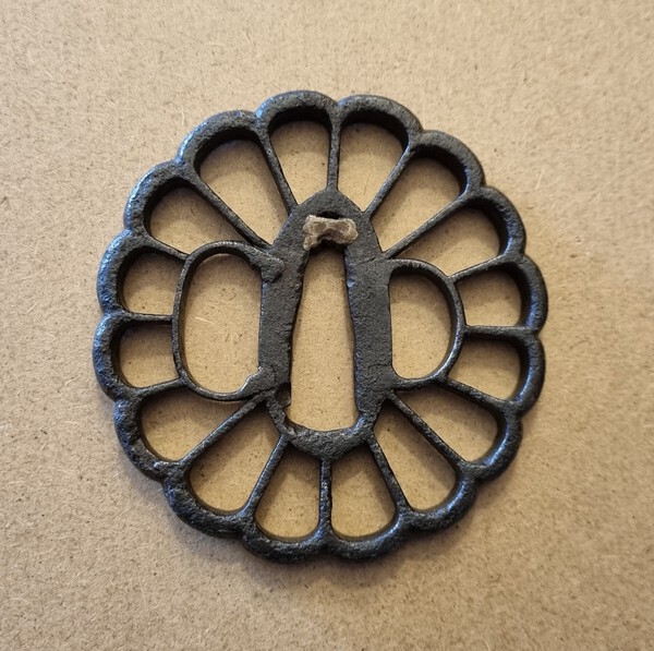

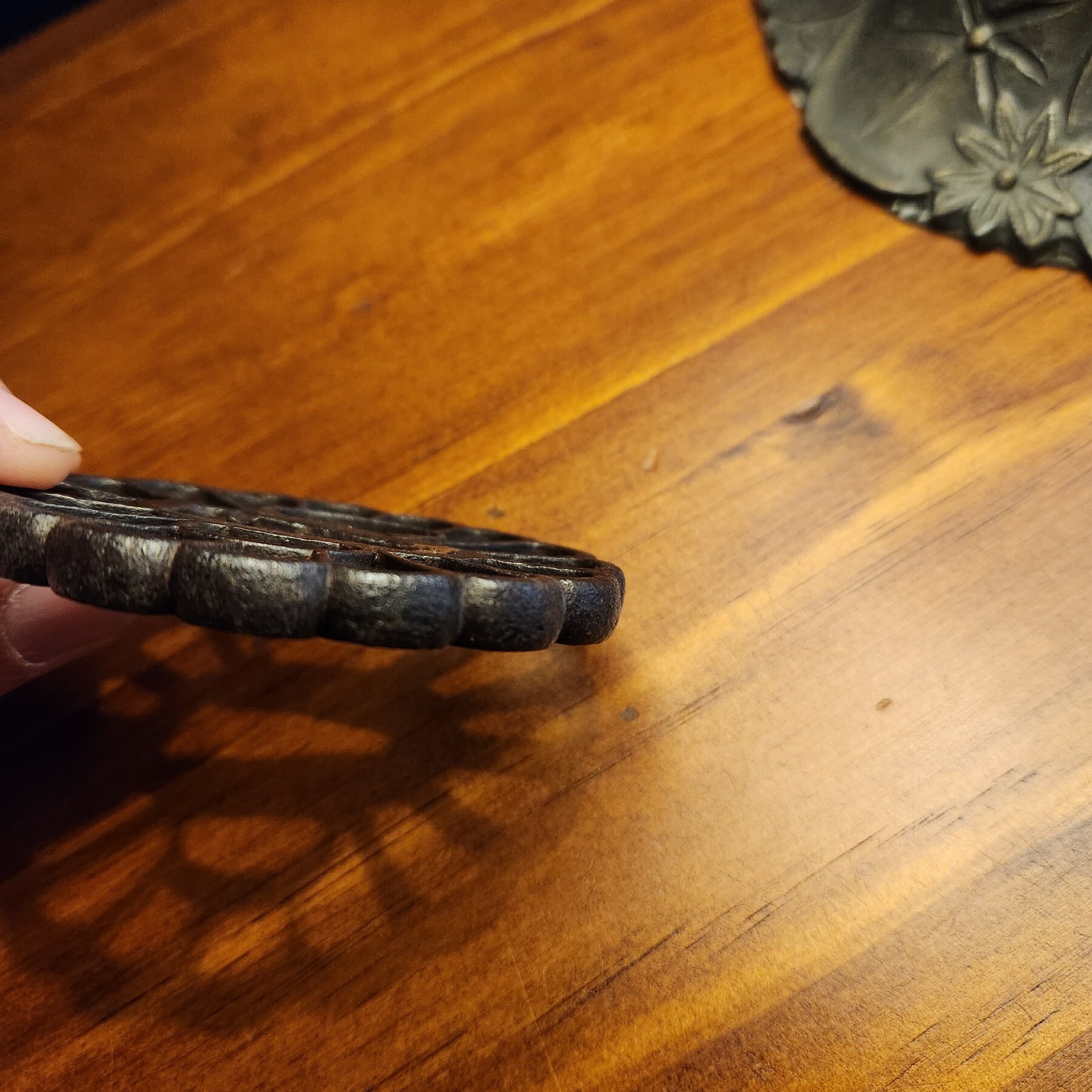

Okan Posted December 30, 2024 Report Posted December 30, 2024 Another very interesting one. It belongs to a friend. I couldn’t figure out the mei, but my gut says it should have been on an important sword. 2 Quote
Steve Waszak Posted December 30, 2024 Report Posted December 30, 2024 Okan, These last two tsuba you have posted, and the second in particular, remind me of the "San Diego tsuba" that were recovered from the wreck of a Spanish ship on its way to the Philippines in the year 1600. If you search around the Internet, you'll find some interesting information on this. Jim Gilbert's blog post (Tsuba Kansho) on these tsuba is enlightening, especially since there is a reference to molds uncovered from an early-Edo Period site in Nara. These molds are thought to have been used to cast tsuba in soft metal, such as bronze and yamagane. Your tsuba above appears to be cast, based on certain details such as the mei and the kiku punch marks around the nakago-ana. 2 Quote
Dan tsuba Posted December 30, 2024 Author Report Posted December 30, 2024 So Okan, here is the link that Steven was referring to on the San Diego Tsuba. Scroll down somewhat and you will find it. https://tsubakansho.com/tag/cast/ In the upper right-hand corner of the picture shown under San Diego Tsuba, you will see a 16 petal chrysanthemum tsuba. Then in the other pictures, you will be able to discern pieces of molds that appear to have a kiku (chrysanthemum) motif. Don't get me started if those molds were used for soft metal or cast iron! Ha, ha, ha, ha, ha, ha, etc (I crack myself up!). Onward! 1 1 Quote
Okan Posted December 30, 2024 Report Posted December 30, 2024 1 hour ago, Steve Waszak said: Okan, These last two tsuba you have posted, and the second in particular, remind me of the "San Diego tsuba" that were recovered from the wreck of a Spanish ship on its way to the Philippines in the year 1600. If you search around the Internet, you'll find some interesting information on this. Jim Gilbert's blog post (Tsuba Kansho) on these tsuba is enlightening, especially since there is a reference to molds uncovered from an early-Edo Period site in Nara. These molds are thought to have been used to cast tsuba in soft metal, such as bronze and yamagane. Your tsuba above appears to be cast, based on certain details such as the mei and the kiku punch marks around the nakago-ana. Hi Steve, I don't know but you are most likely right. I have read everything about San Diego wreck and conducted extensive research on shipwreck tsuba, as I’ve encountered them(iron) before. - But thanks for sharing. Quote
Iekatsu Posted 16 hours ago Report Posted 16 hours ago Hard to say if the Mei has been stamped or cast. Just a reminder that Yamagane as far as my research has shown was not used for casting, when it looks like Yamagane it is always bronze. Quote
ROKUJURO Posted 15 hours ago Report Posted 15 hours ago As far as I know, bronze (a copper-tin alloy) was not used for TSUBA-making. Bronze is always a cast metal, and copper has to be cast as well in a raw shape. Infos by Ford Hallam Quote
Iekatsu Posted 15 hours ago Report Posted 15 hours ago 13 minutes ago, ROKUJURO said: As far as I know, bronze (a copper-tin alloy) was not used for TSUBA-making. Bronze is always a cast metal, and copper has to be cast as well in a raw shape. Infos by Ford Hallam Bronze was definitely used to make Tsuba, they were cast using molds, like the examples found in the Nara site mentioned by Steve above. Every Kagami-shi Tsuba I have had tested is Bronze in composition. Yamagane/copper was not used to cast Tsuba, the properties mean that it would not flow sufficiently into a mold, however Yamagane/copper was used to cast blanks for making Tsuba, by dropping molten Yamagane/copper into water, as demonstrated by Ford and documented on Youtube. Quote
ROKUJURO Posted 13 hours ago Report Posted 13 hours ago Thomas, you are correct, the mirror-makers used also bronze. With "cast in a raw shape" I meant exactly the casting of copper ingots for TSUBA making in water. YAMAGANE is also likely to produce voids if cast in a mold. Quote

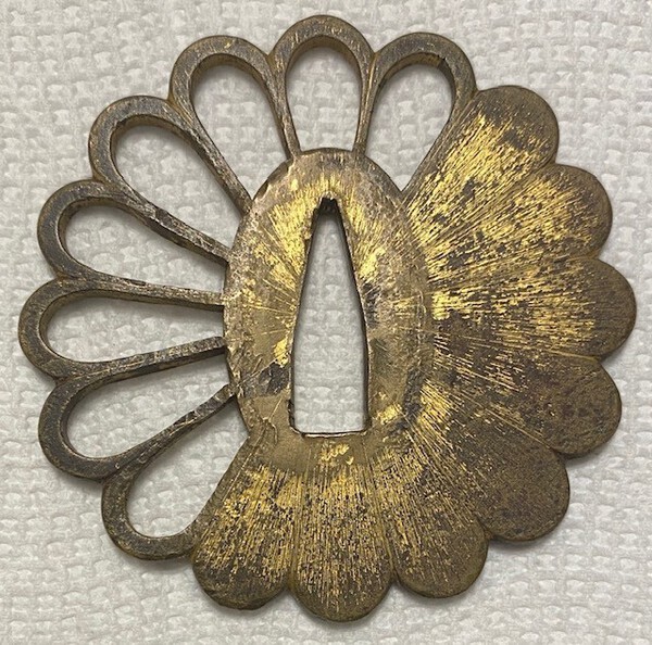

Curran Posted 10 hours ago Report Posted 10 hours ago On 1/21/2024 at 1:32 PM, thutson said: Interesting thread, Kiku is certianly a very popular theme for tsuba. Here is one of mine, a Ko-Kinko Yamagane Kiku-Gata tsuba with 28 petals, which dates to the mid Muromachi period. Tom Ooh-la-la Nice. I have a similar 1500s shakudo one, presumably for uchigatana. I love these with the earlier hitsu ana. Quote

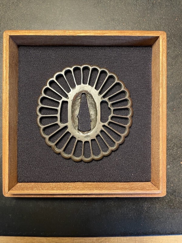

Curran Posted 10 hours ago Report Posted 10 hours ago I am joining this thread a little late. Chrysanthemums have been a theme I have enjoyed over the years. Had quite a few of all types. Some very valuable (Hikozo). Some not so expensive. My favorite iron 16 petal iron chrysanthemum tsuba. Not easy to tell, but this one is a bit concave. 4 Quote
Bugyotsuji Posted 9 hours ago Report Posted 9 hours ago (Joining Curran.) Fairly large iron 24-petal chrysanthemum tachi(?) tsuba. Sold as daishō, but they are not exactly identical. 2 Quote

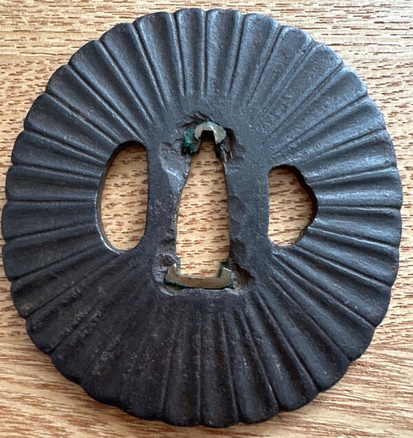

Mark S. Posted 8 hours ago Report Posted 8 hours ago Remembered I had this 16-petal one in the mix. Came off a mismatched very poor koshirae. I know nothing about it and really never gave it much thought. 2 1 Quote
Steves87 Posted 5 hours ago Report Posted 5 hours ago Like the post from Curran, this Tsuba is also concave both sides (Hoiteibara) 2 Quote
