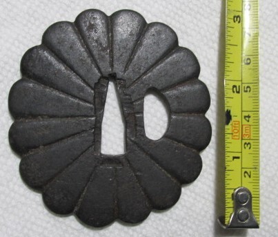

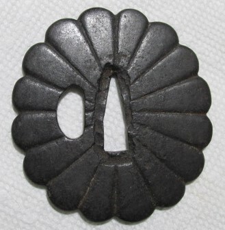

Dan tsuba Posted December 29, 2023 Report Posted December 29, 2023 So, I have seen many chrysanthemum (known as “kiku” in Japan) type tsuba with different designs. The one I have in my collection is a fairly common design on tsuba. However, my tsuba has 16 petals that make up the kiku. I have read that the 16 petal kiku is the symbol of the Imperial family of Japan and “Only the Imperial family is allowed to use the 16-petal chrysanthemum crest on it tea cups, towels and other items.” https://factsanddeta.../sub111/item586.html Also,” Earlier in Japanese history, when Emperor Go-Daigo, who tried to break the power of the shogunate in 1333, was exiled, he adopted the seventeen-petalled chrysanthemum in order to differentiate himself from the Northern Court's Emperor Kōgon, who kept the imperial 16-petalled mon.“ https://en.wikipedia...perial_Seal_of_Japan I am wondering if the 16 petal kiku tsuba I have was used by a member, retainer, or someone associated with the Imperial family? I am thinking that if the 16 petal kiku tsuba was used by anyone else other than with someone associated with the Imperial family, than it would be a taboo thing to do and there probably would be some kind of penalty (especially in the old days of Japan)? Anyway, just another interesting thought! With respect, Dan 1 Quote

Dan tsuba Posted December 29, 2023 Author Report Posted December 29, 2023 Thanks Brian, What you stated is interesting! And yes, I have seen many tsuba with the Aoi mon! And I agree with you that "Towards the end of Edo and Meiji, anyone was using anything." Unfortunately without a mei on the 16 petal kiku piece shown in my post, its age would be difficult to determine. So Meiji, Edo, Muromachi, who knows! With respect, Dan Quote

Dan tsuba Posted December 29, 2023 Author Report Posted December 29, 2023 O.K. members. Kiki dee (thanks Spartancrest-that video is hilarious!), or kiku dee. I don’t think Elton John collected tsuba!! Whatever! So, let’s take what we know and put that together with human nature (which really hasn’t changed that much through the ages – my opinion!). We know that some samurai had many tsuba that they used on the same sword (I know I read that somewhere but can’t recall the reference!). Now, let us say that a samurai that is attached to the royal or Imperial household is preparing to go into battle. Would he use a beautiful tsuba that he displays on his sword for official or court appearances and use that tsuba to go into battle with? I don’t think so! He might use a simple and strong tsuba on his sword that still shows his allegiance and affiliation with the royal family. Such as the "simple” 16 petal kiku tsuba in my previous post. My good friends, it’s not rocket science! If given the same situation, what tsuba would you use on your battle sword that would still show that you are attached and have allegiance to the royal (or Imperial) family? Would you use a beautiful hand carved or decorated (and is signed by the artist) tsuba that cost a small fortune and everyone at court “wows” over it, or a comparatively simple and relatively inexpensive and functional tsuba that will “do the job” and still shows by the mon on the tsuba who you represent and are fighting for! Hmm!!! With respect, Dan Quote

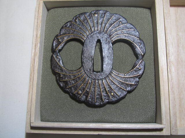

Brian Posted December 30, 2023 Report Posted December 30, 2023 Imho, there is next to zero chance this has anything to do with the Imperial family. We have seen countless tsuba over the years with symbolic imagery that have nothing to do with royalty. Aoi mon, kiku, and just about every other mon shown on tsuba are just themes, there is zero collaboration of this theory. 2 1 Quote

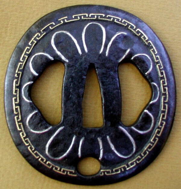

Brian Posted December 30, 2023 Report Posted December 30, 2023 http://jameelcentre....0/EA_X_11165-a-L.jpg https://www.espace4....r-japon1-462x347.jpg https://varshavskyco...18/01/TSU-0346-a.jpg 2 Quote

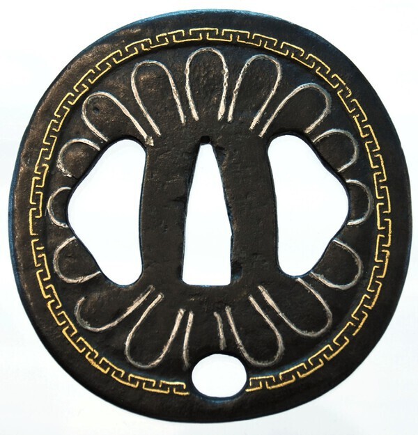

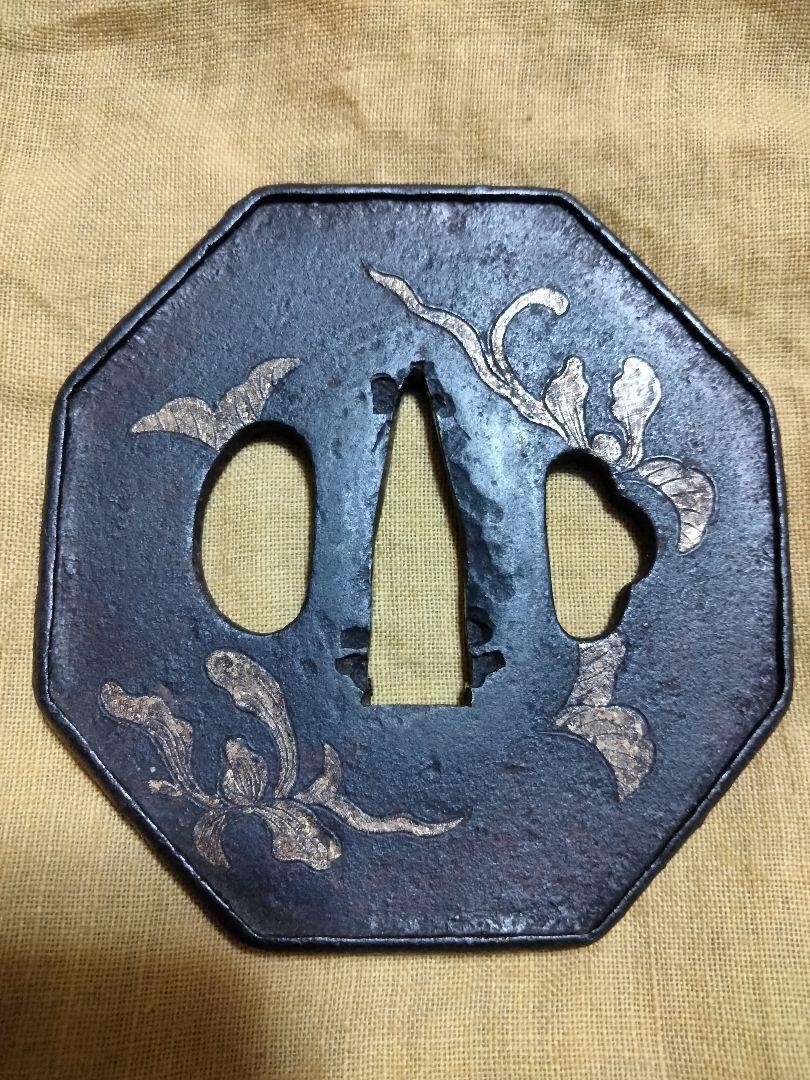

Brian Posted December 30, 2023 Report Posted December 30, 2023 This one is confirmed as Mid Edo Jingo and Kiku theme. No relation to the Imperial family 4 Quote
Guest Simon R Posted December 30, 2023 Report Posted December 30, 2023 Optimism is a fine quality in moderation. Quote
Soshin Posted December 30, 2023 Report Posted December 30, 2023 On 12/30/2023 at 9:18 AM, Brian said: This one is confirmed as Mid Edo Jingo and Kiku theme. No relation to the Imperial family Expand Thanks @Brian for sharing I really like that tsuba. I agree with Ito's call that it is the work of the third generation Jingo. The iron and treatment of the surface reminds me of a tsuba in my collection that the previous owner attributed to the third generation Jingo. My tsuba is signed (Jingo 甚吾). It doesn't have a chrysanthemum, so I am not going to post it. 1 Quote

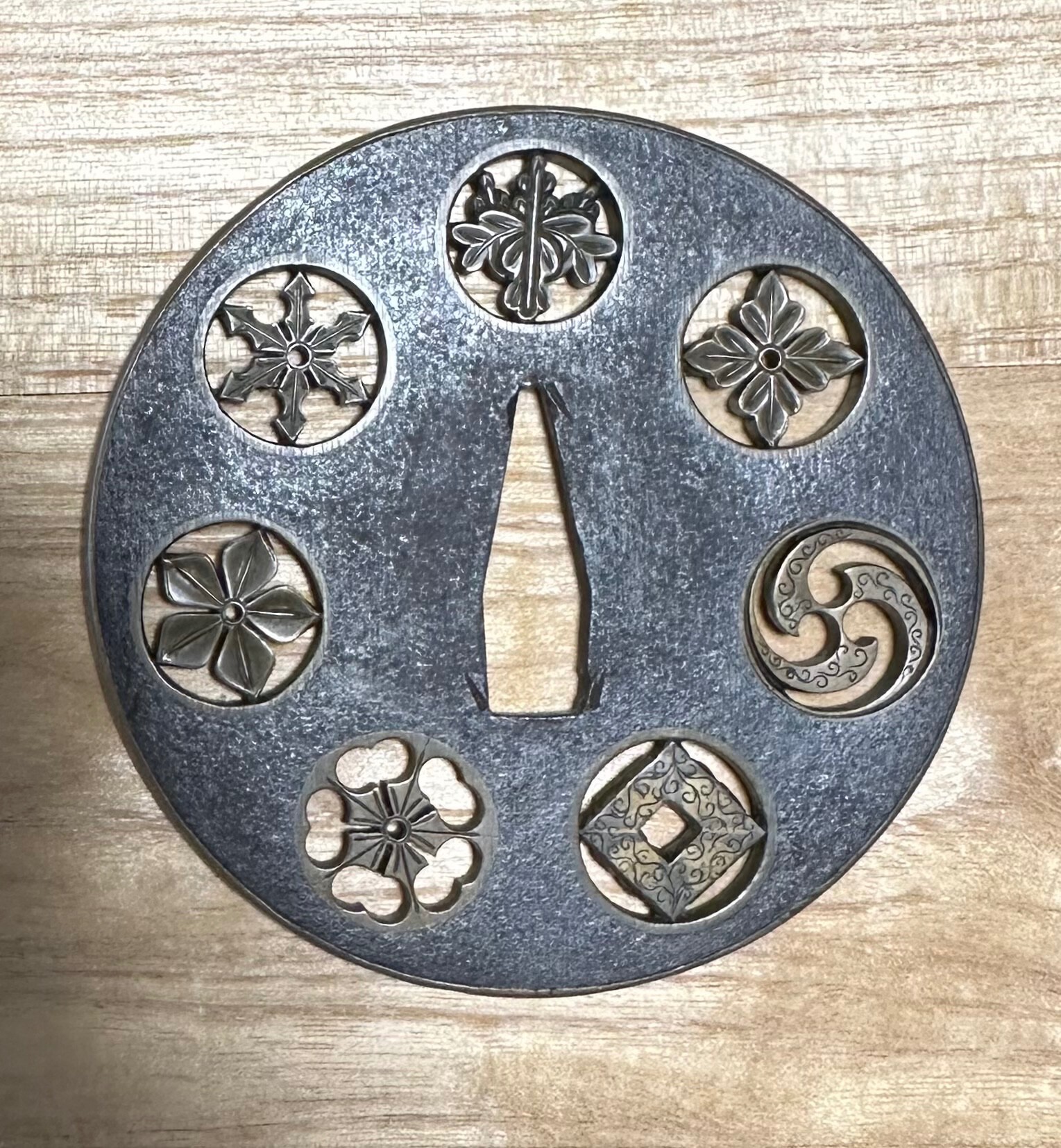

Soshin Posted December 30, 2023 Report Posted December 30, 2023 Thanks @Dan tsuba I agree. Some really intresting articles you linked with helpful information. Here is a tsuba with many famous family crests that are only partially visible on the tsuba. These family crests include the Oda (right), Toyotomi (left), and the Imperial Family (bottom right). The imperial Family is repeated on the other side in the (upper left). The tsuba was previously talked about on NMB because of the Japanese weasel design also on the tsuba on the side not shown. It has NTHK papers that date the tsuba to the early Edo Period circa early to mid 1600s CE. Better photos and more information can be found here: Tsuba Gallery #10 | Tsuba Otaku. It is the third tsuba from the top of the webpage. I still really enjoy this odd ball tsuba. 3 1 Quote

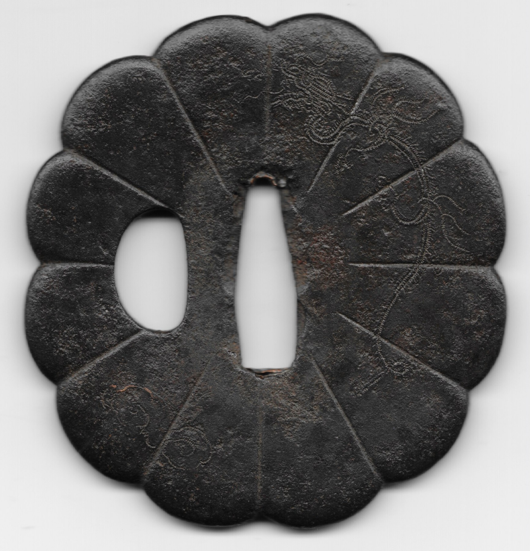

Dan tsuba Posted December 31, 2023 Author Report Posted December 31, 2023 Well, here Is an interesting kiku tsuba that I found on an old thread on the forum! What I find interesting about this particular tsuba is that there are two different kiku mon. The omote (?) has a 16 petal kiku mon and the ura (?) has a 12 petal kiku mon. The thread also gives some insightful information into the Jingo school. “Jingo tsuba” https://www.militaria.co.za/nmb/topic/10455-jingo-tsuba/ With respect, Dan 3 Quote

Dan tsuba Posted January 1, 2024 Author Report Posted January 1, 2024 Hello Simon! So, to quote what you asked me- “So Dan, what you seem to be driving at is that the tsuba in your possession could only have been owned by someone within - or closely associated with - the Japanese imperial family because of the 16 petal design. Is that correct?” No, my friend, that is not correct! At first, I thought that my 16 petal kiku tsuba could have been used by someone closely associated with the imperial family because the 16 petal kiku mon could only be used by the imperial family. But I was wrong (again!), although it continued my line of inquiry and investigation into the 16 petal kiku tsuba. I also discovered that the 14 petal kiku mon (tsuba?) was used by the imperial princes. Could some (or a few) extant 16 petal and 14 petal kiku tsuba have been used by the imperial family or someone closely associated with them? I think “yes”. I think that is a definite possibility and not completely unrealistic. However, how can one tell if it was used by the imperial family (or someone associated with them) or who used it? There is probably no way to confirm any such thing! The 16 (and 14) petal kiku tsuba are just another interesting area in the adventure of tsuba collecting! With respect, Dan 1 Quote

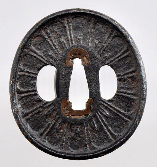

Dan tsuba Posted January 1, 2024 Author Report Posted January 1, 2024 As I stated in one of my previous posts, I am retired and enjoy digging around on the internet for tsuba information! Anyway, found something that may be of interest at the below link- https://varshavskyco...ction/tsu-0395-2019/ It is showing an early, around 1150 to 1200’s, tachi 14 petal kiku tsuba (that the individual petals may have at one time been complete?) which could indicate that this may have belonged to a prince of the imperial family. As the number of petals (14 in this case) could relate to the imperial family (as explained in a previous post) or it could just be a coincidence! Anyway, an interesting really old kiku type tachi tsuba for your enjoyment! Site is copyrighted, so I only provided the link. With respect, Dan Quote
Ford Hallam Posted January 2, 2024 Report Posted January 2, 2024 I think that we might have a very long and vigorous debate regarding the possible age of this alleged Tachi tsuba, Dan. I'd suggest that Mr Markhasin raises more questions and problems to his attribution than his attempt to justify it actually achieves. It's simply not reliable enough to base any sort of theory or speculation on. But the problem is, as always, if you are only reliant on internet material and have no access to more solid and scholarly reference books to examine these sorts of claims you have no way of evaluating their validity. I don't imagine there are many copies of the Tokyo Museum catalogue of early koshirae on the shelves of our membership for example. 1 Quote
