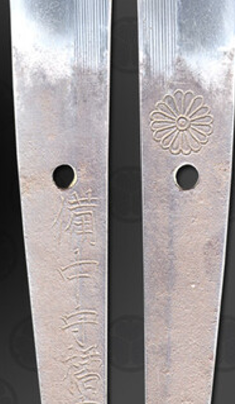

MaxMorelli Posted December 28, 2023 Report Posted December 28, 2023 Hi folks, I kindly request help from you, is this wakizashi a real WWII or before, handmade tamahagane blade? I really like to buy this but I'm not sure it is as they describe it. Do you have any suggestion? Thank you. Max Quote
John C Posted December 28, 2023 Report Posted December 28, 2023 Max: Nothing there suggests WW2. If it is real (need better pics or link to site), it would be much older. John C. Quote
Grey Doffin Posted December 29, 2023 Report Posted December 29, 2023 Hi Max, Bitchu no Kami and I can't see the rest of the mei well enough. Definitely an older blade but the nakago has been cleaned, the blade has been buffed, the tsuba is either cast or real low quality, and you need to know a lot more than you presently do before you start throwing your money away. I don't mean to be blunt but the fact that you don't know if this is WWII tells me you are a beginner and you should buy swords only from dealers you can trust 100%. On your own you're ripe for the picking. The more you know before you buy the happier you'll be with what you get; consider a good book.. Grey 3 Quote
Bugyotsuji Posted December 29, 2023 Report Posted December 29, 2023 橘 康広 Tachibana Yasuhiro (from the certificate?) 刀 銘 備中守橘康広/ホームメイト (touken-world.jp) 1 Quote
zuiho Posted December 29, 2023 Report Posted December 29, 2023 Do not buy this. I see why you think WW2. It is the ring on the wood saya that would sit under a leather cover. Maybe it started out that way. but, now this is a degraded blade with fittings either overly buffed on a wheel or outright fake. The tsuka ito is wrapped around the handle like newspaper around a fish. It is a recent horror. The tang, with rust removed , is the result of blundering abuse. The chrysanthemum may be an added fake. The saya has been coated with a finish that was added in modern times. It is now devoid of any historic or artistic merit. It hurts my eyes to look at it. Quote
vajo Posted December 29, 2023 Report Posted December 29, 2023 It looks like a fake Japanese sword. All parts incl. blade looks fake. If the blade is real it is in such bad condition it would not make sense to let it polish. 1 Quote

oli Posted December 29, 2023 Report Posted December 29, 2023 Hi Max, Did you buyed it? Are you new to nihonto? I am self i am a beginner and i wouldn't buy of this because of very poor condition or maybe fake. Regards Oli Quote
Geraint Posted December 29, 2023 Report Posted December 29, 2023 Dear Max. Things to look for: Reproduction tsuba with poor surface finish, odd assortment of seppa, almost always in pairs so an even number and of the same shape and material on an original koshirae, fuchi cast in one piece - genuine fuchi usually have a different metal base soldered in, hilt binding as already eloquently described above. The blade I think is Japanese and it has a quite nice habaki that may be silver foiled. The signature is questionable but the way the nakago has been treated is a disaster, destroying not only patina but also details of the signature. The same buffoon, (pun intended) also sanded up the blade destroying the sugata. My guess would be that someone had a blade with a saya and threw together the other bits, gave it a good old scrub and stuck it in the auction. For an understanding of how the nakago should look see the sword that Piers linked to, for other details see posts from Grey and William. Hope this is a start for you. All the best. 2 1 Quote
Matsunoki Posted December 29, 2023 Report Posted December 29, 2023 ….and as for the “expert” who valued it at €3-3300 (some guy called Sabbah)……what a joke! ……and I think the saya is home made! I really hope you didn’t buy it. Quote

Bruce Pennington Posted December 29, 2023 Report Posted December 29, 2023 In the seller's description, he lists the blade as 1700-1750, but the fittings as WWII. I agree with all the above. The blade looks legit, but horribly messed with, and the fittings are likely the result of a good intentioned Bubba wanting to "fix up" a sword with battered or missing parts. I have 5 Yasuhiro with kiku on file. He seemed to use a variety of kiku. The other one on file with this style looks quite similar, though this one is pretty coarsely cut. Can't speak to the mei itself. This one has a similar nakago shape 1 Quote

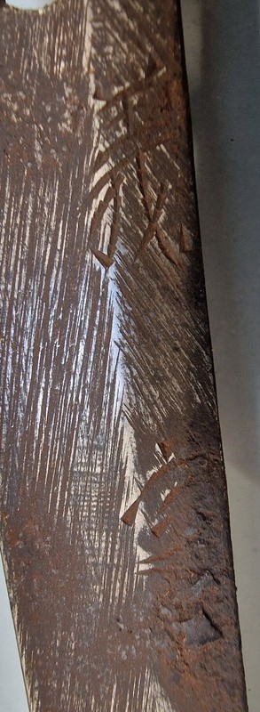

MaxMorelli Posted December 31, 2023 Author Report Posted December 31, 2023 Hi everybody, after 2 days I've found my tresoure, @oli let me know if you know the signature ;-P crazy 高橋義宗 It's incredible, I spoke with the guy in the auction and then I found this in his collection.... 2300€ 1 Quote

Conway S Posted December 31, 2023 Report Posted December 31, 2023 Hello Max, @MaxMorelli Do you have pictures of the actual signature on the sword? The characters you provided are Takahashi Yoshimune. There is a Seki stamp on the tang and the other characters are the date Showa 19 or 1944. I think you should request additional photos of this sword to confirm the signature is accurate. I think this smith is normally associated with higher quality swords as opposed to non-traditionally made oil-quenched blades. On 12/31/2023 at 3:11 PM, MaxMorelli said: 高橋義宗 Expand Conway Quote
MaxMorelli Posted December 31, 2023 Author Report Posted December 31, 2023 On 12/31/2023 at 3:43 PM, Conway S said: Hello Max, @MaxMorelli Do you have pictures of the actual signature on the sword? The characters you provided are Takahashi Yoshimune. There is a Seki stamp on the tang and the other characters are the date Showa 19 or 1944. I think you should request additional photos of this sword to confirm the signature is accurate. I think this smith is normally associated with higher quality swords as opposed to non-traditionally made oil-quenched blades. Conway Expand Yes sorry, wrong pic, here it is... Quote
MaxMorelli Posted December 31, 2023 Author Report Posted December 31, 2023 On 12/31/2023 at 3:42 PM, oli said: You mean the Seki Stamp gunto is a Takahashi Yoshimune? Regards Oli Expand No sorry, wrong side picture Quote
Conway S Posted December 31, 2023 Report Posted December 31, 2023 The signature could be Yoshimune, but the bottom character is a little obscured by the rust. I would post this again in the translation section since this thread was originally for a different piece... your questions may be overlooked here. Conway 1 Quote
MaxMorelli Posted December 31, 2023 Author Report Posted December 31, 2023 On 12/31/2023 at 3:58 PM, Conway S said: The signature could be Yoshimune, but the bottom character is a little obscured by the rust. I would post this again in the translation section since this thread was originally for a different piece... your questions may be overlooked here. Conway Expand Thank you for this Convay! Quote
Bruce Pennington Posted December 31, 2023 Report Posted December 31, 2023 Date correction: Showa 17, so 1942. 1 2 Quote
