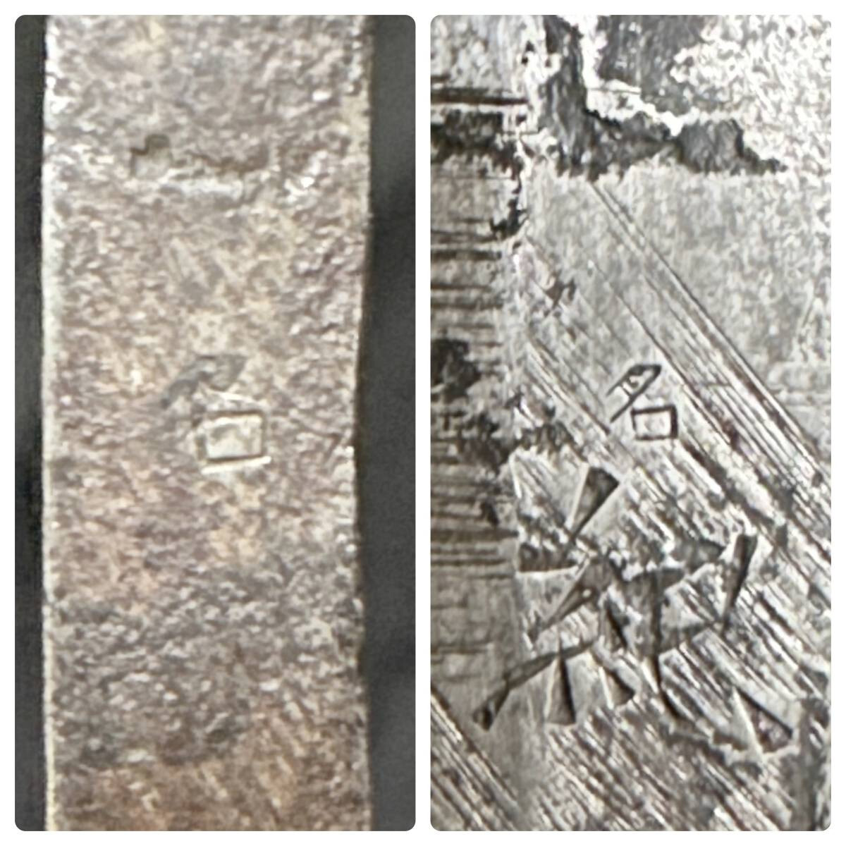

There was a Kunitada, real name Ikeda Shimeyoshi 池田〆吉 who is listed as a Seki smith. This same person is listed as a student Kato Sukekuni who was in the Kato family of smiths from Meguro, Tokyo, so it is likely he trained with the Kato family and moved to Seki where the demand for smiths and the production of gunto was high.
The blade shown below has the Nagoya stamp consistent with blade coming from Seki but the workmanship is more in line with (kesho yasuri-me, etc.) the style of the Kato group than that of those of Seki. He probably didn’t train for very long under Kato Sukekuni as the workmanship seems a little on the crude side.

My best guess is that Ikeda studied, likely briefly, in Tokyo under Kato Sukekuni, taking the Kuni kanji from Sukekuni for his mei. As I said earlier, his workmanship resembles more closely that of the Kato group than what is commonly seen from Seki smiths in that period.
