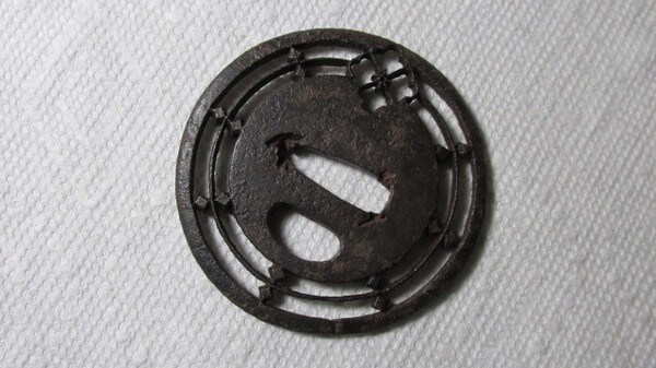

The mimi is bent and split in one area (pictures also shown below).  It looks to me like it could have been struck hard (maybe with a sword?).
Any opinions and thoughts on the split (or cracked) mimi??

Yes, in most cases you will find an irregularity in the material which is/was the reason for failure. In designs like this where the MIMI is almost separate from the TSUBA plate, a certain tension may occur. An impact from a blow can cause the weakest spot to crack. See another sample:
  • Like 4
Yes, you might call it HAGIRE or - as Brian proposes - MIMIGIRE. But HAGIRE occur in the quenching of a steel blade, while in TSUBA we have no quenching. So we have to think of other causes for cracks. Some TSUBA designs may be more vulnerable than others.
55 minutes ago, Spartancrest said:
 ....These might have cooled off too fast.
Dale,
I don't think so, as they are left in the mold until they can be handled. It is more the brittleness of the material itself, and again we have here another TSUBA with an almost "free" rim. That might make it more vulnerable as well because tensions in the material can be stronger than the narrow MIMI.
Is that a CHINESE or NANBAN related TSUBA?
This is why there are several old documents state specifically that large sukashi are to be avoided, or that sukashi tsuba should be thick.
  • Like 4
