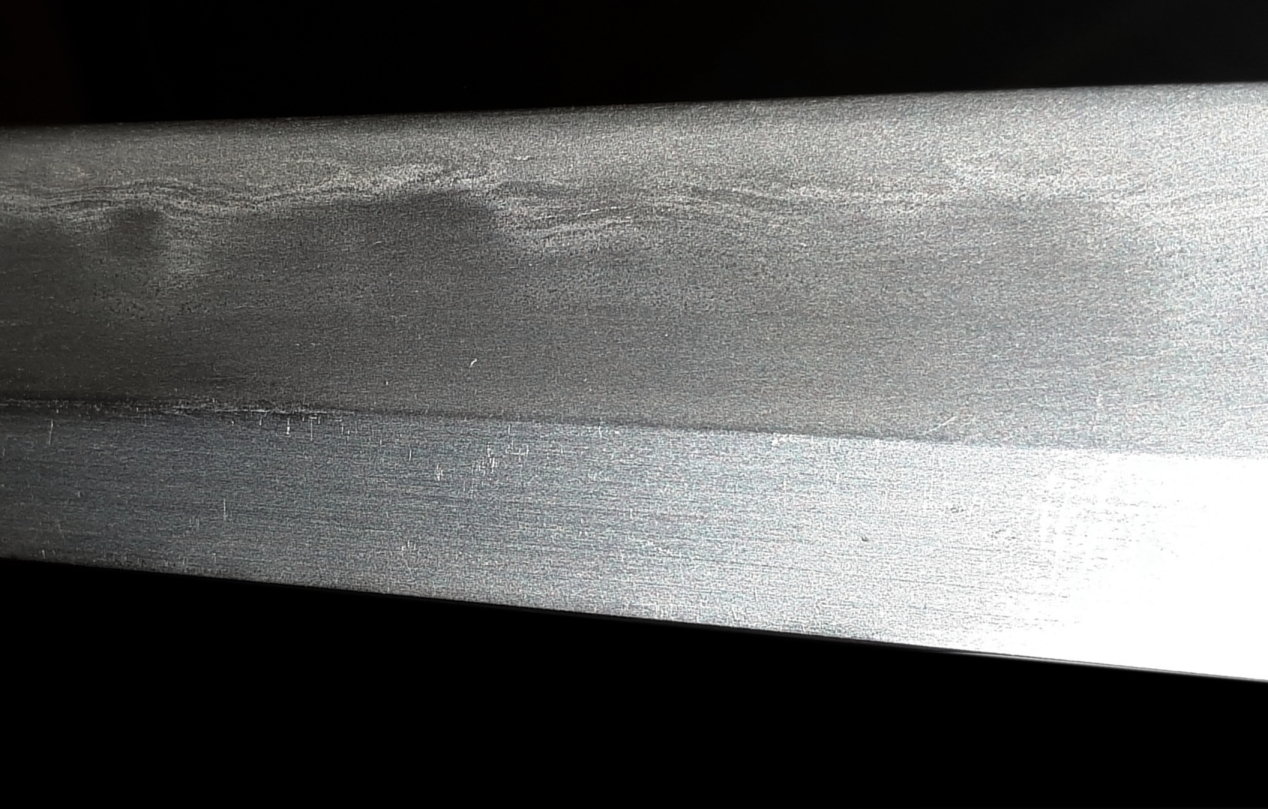

DoTanuki yokai Posted December 7, 2023 Report Posted December 7, 2023 Sunagashi on my Ko- Uda at different places and different light. 1 Quote

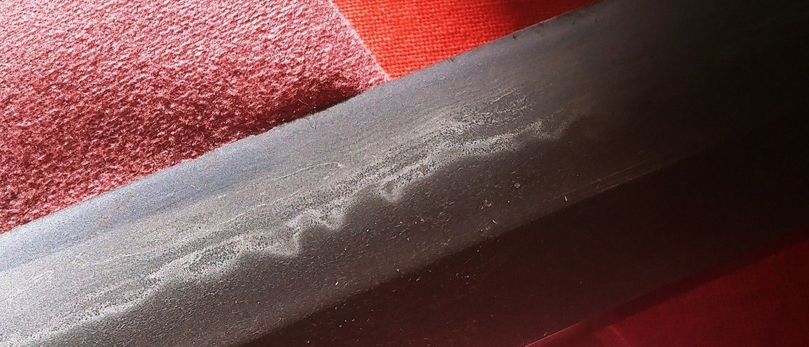

Andi B. Posted December 7, 2023 Report Posted December 7, 2023 That's how sunagashi look on my Shiga-Seki blade: 1 Quote
