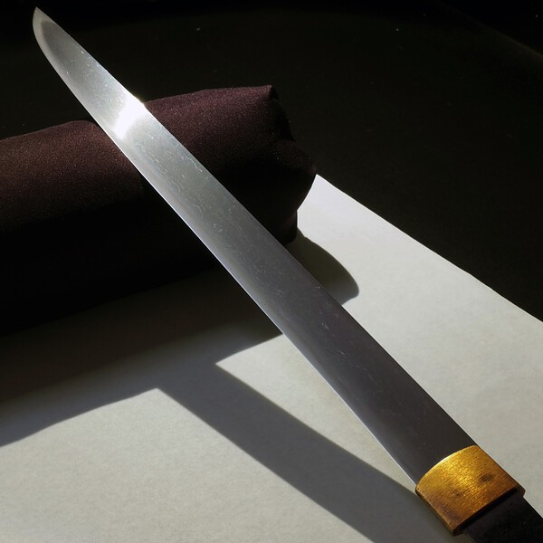

Soshin Posted December 11, 2023 Report Posted December 11, 2023 I never had a Ko-Uda work in my collection. I once had in my collection a mumei tanto with an attribution to "Den Uda Kunimune". The NTHK date the tantō production to the (Tenbun 天⽂) era of the late Muromachi Period (室町時代後期) circa 1532-1555 CE. Based upon the workmanship the maker of this tantō was likely the 4th generation Kunimune found in Japanese Swordsmith Revised by W. M. Hawley ID# KUN655. 1 Quote
