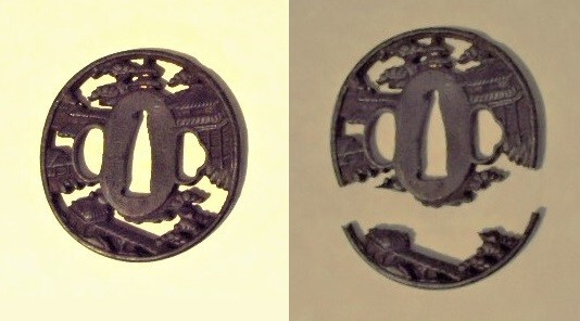

Spartancrest Posted November 30, 2023 Report Posted November 30, 2023 Number four is unfortunately a cast piece. Sorry 1 Quote
George KN Posted November 30, 2023 Author Report Posted November 30, 2023 Thanks @Spartancrest, that makes an awful lot of sense actually - I wondered why the colour was different from the others, as well as the lack of fine detail. Does that mean you think the other three are genuine antiques then? Even 2. with its strangely off centre hole? Quote

Spartancrest Posted December 1, 2023 Report Posted December 1, 2023 On 11/30/2023 at 11:04 PM, Ghoul414 said: Does that mean you think the other three are genuine antiques then? Even 2. with its strangely off centre hole? Expand Yes the others appear genuine to me, though I have seen dozens of number 3 as cast copies, yours is the real deal. Another 'Akasaka' one here http://www.nihonto.us/AKASAKA KIRI TSUBA.htm if you notice the price, imagine what yours could be worth with a little cleaning work! Another auction piece with some gold nunome https://www.jauce.com/auction/e1113251200 or https://page.auction.../auction/e1113251200 Also a papered piece https://www.jauce.com/auction/1049690563 or https://buyee.jp/ite...o/auction/1049690563 Number 2 may have been mounted two or more times, when you analyse the image there is only one section where too much metal has been removed. The tagane-ato [punch mark] has pushed the nakago-ana back to a central position. You could fill that void with some sekigane/ategane but if a seppa was placed over it you wouldn't notice it at all. Number 1 is "Gunbai" or war fans similar to this site https://world.seiyud...m/product/tu-350115/ from memory we have had a thread on this design before and perhaps someone can find it? Cast junk, part of a "buy in bulk" auction https://www.jauce.com/auction/k1115533175 I would not despair over the cast 'peapod' tsuba, this one is better but still cast and part of the Auckland War Memorial Museum [NZ] collection - many museums harbor cast guards Ebay had one - somewhat overpriced! https://www.ebay.com/itm/225703612364 6 1 Quote

Spartancrest Posted December 1, 2023 Report Posted December 1, 2023 On 12/1/2023 at 8:27 PM, Ghoul414 said: I know 4. is cast, but I'm still interested in when would it have been made? Early 1900s tourist piece? Expand This question will likely get you lynched in certain circles [you and me both!] I suggest you look at https://www.militaria.co.za/nmb/topic/38416-tsuba-casting-molds/ If you like having a weekend to do some reading On 12/1/2023 at 8:27 PM, Ghoul414 said: none of the examples you've linked have a filled kogai hitsu-ana (if I've not got that right, I'm referring to the cloud shaped hole) - does it mean something that mine does? Expand The filled hitsu [Ategane or Ume] looks to be Shakudo [gold/copper alloy] so a little 'up-market'. It simply means that the guard was fitted to a saya that didn't have the slot for a Kogai and the hole in the tsuba was filled because it could not be used - [it still eludes me why they went to the trouble in many cases] There is a theory that the plugs were made of precious metals as 'emergency cash' but that would not cover the many made in lead. Also just how much gold would there be in the Shakudo? 3 Quote

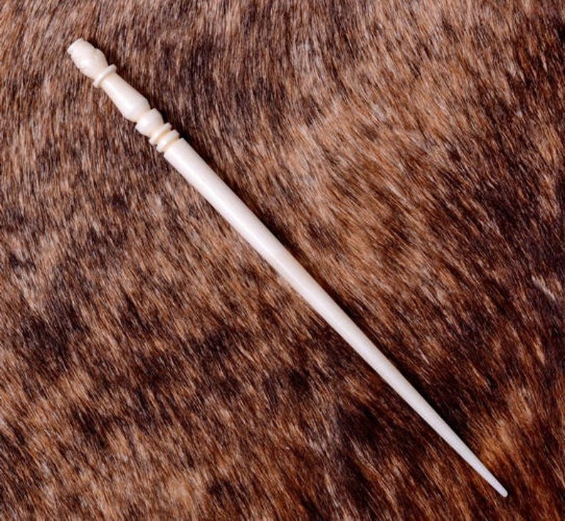

George KN Posted December 10, 2023 Author Report Posted December 10, 2023 Thanks @kissakai, and funnily enough I am already planning to make some bone picks/awls, to see if they are able to remove some of the more stubborn rust in the more awkward spots. I've actually got the beef bone from the butcher sitting in my fridge already, so I'll let you know how it goes once I make them 🙂 1 Quote
Spartancrest Posted December 11, 2023 Report Posted December 11, 2023 I made a few bone picks - even went so far as to use some "Ito" for a comfortable grip! 4 1 Quote
ROKUJURO Posted December 11, 2023 Report Posted December 11, 2023 Dale, good tools are essential for good work! 1 1 Quote
Spartancrest Posted December 12, 2023 Report Posted December 12, 2023 https://www.etsy.com...-hair-pin-of-bone-17 This looks well made - no idea how big it is though. Quote

Spartancrest Posted January 24, 2024 Report Posted January 24, 2024 https://www.jauce.com/auction/b1122424851 another pea pod casting, they turn up pretty regularly. 1 Quote

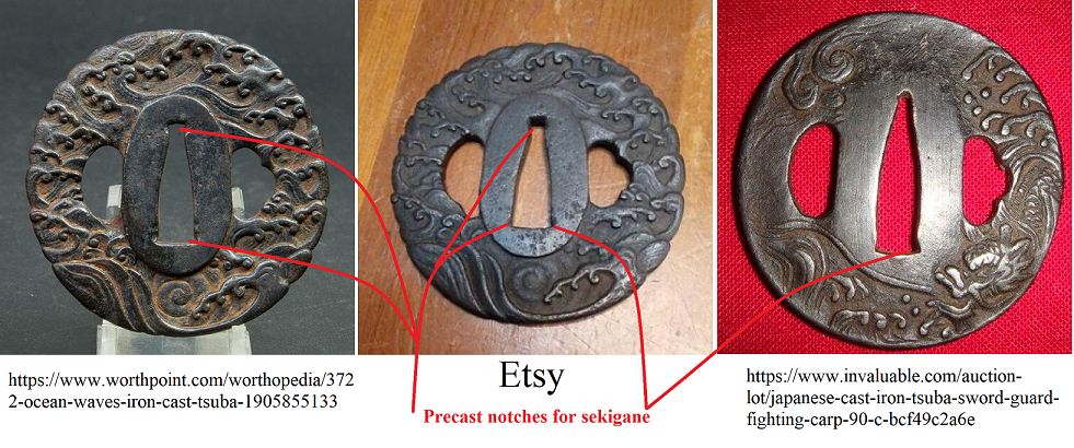

Spartancrest Posted January 24, 2024 Report Posted January 24, 2024 On 1/24/2024 at 9:12 AM, Ghoul414 said: It is interesting that one looks like it has been mounted though. Expand You would be surprised the number of cast guards that have sekigane and have been mounted, there is a lot that have precast cut outs at the base of the nakago-ana in particular so sekigane can be added, the pea tsuba you have has them. Which was another giveaway that it was cast. Many of course have cast in tagane-ato just to give the illusion they were mounted. even one of mine! 2 Quote
