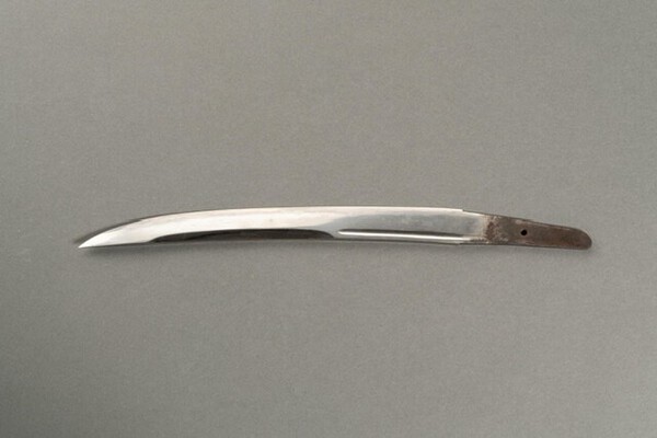

Alexander_R Posted November 30, 2023 Report Posted November 30, 2023 Hello! I again asking for your opinion about my recent acquisition tanto/aikuchi. Nagasa length is 29 cm. No info available except is Edo. 2 Quote

Rivkin Posted December 2, 2023 Report Posted December 2, 2023 Nakago photo with decent light would help. Quote
Alexander_R Posted December 2, 2023 Author Report Posted December 2, 2023 Tried to do my best. May be it helps? Another question. Tanto is not sharp. Is it normal? 2 Quote
Bugyotsuji Posted December 2, 2023 Report Posted December 2, 2023 It is not normal if there is no sharp cutting edge. If the edge has been removed, it could be that the blade was not legally registered in Japan, and this was an attempt by someone to legalize it, or make it less illegal in case it was discovered in transit abroad. Quote
Rivkin Posted December 2, 2023 Report Posted December 2, 2023 It looks like nakago was patinated, yasurime is deep and well spaced, so its something recent, either shinshinto or gendai, which is consistent with the overall type, they are usually not too old. I would feel more comfortable with shinshinto but its hard to say. The forging is traditional and there is an intention to have koto feel. If one wants to assign a school to it, "Mino" can be the case, but since its a late work this would be a stretch of sorts. Quote
Davis Posted December 2, 2023 Report Posted December 2, 2023 I once owned two tanto that were almost identical to yours. Also over the years I have encountered a good number of others, very similar, almost generic. I've concluded probably wrongly, that they were produced and put together in large numbers in a specific region during a very narrow time frame, (Meiji)? With all the examples I've seen the hilts were beautifully wrapped and always very well preserved, perhaps indicative of age? Quote
Alexander_R Posted December 2, 2023 Author Report Posted December 2, 2023 Could it be late Edo? The auction description was as follow: A TANTO IN KOSHIRAE, EDO Japan, Edo period (1615-1868) The blade: The slender, gently curved blade with unokubi-zukuri, ihori mune and a short ridge on both sides. The hamon is toran in nioi-deki with ko-ashi. The hada is ayasugi-muji, ending in omaru boshi. The mumei (unsigned) nakago with one mekugi-ana, the tip is haagari. The mounting: The sentoku hamidashi tsuba (with two open hitsu-ana), the fuchi, kashira, kogai, kozuka koiguchi, and kojiri each worked in silver takazogan and hammered decoration. The menuki depicting birds. The rayskin tsuka with a black silk tsuka-ito. The saya is lacquered in roiro and red with butterflies and a peony bloom. NAGASA 29 cm, LENGTH 46 cm (total) Condition: Good condition with minor wear and traces of use, the blade with scattered tiny fukure and shallow scratches. The mounts with few minuscule nicks. Provenance: Hungarian private collection. 1 Quote

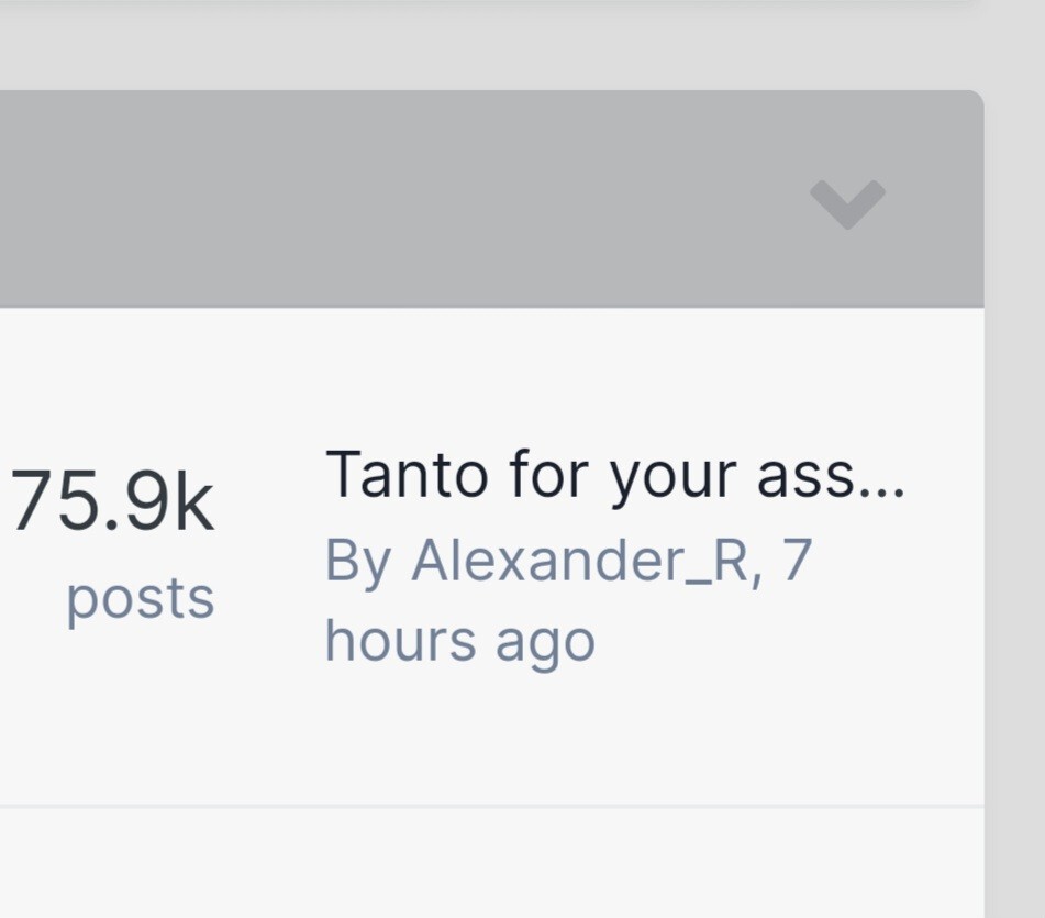

PNSSHOGUN Posted December 2, 2023 Report Posted December 2, 2023 Unrelated but the title was rather unfortunately cut off: 8 Quote
Rivkin Posted December 3, 2023 Report Posted December 3, 2023 10 hours ago, Alexander_R said: Could it be late Edo? The auction description was as follow: Most likely yes. Quote
Alexander_R Posted December 3, 2023 Author Report Posted December 3, 2023 Tanto sharpness. The strange thing is that form kissaki 5-7 cm of the blade is medium sharp but the rest of the blade is dull. May be they saved money on polishing? On 12/2/2023 at 1:30 PM, Bugyotsuji said: It is not normal if there is no sharp cutting edge. If the edge has been removed, it could be that the blade was not legally registered in Japan, and this was an attempt by someone to legalize it, or make it less illegal in case it was discovered in transit abroad. Quote
Matsunoki Posted December 3, 2023 Report Posted December 3, 2023 Another possible reason for a blunt section on the blade is that it was very quickly reshaped to remove shallow chips without bothering to repolish it properly. This late style of simple koshirae often utilised older blades (sometimes poor quality) that could be tidied up and sold to the sometimes over enthusiastic gaijin that were present in Japan in the Meiji period. 1 Quote

Alexander_R Posted December 4, 2023 Author Report Posted December 4, 2023 If this version is true that means that the blade is made earlier? Quote
Alexander_R Posted December 4, 2023 Author Report Posted December 4, 2023 On 12/3/2023 at 7:46 PM, Matsunoki said: Another possible reason for a blunt section on the blade is that it was very quickly reshaped to remove shallow chips without bothering to repolish it properly. This late style of simple koshirae often utilised older blades (sometimes poor quality) that could be tidied up and sold to the sometimes over enthusiastic gaijin that were present in Japan in the Meiji period. If it is the right version, we can suppose that the blade was made earlier? Quote
Matsunoki Posted December 4, 2023 Report Posted December 4, 2023 45 minutes ago, Alexander_R said: we can suppose that the blade was made earlier? In my opinion, yes, the blade is pre Meiji. Quote
