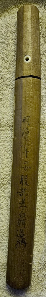

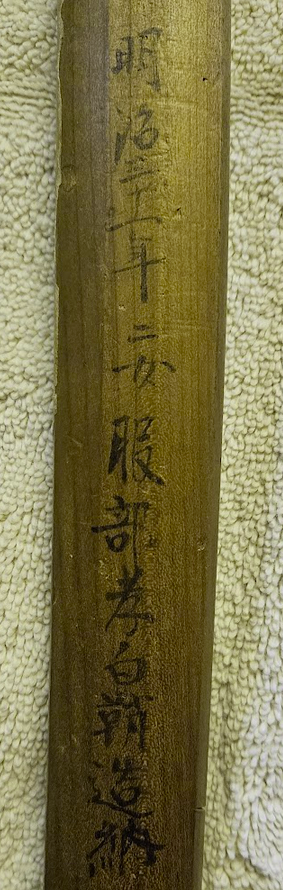

Dispo Posted November 8, 2023 Report Posted November 8, 2023 My in laws were moving and asked if I wanted some "knives". The " knives consisted of one civil war Calvary sabre, a brass french bayonet and this "sword". I literally know nothing about it. i thought it was WWII possibly and showed someone, he was thinking it was a bit earlier. Any info, translation or background info would be greatly appreciated. I have lot of photos but the upload size limit is constraining me. I can provide more on request. Thanks in advance Dispo 2 Quote
Dispo Posted November 8, 2023 Author Report Posted November 8, 2023 I do know that it is missing the bamboo insert. But that is about it! Quote
Ray Singer Posted November 8, 2023 Report Posted November 8, 2023 This is a very nice thing to receive. It is a very old koto, Muromachi period blade signed Hakushū / Hoki ju Hiroyoshi. Quote
Ray Singer Posted November 8, 2023 Report Posted November 8, 2023 The date is either Eisho or Tensho 10. Eisho / Tensho ju nen ni gatsu hi. Quote

Ray Singer Posted November 8, 2023 Report Posted November 8, 2023 See below for a link that will help you with your research. Please do not do anything to clean or polish the blade on your own and most especially do not remove any of the rust from the tang (nakago). Readability is fine as it is and it is very important to preserve the patina in that area. https://nihontoclub.com/view/smiths/meisearch?order=field_smith_start_era_value&sort=asc&type=All&mei_op=contains&mei=廣賀 2 Quote
