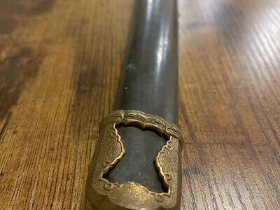

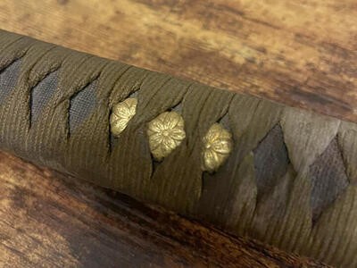

John C Posted November 8, 2023 Report Posted November 8, 2023 It's what we call a "souvenir" sword. Post war for the 8th Army PX; sold to US soldiers and sailors. Still some discussion as to whether or not the blades used were surplus or made specifically for the souvenir. Search NMB for "souvenir" for further info. Note the kabutogane and menuki are Army, while the blade is navy. The tsuba is a larger version of the army tsuba. John C. 1 Quote
