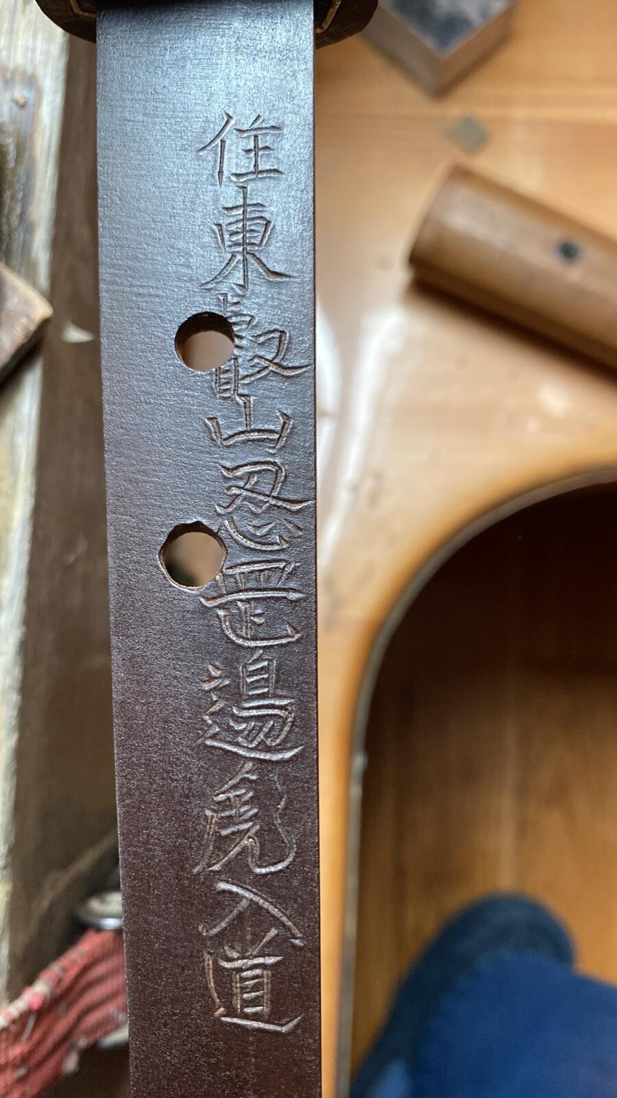

wakiboy Posted November 7, 2023 Report Posted November 7, 2023 Dear members A friend asked me to read a Mei for him which he was struggling with. I read this as “Ju Toeizan Shinobigaoka no Hotori Ko Nyudo” which I believe is a late Mei of Kotetsu. Unfortunately I am unable to find any examples of this Mei. On studying the Mei it appears to be very thickly struck but most of the Kotetsu Mei I found are thinner in comparison. is there a possibility that this is a “Kajihei” fake? Any information is appreciated. Many thanks Ian Quote
Ray Singer Posted November 7, 2023 Report Posted November 7, 2023 I don't know that Kajihei is responsible, but this does not appear to be an authentic inscription for Kotetsu. Best regards, Ray 1 Quote

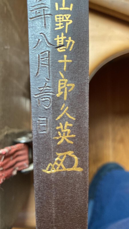

Bruce Pennington Posted November 7, 2023 Report Posted November 7, 2023 I have several cut test mei of Hisahide, over 3 decades, and the kao on this one is pretty crude in comparison and innaccurate in places. 1668 1675 1686 Quote

ckaiserca Posted November 7, 2023 Report Posted November 7, 2023 On 11/7/2023 at 2:26 PM, Bruce Pennington said: I have several cut test mei of Hisahide, over 3 decades, and the kao on this one is pretty crude in comparison and innaccurate in places. Expand I was thinking that it looked like someone went at that Nakago with a gold paint marker... Quote
Bruce Pennington Posted November 7, 2023 Report Posted November 7, 2023 On 11/7/2023 at 5:40 PM, ckaiserca said: gold paint marker.. Expand Oh, I think you're right! The horizontal lines in the gold kanji match up with the horizontal yasurime! Quote

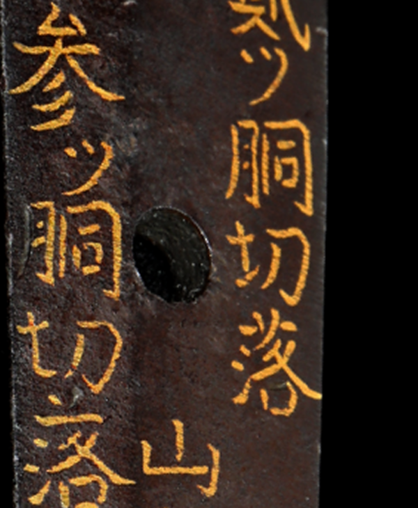

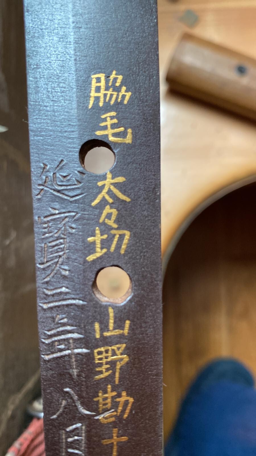

vajo Posted November 7, 2023 Report Posted November 7, 2023 Charles and Bruce are right. Its painted. incredible. Btw: Bruce the yasurime lines are ok when you see it in the inscription. The inscription is made after the yasurime. The round edges is the point what makes me nervous. Her is an original cutting test signature. you can see the difference and the parts where the gold falls out. Quote
DoTanuki yokai Posted November 7, 2023 Report Posted November 7, 2023 It’s inlaid and filed on surface level with the Nakago, what is normal. the picture shows that some of the inlay fell out 1 1 Quote

Mikaveli Posted December 7, 2023 Report Posted December 7, 2023 On 11/7/2023 at 1:06 PM, wakiboy said: Expand Aside from the gold paint marker, the inscription doesn't appear to have been written by a native speaker of Japanese (or any country with Kanji). When a westerner copies a character like 山 they tend to see 4 lines, and draw 4 lines. Without knowing the typical number of strokes used, the result is far from convincing. Quote
