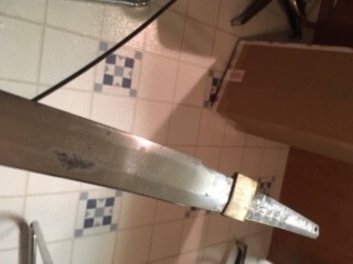

Bruce Pennington Posted November 1, 2023 Report Posted November 1, 2023 We got to discussing this on the Edo thread, so I thought I'd start a new one to avoid sidetracking that thread needlessly. @Bugyotsuji has posted a statement from someone: "Despite some discolourings and one ‘spiderweb’ rust(?) nest, he and a smith who was watching both agreed that it will clean up with other methods, short of Togi work. Use oil and alcohol (ethanol?) alternatively to lift and shift it, and clean it off with uchiko they said. “But the hiké cannot be helped…" I have a star-stamped gendaito by Kunitoshi with some black stains, and what I think is meant by spider-web stains that I would like to see if I could clean up, and was hoping to find out if this oil/alcohol combo would help. Anyone have any success? I am away from home for 2 days, so I'll have to use some old photos. I can update later with better ones. I realize a polish is the best solution, but now that I'm retired, it will be a long time from now before I have $2,000+ for it. 3 Quote
DoTanuki yokai Posted November 1, 2023 Report Posted November 1, 2023 What you have is much more then the „spider webs“ Bruce. Maybe I can dig up some old pictures later when I find time. The spider webs are some white staining that is not really visible from every angle but very prominent when looking at the Hamon of a blade. 3 1 Quote
Bruce Pennington Posted November 1, 2023 Author Report Posted November 1, 2023 Thanks, I'd appreciate that. These are the only 2 shots I have of the hamon at the moment. That finger print is not mine, and I don't recall if I've removed it, or it's permanent, but I'll find out when I get back home. 1 Quote

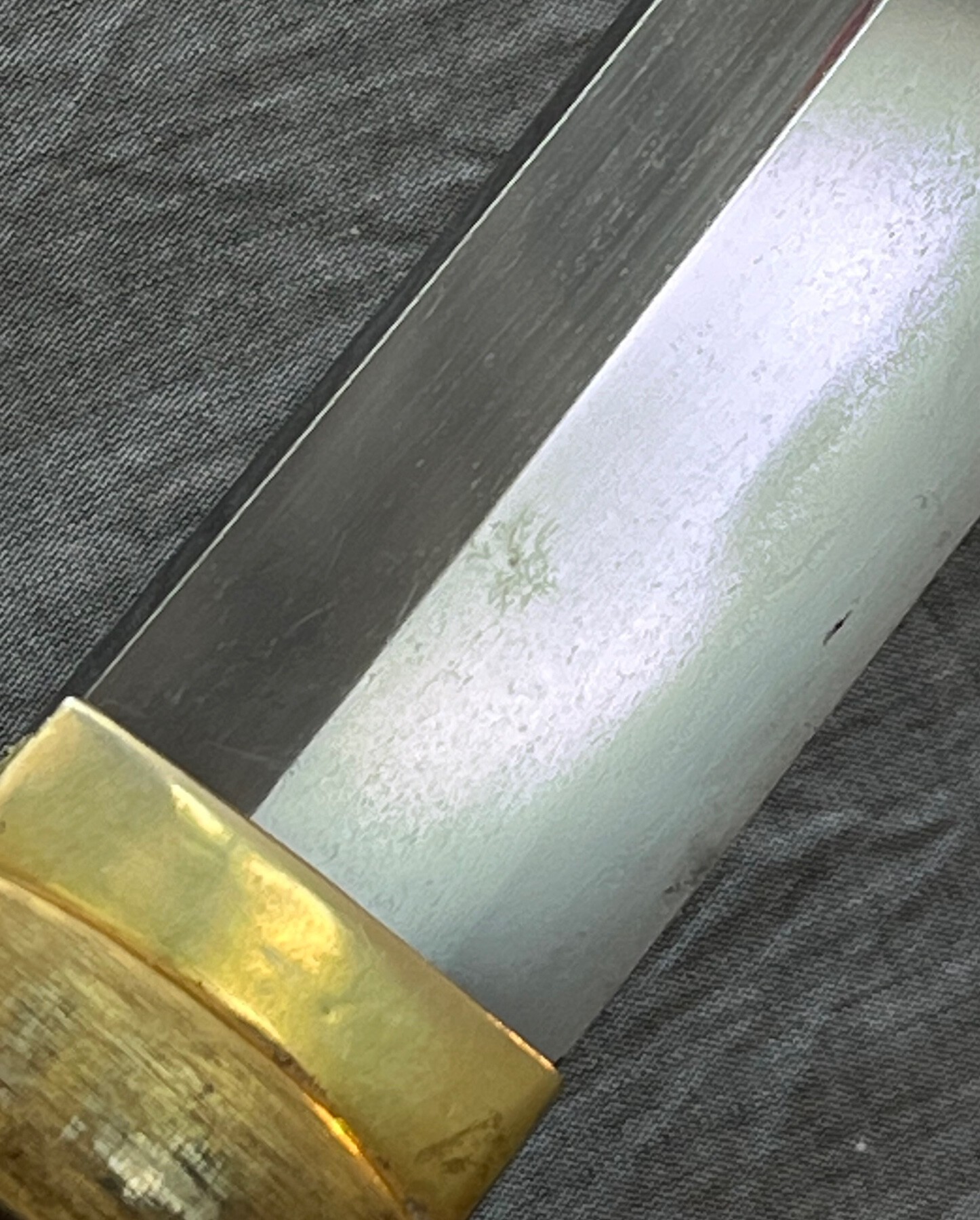

Bugyotsuji Posted November 2, 2023 Report Posted November 2, 2023 Guess I need to fess up n take some of the responsibility here, instead of leaving it all on Bruce’s shoulders. This is the original culprit that kicked off the discussion. Changes colo(u)r depending on the lighting. 1 Quote
1kinko Posted November 2, 2023 Report Posted November 2, 2023 You’ll better know more about blades than me, a fittings guy, but that looks like a blister due to polishing over an incomplete weld to me. My 1 1/2 cents. Quote
Bruce Pennington Posted November 2, 2023 Author Report Posted November 2, 2023 On 11/2/2023 at 3:41 AM, Bugyotsuji said: the original culprit Expand Dang Piers! That looks almost identical to the one in my first photo! 1 Quote

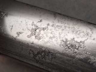

DoTanuki yokai Posted November 2, 2023 Report Posted November 2, 2023 Here is what I talk about and here is the same blade 2 years later with only regular maintenance with uchiko and oil. 3 Quote

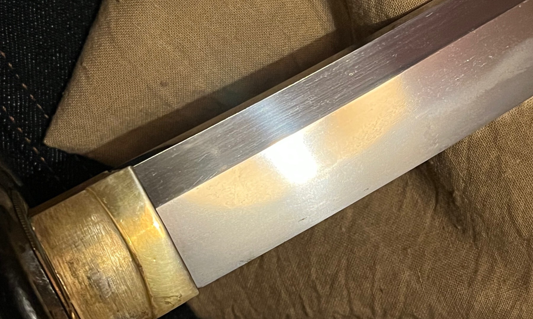

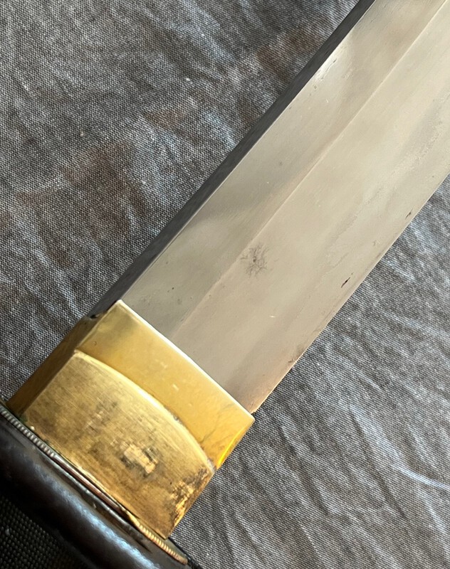

Bugyotsuji Posted November 6, 2023 Report Posted November 6, 2023 Update since the above. It does seem to be working. Same blade, same spider, but the spider just a shadow of its former self. 2 1 Quote
Stephen Posted November 6, 2023 Report Posted November 6, 2023 On 11/6/2023 at 10:58 AM, Bugyotsuji said: Update since the above. It does seem to be working. Same blade, same spider, but just a shadow of its former self. Expand Not reading all the way back. This change is from uchiko use? Quote
Bugyotsuji Posted November 6, 2023 Report Posted November 6, 2023 On 11/6/2023 at 12:04 PM, Stephen said: Not reading all the way back. This change is from uchiko use? Expand Yes, chōji oil and uchiko repetitions over the last week or so. Nothing else apart from the tissues. 3 Quote
