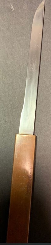

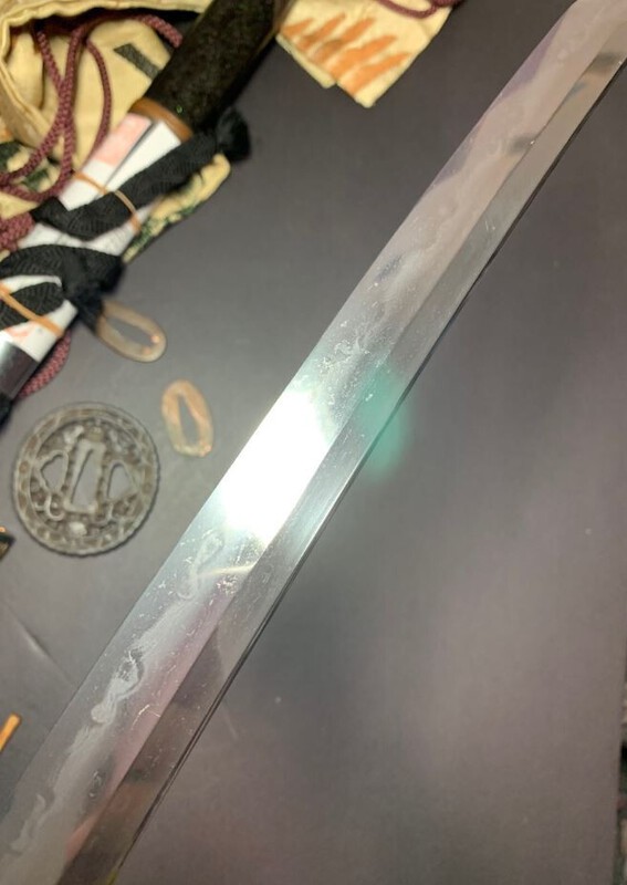

I have aquired an wakizashi
supposedly Edo period
Signature is Hizen no kuni ju Tadayoshi
Nagasa is 54 cm
Its my first antique Japanese sword, so i hoped to get a bit more info :)
Is it legit? I submiting for an NBTHK out of the question for example?
Bought it on the sbg forums

An authentic antique Japanese sword yes, but legit as in an authentic Tadayoshi I unfortunately don't think so. It is very common to see gimei blades sold out of Japan with only a torokusho and no papers, and sold unpapered for a reason (such as a questionable inscription).
Understood that the sword was bought at the SBG, but very likely before that it came out of Japan through an online auction.

What are the signs of Gimei here? Trying to learn as mutch as possible
Big name wakizashi sword going for cheap.
Seems the 1st timers go for the big fish story ,  Wakizashi was the most produced sword in Japan as "almost" everyone got to wear one.
The second character of the signature, zen of Hi-zen, is written the correct Japanese way, but the entire Tadayoshi family of sword smiths wrote that zen character slightly differently. Compare the second character of the signature on your blade with an authentic example of a Tadayoshi signature. In addition, the entire signature looks very crudely written and very angular, again compare with a genuine signature and you will see the difference. Other than the signature, it's a very nice looking authentic Japanese sword and a fine first blade for your collection.

To add somewhat to Patricius' response, with which I agree.  A mei essentially has a handwriting, a style of cutting.  The kanji might read the right thing but be cut in the wrong style or even using the wrong kanji, (compare the Kuni kanji with the example).  Add to that, certain smiths used particular forms of mei and one that falls outside that form is a red flag.  Other factors include the shape of the nakago and the nakago jiri, the yasurime, the position of the mekugi ana and the relationship between that and the mei, the alignment of the mei on the nakago and so on.  Many factors to study but after you have seen amany examples you begin to get a feel for what it should look like and if you have seen, handled and studied as Ray has then your instant response is quite likely to be the right one.  Note, this is all based on the nakago and mei, we haven't even started on the workmanship in the blade matching the smiths work!
Probably enough for now, here is one to compare, https://www.aoijapan...izen-kuni-tadayoshi/

The mei of the generations of the Tadayoshi school are well documented and this one is well outside of the range of what is expected from the mei of any generation of Tadayoshi. There are very large numbers of gimei Tadayoshi in the world, and a Tadayoshi with no papers being sold from Japan with only a torokusho should be treated with caution. You can see examples of Tadayoshi school mei here.
https://www.hizento.com/

I can see the diffrence, so gimei then
was not served any "big fish story" :) did not know the smith was that famous. Had probably been a red flag if i had known
The important thing for me is that the sword is a genuine Japanese blade :) Its my first nihonto, so i realy wanted a "study piece", that i could use to learn more
Other than the signature, how does the blade look?
One of the primary reasons for going with that sword was getting the "whole package". A blade with koshirae, swordbag and a kozuka

In kanteisho it's the sword that confirms the signature and not the other way around.
Based upon that premise why isn't this sword a Hizen-to?
Or is it?
And, if it is not a Hizen blade, then what is it?
