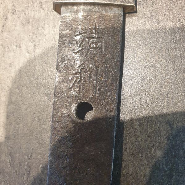

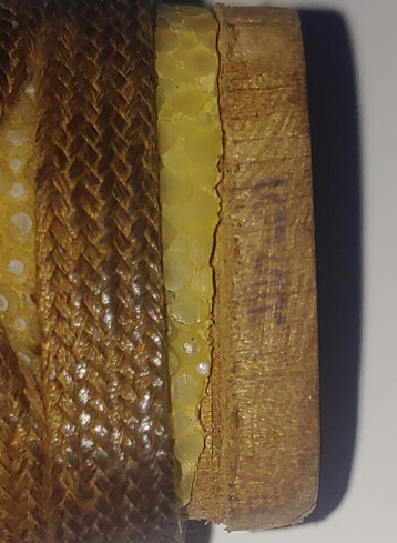

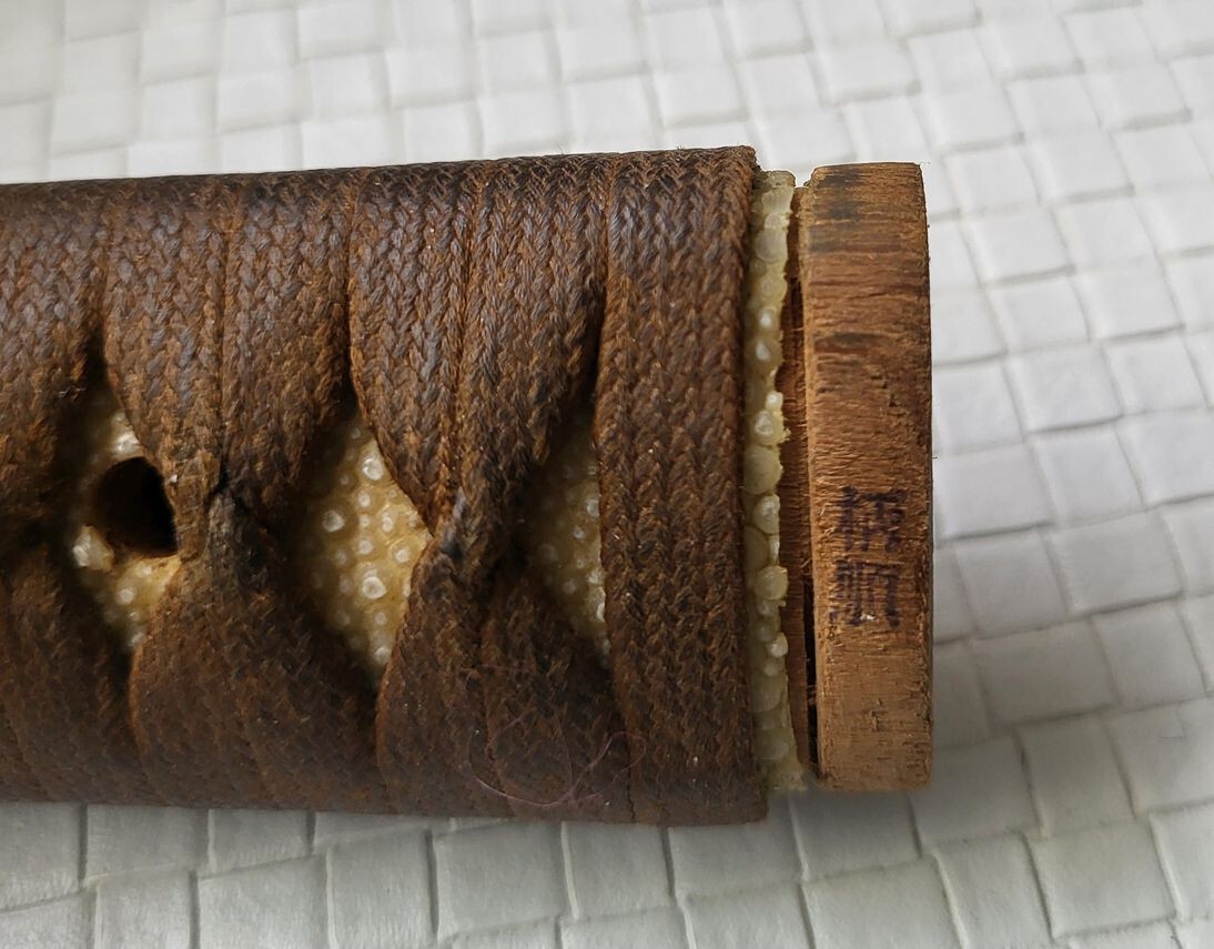

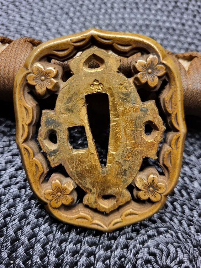

Two recent swords have piqued my curiosity around the markings found on swords of the Suya Shoten company, namely the following:
  • Kanji, Katakana or Japanese numbers scratched into the Seppa, Tsuba and Fuchi
  • Small ink stamp/writing in Kanji underneath the Fuchi
The curious part is the difference in these ink stamps, so far there have been two noted variations.
嶋田 - Shimada
柄順 - roughly "pattern order"
These swords share the following in common:
  • 1930's dated Type 94 pattern mounts
  • Mon
  • Good blades
  • Characters (surname, Japanese numbers, swordsmith)
So I ask those collectors with Suya stamped swords, (or swords with ink stamps under the Fuchi) to please check if any of the above are on your swords and report the below details in this thread.
  • Date of sword (if known)
  • Blade
  • Mon present
  • Any other unique features
20230915_000453_HDRcr.thumb.jpg.37b25fc1994f8f14d8bcd85638a893d3.jpgimage.png.8aa799c506035d9437a69ace66ddcf29.pngimage.png.60f742734c7d8a9ded9e1553718777f4.png

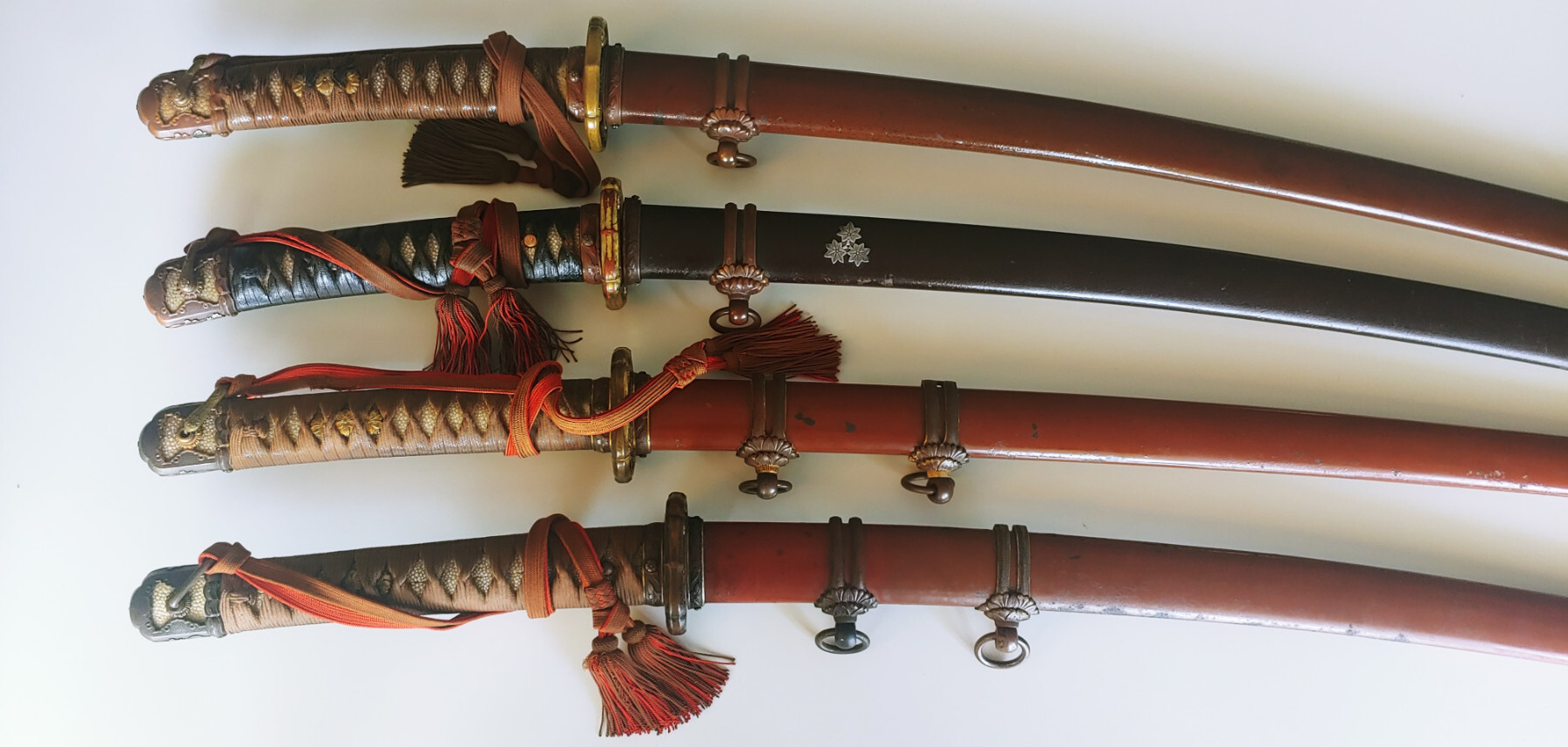

Not sure if this is of interest,  but this is whats on my Zohei-to that I thought was a fake blade. I asked about a while back. No Mon, or ink stampings but has a cord sarute.
20231028_221358.thumb.jpg.7274dffbffab348f94e3f1912c500f54.jpg20231028_221340.thumb.jpg.5fdee14f492dfcb70e7e6082228fc944.jpg20231028_221311.thumb.jpg.74d5db7c4e5374b8044a795c3c8b3e31.jpg20231028_221241.thumb.jpg.94757663ccef9658b513869080f71f00.jpg20231028_221211.thumb.jpg.4a05a40eac082f4548c9970ece7b478b.jpg

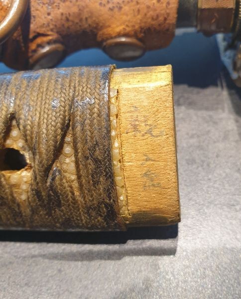

I have these two on file, but don't have the blade or anything else they came with and "エ" up by the Suya stamp:
162 マ
FB_IMG_1642198101297.thumb.jpg.300ae0875a10394818d3daa6f20e6987.jpg.b65de33ad3b0addbe67f849a4c406ecc.jpg
This set is numbered but I can't see any kana

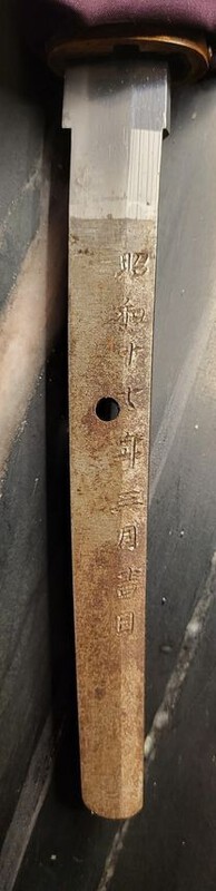

Carl with pleasure.
please enjoy, this is an extraordinary highest quality blade,super rare to find.
Kajiyama Yasutoshi Nagasa 69,9 cm with NBTHK Koshirae with Mon blade housed in shirasaya original war time first polish65ad92fc-579d-49a3-bec2-661000119a0f.thumb.jpg.cd1ccbb404c5188b07da39225753f0be.jpg
  • Love 1
Have seen so far :
4 long sword's (Tachi)
1 Tanto
 here on the board one Tachi, which is located in France
I would benice to see more blades by kajiyama Yasutoshi here on the board, especially complete with it's original Koshirae like this one.
obiviously not many collector's own one of his swords here on the web???
Han bing Siong told me many years ago, that he has looking for it, without succsess......
