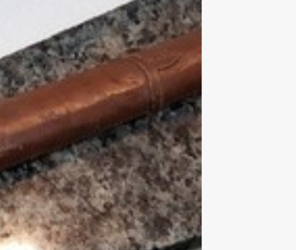

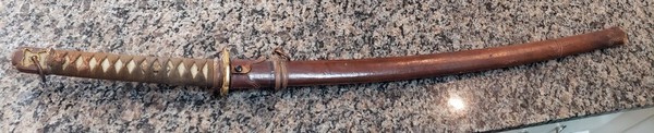

gbundersea Posted October 27, 2023 Report Posted October 27, 2023 This sword was brought back from Iwo Jima by a now deceased family member. Like many combat veterans, he did not speak of his experience there, so we know nothing about the sword. I carefully removed the tsuka. It has a single menuki, though the tang has two holes in it. The saya is covered with brown leather. There are no stamps or serial numbers on the blade. I attached pictures of the writing found on the tang. It has a cloudy hamon, and what appears to be a fine grain visible in the steel. Any and all translations, information, and thoughts will be most appreciated! Quote
Bruce Pennington Posted October 27, 2023 Report Posted October 27, 2023 Welcome Greg! Clearly, you have done some homework! Good job, dude. I cannot help with the smith name, but I can say the fittings are quality, custom. The original owner paid some extra cash to have this fitted out in a classy way. In fact, I have never seen this done quite like this, some similar, but not fully as good. 1 Quote
mywei Posted October 27, 2023 Report Posted October 27, 2023 Signed Bizen Kuni Norimune I think (unusually on both sides of the nakago) Not sure of authenticity or which Norimune this is, but regardless it will be an older blade More close ups of the blade and tip(kissaki) would help 4 Quote

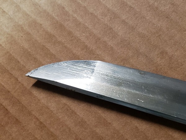

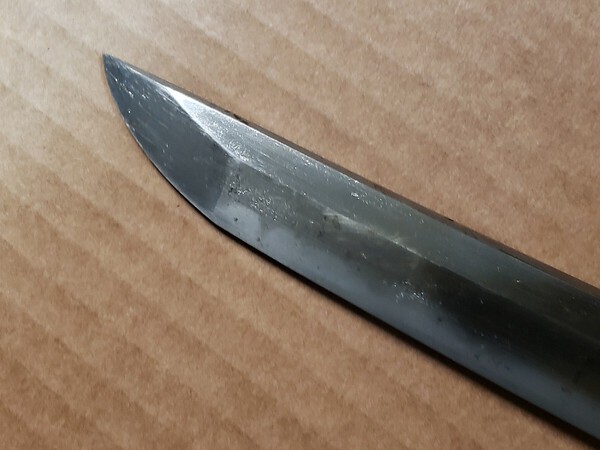

gbundersea Posted October 27, 2023 Author Report Posted October 27, 2023 Thank you, gentlemen, for the great info! Per your suggestion, I took additional pictures, concentrating on the blade and tip. Be aware that the blade does have a light sheen of oil on it, so some of the fine lines with show up in the photographs are likely the oil. However, I did carefully wipe clean about 4" of the blade closest to the habaki, using a lint free shop towel, so that area gives you a good idea of the true appearance of the steel, as shown in the first of these newest pictures. Quote

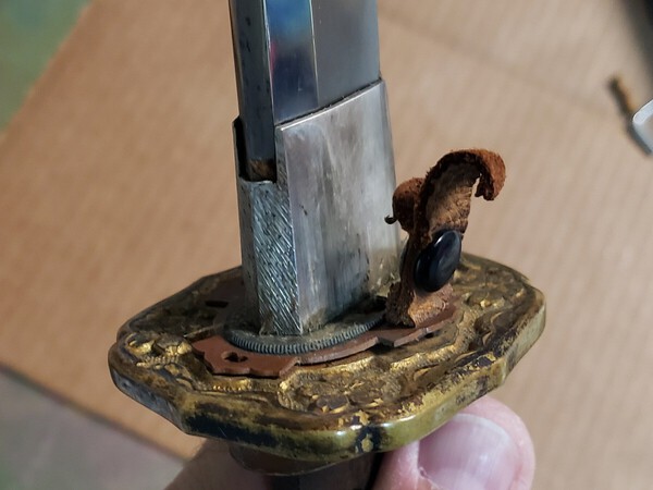

PNSSHOGUN Posted October 27, 2023 Report Posted October 27, 2023 The hanger looks like it could be removable, is the bottom hinged? Quote
Brian Posted October 27, 2023 Report Posted October 27, 2023 Decent older sword taken to war. Worth preserving. 1 Quote
Rivkin Posted October 27, 2023 Report Posted October 27, 2023 It does appear Bizen-like, has utsuri, definitely koto. It has potential. Can't comment on signature's validity, but what is seen is decent. If you are selling, would be interested in buying. Stylewise its also does not have the Muromachi vibe, there is a chance its older. 1 Quote
almeister Posted October 27, 2023 Report Posted October 27, 2023 Hi gb As is generally the case ... Better pics with no fittings ... Tip up /tang down (both sides ) ... Sectional areas from tip to lower tang .. Lower pic shows habaki/collar lòose fitting , but upper pic shows it not in correct place/dropped down ... Try better lighting/pics of boshi/tip as current pics seem to show area worked on at some stage and disappeared hamon ... ? Maybe , just my old eye's 👀 Cheers AlanK 🍺 Quote
Matsunoki Posted October 27, 2023 Report Posted October 27, 2023 On 10/27/2023 at 9:25 AM, almeister said: Lower pic shows habaki/collar lòose fitting , but upper pic shows it not in correct place/dropped down ... Expand I think that’s simply because the tsuka is not fitted thus all the fittings have slipped a bit. Can’t see any area worked on nor missing hamon…..I think the heavy smearing of oil is hiding a lot and giving wrong impressions. looks an old and interesting sword…especially as the koshirae is nice quality and a bit unusual. Can you carefully remove a bit more oil and try some more images ……and don’t sell it in a hurry. Make sure you know what you’ve got first. 3 Quote
gbundersea Posted October 27, 2023 Author Report Posted October 27, 2023 Thank you very much for all the input! And you guys definitely have keen eyes. It was indeed covered in a heavy coating of oil (not my doing!) and the fittings had moved around a bit due to the fact that the tsuka was removed. I carefully wiped it with a clean white paper towel, removing most if not all of the oil. I then painstakingly took a lot of photographs, per your instructions, along with extras of all the fittings and saya, on both sides. I put those into a photo gallery, along with high resolution versions of the pictures from yesterday showing the writing on the tang. The hamon does continue all the way to the tip, and I saw nothing to indicate a repair, damage, etc. Here is the link to that gallery: https://photos.app.g...gl/nD493CVJ1NfRUosXA Quote

Rivkin Posted October 27, 2023 Report Posted October 27, 2023 Unfortunately this needs to be studied in hand. It is a good blade. With 95% probability its Bizen and koto. With the shape like this one it can be quite a few things. The best case scenario you have Fukuoka Ichimoji (btw the signature can still be either fake or real). The worst case scenario you have Muromachi blade from around 1500 made in old style with a fake signature. Good news is that the condition is sufficient for it to paper. Sending it to Japan to NBTHK is a valid option at this point. If it fails, arrange for the mei to be erased and resubmit. I am 80% convinced the nakago has been tampered with in the past 100 years, which makes me seriously doubt the signature. But sometimes the tampering is just an awkward result of someone trying to improve on things without knowing how to handle swords, i.e. everything is still original. 1 Quote

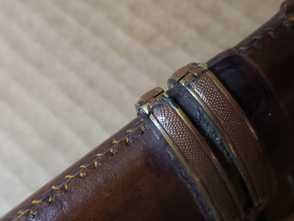

Tensho Posted October 27, 2023 Report Posted October 27, 2023 Interesting koshirae on that. Can you take a photo of the underside of the metal hanger on the sheath? It looks like it "could" be a removable hanger as was mentioned earlier. The tsuba and seppa are cut for a Chuso, but the tsuka, fuchi and saya are not. But the one seppa was obviously modified for the leather button strap. Perhaps a late war "high end" koshirae purchase/piece together of what parts were available at a shop? I guess this would be better discussed on the military sub forum. Quote
gbundersea Posted October 28, 2023 Author Report Posted October 28, 2023 Here are some close-up pictures of the hanger on the saya. It does indeed appear to be hinged. 1 Quote
PNSSHOGUN Posted October 28, 2023 Report Posted October 28, 2023 You can unscrew it from the top, though there is little reason to beyond your own amusement. This is a most unusual but good quality setup, please keep it in the family. 3 Quote
