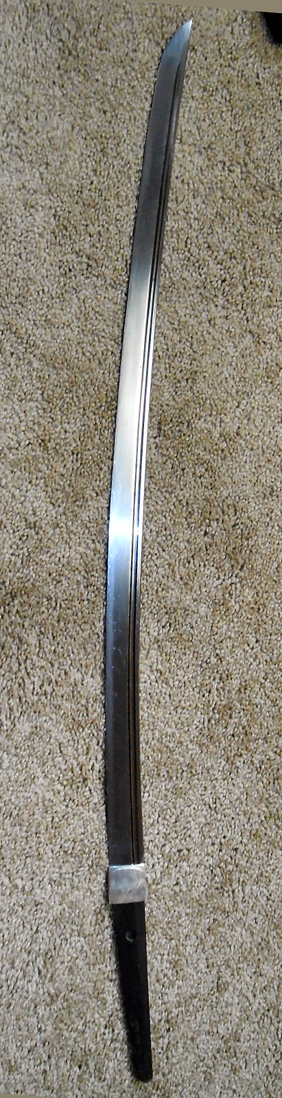

aabderson Posted October 23, 2023 Report Posted October 23, 2023 Hello all, I was wondering if anyone could give me some information about this sword. Specifically, how old it is and how much it may be worth! I believe it is from ww2. Thanks! Quote
Rivkin Posted October 23, 2023 Report Posted October 23, 2023 Need closeup of activities, boshi etc. As of now does not look like something too recent, can be shinto, can be a bit older, but its a wild guess just based on patina's appearance. Quote
Geraint Posted October 23, 2023 Report Posted October 23, 2023 Dear Alex. Whatever date for the blade we end up with the saya is quite a nice one and this is an example of an older sword that has been converted for use in WWII by the addition of a hanger to the saya. It's quite an attractive sword so Rule 1, don't attempt to clean anything! Doing so will drastically reduce the value. Hold on for some more comments here and perhaps add a photograph of the whole blade with the habaki removed. Looking forward to what others have to say about this one. All the best. Quote

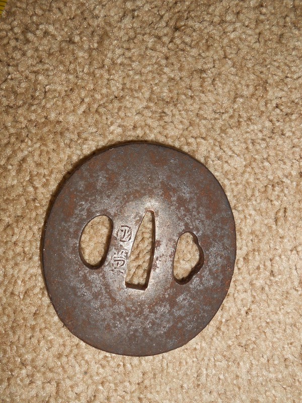

Bruce Pennington Posted October 24, 2023 Report Posted October 24, 2023 Very nice silver-wrapped habaki! And the tsuba is signed. Should post a clear shot of that for translation. Otherwise, I'm really not the guy to comment on the blade, if it's older than WWII. @PNSSHOGUN or @vajo or @BANGBANGSAN might have a thought as to whether it is zoheito. Best to give the nihonto guys the shots they need - full-length over head of naked blade; close-ups of a couple areas showing hamon and skin texture; closeup of kassaki (blade tip). If it's old, they can tell you. Quote
PNSSHOGUN Posted October 24, 2023 Report Posted October 24, 2023 Certainly an older blade, could be something intriguing from the general shape. Quote
aabderson Posted October 24, 2023 Author Report Posted October 24, 2023 Thank you @Bruce Pennington and everyone! It’s a blade I’m thinking of buying. These are the only pictures I have at the moment but trying to get more. Just trying to get information to help me decide on the age and price….any idea on a value based on age and condition? Quote
Brian Posted October 24, 2023 Report Posted October 24, 2023 I won't get into value, but it's a nice looking sword, the type that may have potential. Get a guarantee against fatal flaws. Quote
Kmad Posted October 24, 2023 Report Posted October 24, 2023 Hi Alex. What price is the seller proposing, that will help determine if worth pursuing. Some sellers have inflated opinion of what they have and expect a large payment, I have been offered somewhat similar at a price of 3,000 euro and another at a price of 175 euro. (I bought one of these only) If you don't ask price you will never know, I dislike having to make offer first as you cant be a seller and a buyer. Some times you have to when doing so it is hard not to be cheap so pitch at what you ant to pay and see how the dealing goes. Best of luck Ken Quote
ROKUJURO Posted October 24, 2023 Report Posted October 24, 2023 Alex, the age does not affect the value very much, but quality and condition does. If you have better and detailed photos, please show them always tip-upwards, especially the tang. The same applies to the TSUBA. Quote
aabderson Posted October 24, 2023 Author Report Posted October 24, 2023 The seller is asking for $1300 US. Is that fair? If not, then what is a fair price? Quote
Bruce Pennington Posted October 24, 2023 Report Posted October 24, 2023 I'd say it is in the 'normal' range. It will cost you $300 to get the tsuka re-wrapped. Tell him that and offer $1,000. Quote
BANGBANGSAN Posted October 24, 2023 Report Posted October 24, 2023 On 10/24/2023 at 4:40 AM, Bruce Pennington said: Otherwise, I'm really not the guy to comment on the blade, if it's older than WWII. @PNSSHOGUN or @vajo or @BANGBANGSAN might have a thought as to whether it is zoheito. Expand It doesn't look like it's a Zoheito, it looks more like a Koto. 1 Quote
Brian Posted October 24, 2023 Report Posted October 24, 2023 Older than WW2, price isn't terrible, but we have limited pics. 1 Quote
aabderson Posted October 24, 2023 Author Report Posted October 24, 2023 Thanks guys! I’m working on getting more photos for you!! I appreciate your time! Quote
vajo Posted October 24, 2023 Report Posted October 24, 2023 Hard to say from the pictures. Could be late muromachi or shinto. Could we get close up pictures of the boshi and the blade? 1 Quote

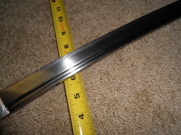

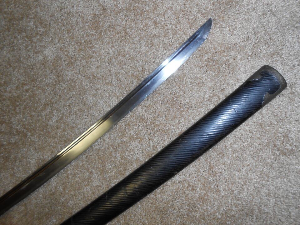

aabderson Posted October 24, 2023 Author Report Posted October 24, 2023 here are a few more pics if it helps! Still working to get more 1 Quote
aabderson Posted October 24, 2023 Author Report Posted October 24, 2023 Previous Page Next Page more pictures Previous Page Next Page Quote
aabderson Posted October 24, 2023 Author Report Posted October 24, 2023 Seller says the Tsuba is signed by Kunikane. Is that correct? Is he well known? Quote
Ed Harbulak Posted October 24, 2023 Report Posted October 24, 2023 The tsuba is signed Kuni Hiro. I'm not a tusba collector, but the signature in this case doesn't impress me but others may give you a better answer. Quote
aabderson Posted October 24, 2023 Author Report Posted October 24, 2023 Thank you! Any thoughts from anyone else? Just wondering how old the sword could be and what is a good price for it. He is asking $1300. is that a good price? I know im going to have to have it re-wrapped. does it need to be polished? Quote
aabderson Posted October 24, 2023 Author Report Posted October 24, 2023 Thank you! @BANGBANGSAN@PNSSHOGUN what do you guys think of the new pics? You think it’s Shinto or Koto? Any other info you can give me on a value of what I should pay? Quote
Ron M Posted October 25, 2023 Report Posted October 25, 2023 Just fyi, I actually purchased this sword then sent it back (I can show you proof if needed though I’m not trying to hurt the seller). Not due to flaws or a bad seller but because the pictures did not show all of the scuffing that is actually on the blade. You could not see any of the hada and barely the hamon in hand. The pics don’t show this and it looks really clean IN THE PICS but if you look carefully you can see the swirls hiding in plain site. It is going to need a polish immediately and isn’t a study piece as is. A good sword but will need investment so be aware. 2 Quote
Bazza Posted October 25, 2023 Report Posted October 25, 2023 Alex, sooner or later in collecting Nihontou one has to 'bite the bullet' and buy. $1,000 is a good starter IMHO. I would buy it and send to a good polisher (search the Board for discussion on polishers) and beware a cheap deal. A 'cheap' polish gives you what you pay for - disappointment in the long run as your knowledge and experience grow. I've been there and done that. Vajo wrote "Its a nice shinto katana my guess". I agree and FWIW think it could be earlier Shintou than later. To find out all it costs is money, and when it comes to good Nihontou it pays to be not shy about money... You will win some and lose some, but you do have to get your feet wet. BaZZa. 1 2 Quote
