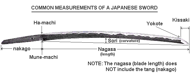

ROKUJURO Posted October 18, 2023 Report Posted October 18, 2023 1 hour ago, cwo4uscgret said: Here are pictures of the hamon on both sides of the Nagasa; ..... The right side of the Nagasa does not have a piece missing Tim, NAGASA is the Japanese word for the 'length' of a blade (see bruce's post above). It may well be a whole new world of terminology for you! Quote

cwo4uscgret Posted October 18, 2023 Author Report Posted October 18, 2023 It is! Blade length : 32.6 cm, tang is 11cm Quote
