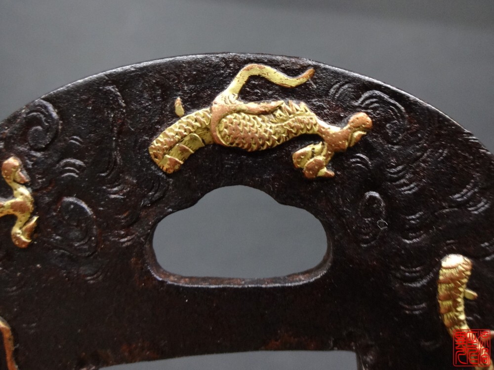

zanilu Posted October 13, 2023 Author Report Posted October 13, 2023 FT-0004 Dragon in waves (nami ryū zu - 波竜図) Tsuba Jū-mokkogata (木瓜形), tetsu-ji (磨地), sukidashi-bori (鋤出彫), ke-bori (毛彫), kin iroe (金色絵), maru-mimi (丸耳), ryō-hitsuana (両櫃孔). Dimensions: 80.3 mm x 75.4 mm. Thikness 3.9 mm at seppa dai, 3.4 at mimi. Material: Iron Is Jū-mokkogata (木瓜形) is right or it is better kikku-gata (菊花形)? Regards Luca 3 Quote

SteveM Posted October 13, 2023 Report Posted October 13, 2023 I think you are safe with Jū-mokkō-gata (十木瓜形). My bias would have been towards Kikka-gata (菊花形), but having looked in Iimura's "Tōken Yōran" which is a little almanac on swords first published in the 60s, I see he uses Jū-mokkō-gata for this kind of 10-lobed tsuba. And having double-checked with some papered tsuba, I see that NBTHK also uses "mokkō-gata" for tsuba with scalloped edges (8 or 10 or 12 lobes), always including the number of lobes when there are more than the default 4 lobes. But I don't expect these terms to be used with any consistency nowadays. You could call it Kikka-gata and get very little argument from anyone. Adding the entry from Iimura just for reference. I'm sure we could find examples where other authorities use other terms (as Dale has shown above). 7 Quote

MauroP Posted October 15, 2023 Report Posted October 15, 2023 Ciao Luca, nice tsuba BTW. A remark on typo: 磨地 reads migaki-ji (smooth surface), tetsu-ji is 鉄地. About an attribution I’d suggest Hizen (thoght hitsu-ana shape could also point to an Higo school). Quote
zanilu Posted October 15, 2023 Author Report Posted October 15, 2023 Ciao Mauro. I stand corrected for the kanji. I had the same idea about Hizen based on the hitsu Ana as you said I will also consider Higo now that you mention it. Grazie! Luca Quote
Soshin Posted October 15, 2023 Report Posted October 15, 2023 On 10/13/2023 at 3:00 PM, SteveM said: My bias would have been towards Kikka-gata (菊花形), but having looked in Iimura's "Tōken Yōran" which is a little almanac on swords first published in the 60s, I see he uses Jū-mokkō-gata for this kind of 10-lobed tsuba. And having double-checked with some papered tsuba, I see that NBTHK also uses "mokkō-gata" for tsuba with scalloped edges (8 or 10 or 12 lobes), always including the number of lobes when there are more than the default 4 lobes. Jū-mokkō-gata is now I would describe the shape of the tsuba. It is also how the NBTHK would describe the shape of the tsuba on a paper. 1 1 Quote

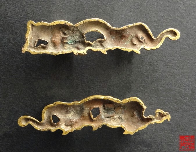

zanilu Posted November 1, 2023 Author Report Posted November 1, 2023 FT-0018 Menuki dimensions 59.9 mm x 15.0 mm, thk 5.4 mm and 61.2 mm x 14.0 mm x 4.1 mm. Quote

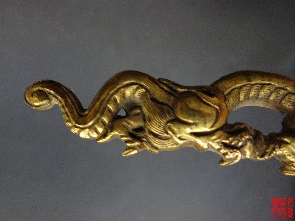

zanilu Posted November 1, 2023 Author Report Posted November 1, 2023 FT-0045 Dragon shakudo menuki Dimensions 100.5 mm x 17.3 mm x 6.9 mm and 101.5 mm x 19.1 mm x 7.0 mm. 1 Quote

Bazza Posted November 2, 2023 Report Posted November 2, 2023 Luca, nice, NIO btw. Are these papered?? I think they are Unno Shomin school, Mito province. See Legacy Art here: https://www.legacysw...-unno-school-menuki/ Note Ted Tenold's comment: The meticulously placed star shaped chikaragane around the posts are yet another qualitative touch that immediately show the dedication to craftsmanship through details, and a hallmark Unno touch. I must say, though, that I don't see the level of detail exhibited in the Legacy Art menuki. I have a pair of NIO in shakudo, also Mito, that have heavy posts. BaZZa. 2 Quote
