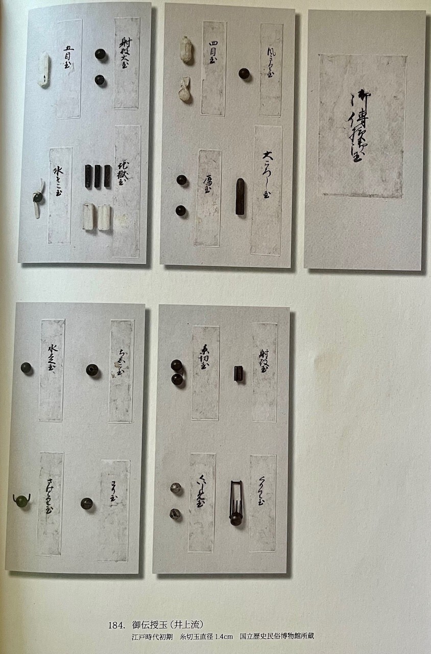

This is from Ogawa San’s Accessories book, p. 073, showing some Inoué Ryū gunnery school ball experiments from early Edo.
These materials are preserved in the Kokuritsu Rekishi Minzoku Hakubutsukan. See patched ball mid top. The cut ball is 1.4 cm in diameter.
