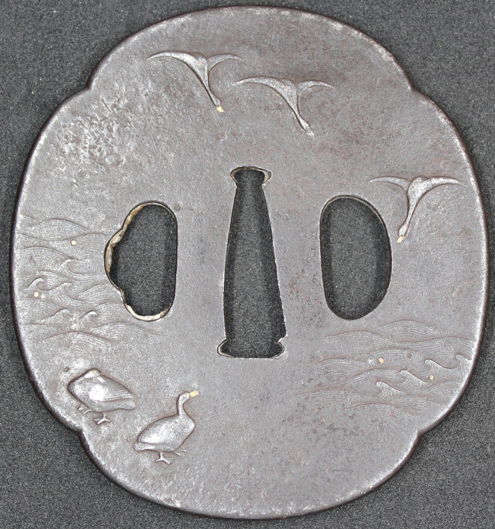

Could you please help me identifying a school for this tsuba…all I can say ..it looks like a copy of kaneie goose tsuba.  Dimensions 8.3 x 8.1 cm and thickness 3 mm in the center 4. 3 on the rim
Many thanks in advance for your comments
  • Love 1
I would have said Kaneie style also but too ornate and no signature - probably Shoami or Aizu-Shoami - They were known to do some Kaneie lookalikes. JMO
There is an old post with a frog - it has to my mind a similar "feel" to it - not sure why - [feel free to ignore my unsubstantiated "feeling":-?]
There is one on ebay now - nowhere near as good as your guard - https://www.ebay.com/itm/275898978473  The workmanship is pretty ordinary.

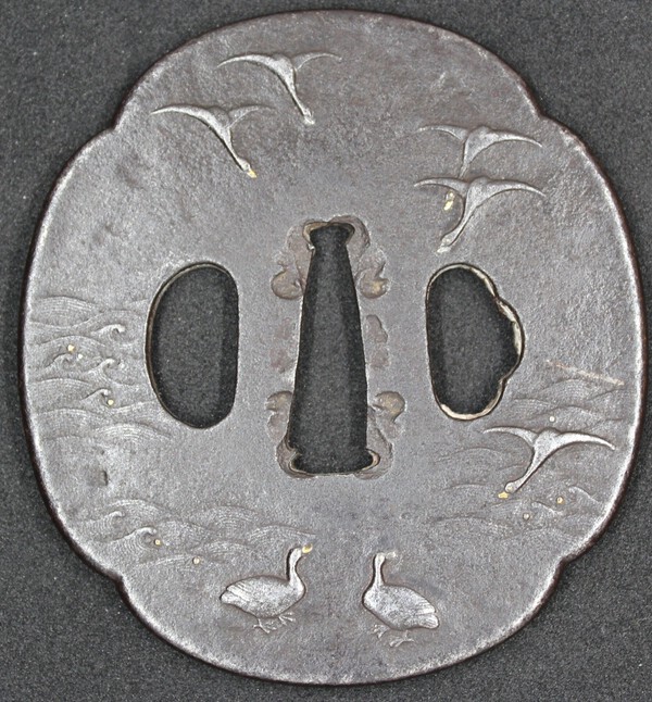

Hi Daniel,
I would also say Kaneie style by Aizu Shoami.
I have a tsuba with a very similar composition to yours.
Height: 77mm
Width: 71mm
Mimi thk: 4.05mm
Seppa dai thk: 3.5mm
Geese1.thumb.jpg.688150f0504b63d3eacf9d9aee8df9c8.jpgGeese2.thumb.jpg.7f72d1d19ad2d3448430c4491e0c68b3.jpg
  • Love 1
Many many thanks Colin T and Dale for this "common" information....and similar exemple...aizu-shoami is certainly the best choice...it was very helpfull
for me
all the best
Daniel
