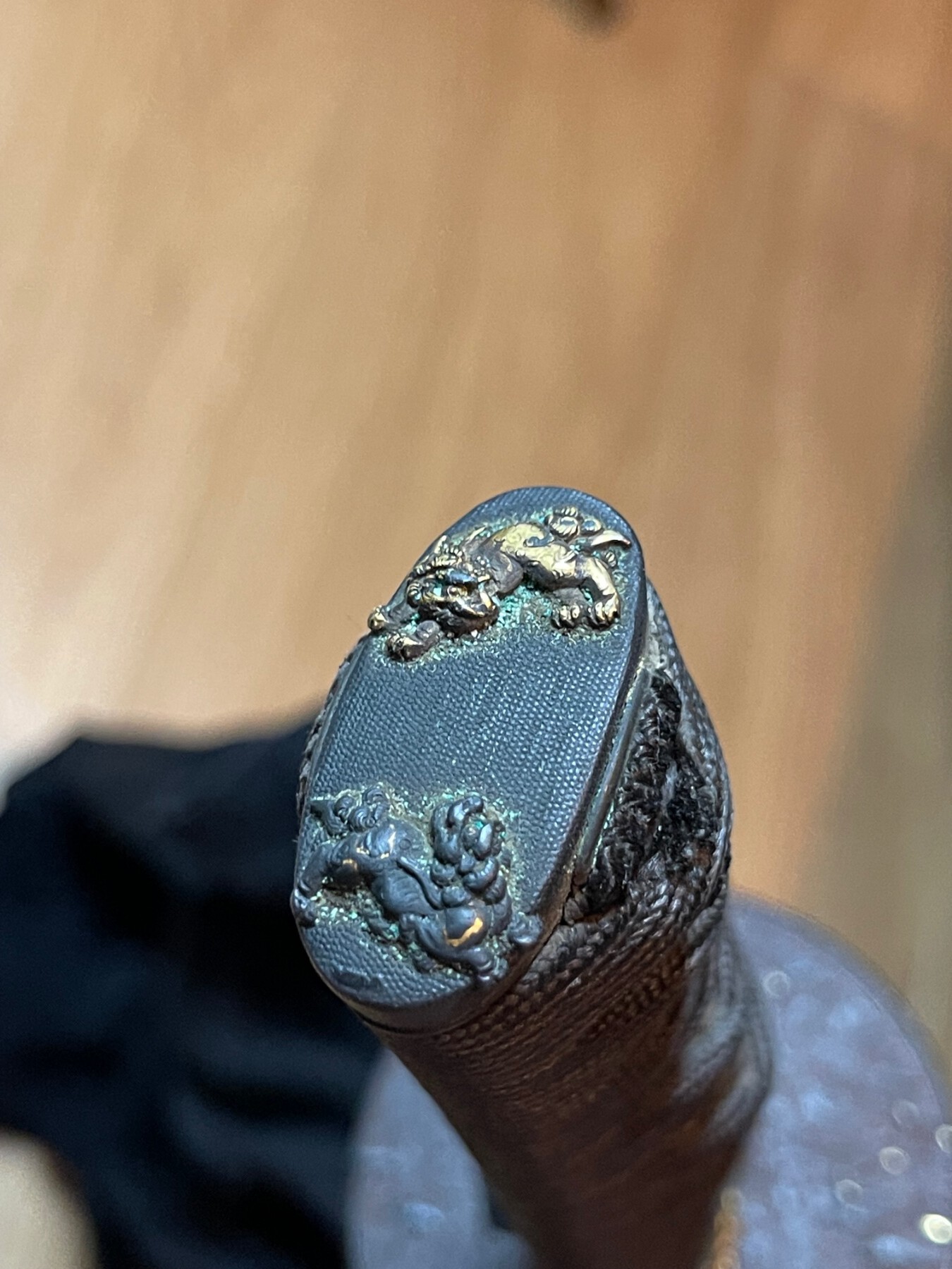

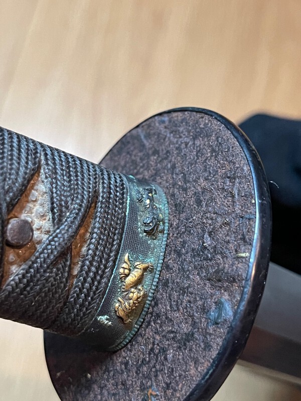

I like the Tsuba and think it could profit from some rust removal with a piece of antler, only rub of the red rust. I don’t know much about how to clean the Fuchi Kashira but I would try to get rid of the green stuff. Maybe antler can do the trick again but i  would ask in the tosogu section how to do it.

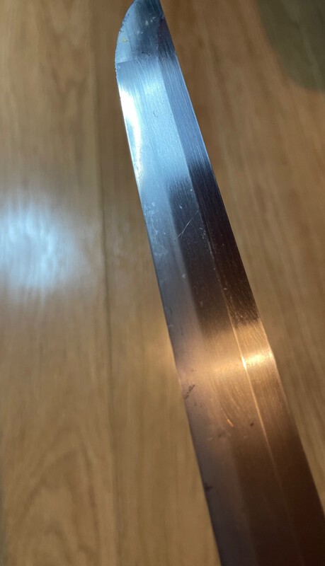

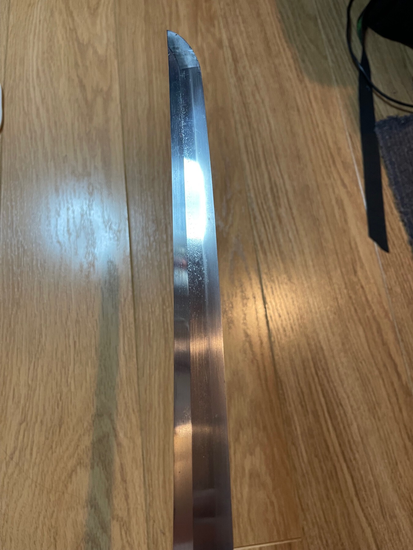

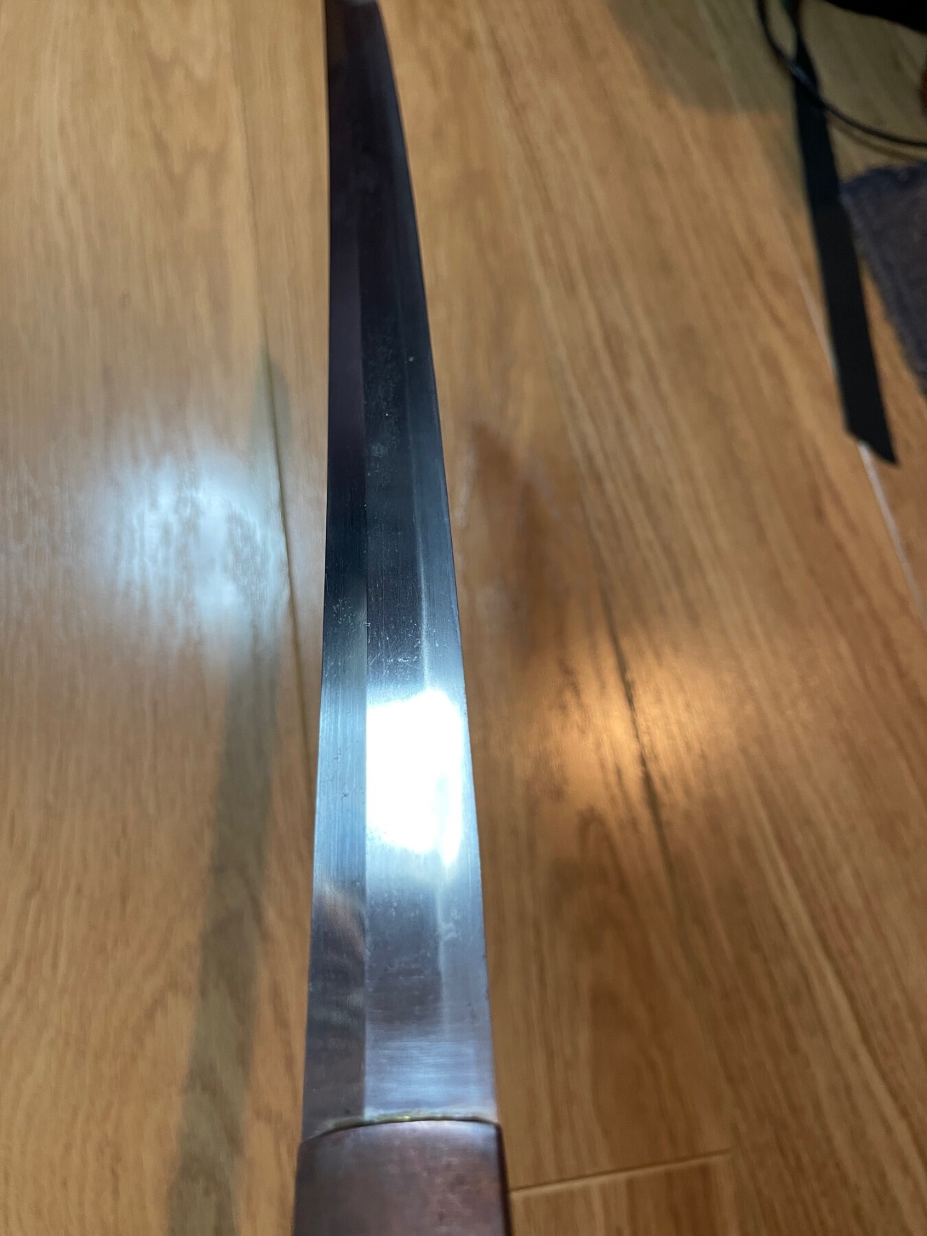

The blades condition can be improve with regualary cleaning with uchiko and oil but don’t ask me how long this takes.
To make a guess about the age we would need to see the Sugata of the blade in a picture like this without the mounts and Habaki.  (It does not need to be both sides but need to see the complete blade.)
Edit: I just assumed the signature is Gimei because you did not say anything about papers. If it is shoshin and you want to hear something about the blade the pictures need to be better :roll:
Also some dimensions would be helpful to understand what we see.

The carving of mei is almost showa-styled, deep spaced yasurime is shinshinto or later, patination is shinshinto or later.
Overall I would say its a decent possibility this is authentic.
The blade (as little as we can see) is sort of consistent with late shinshinto Hizen.
