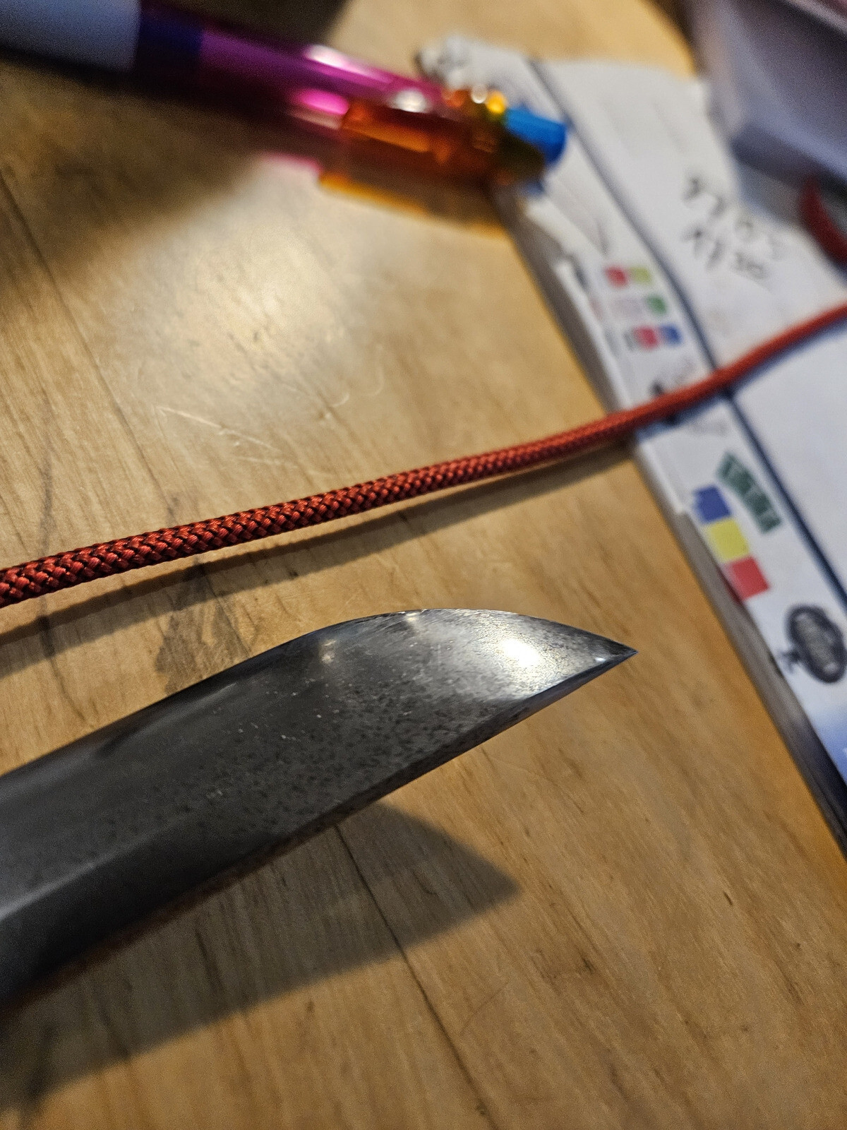

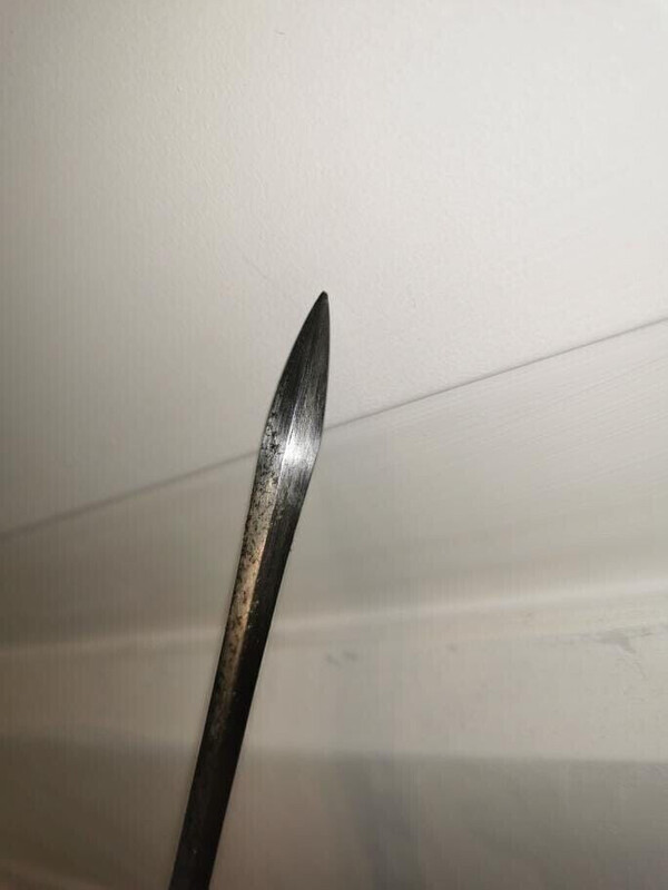

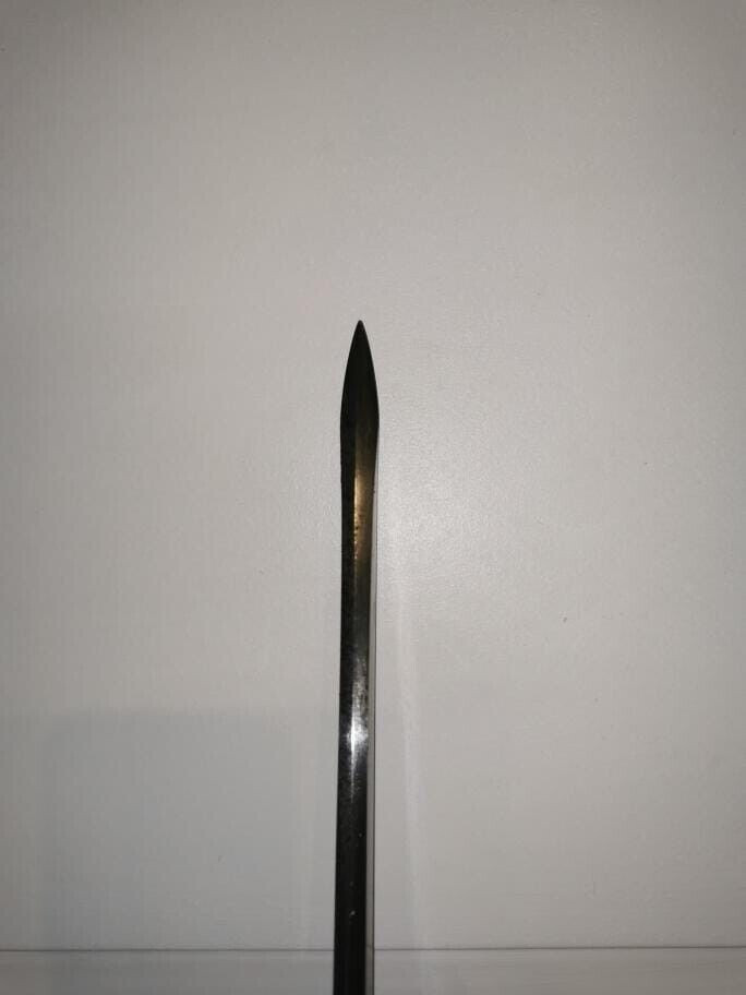

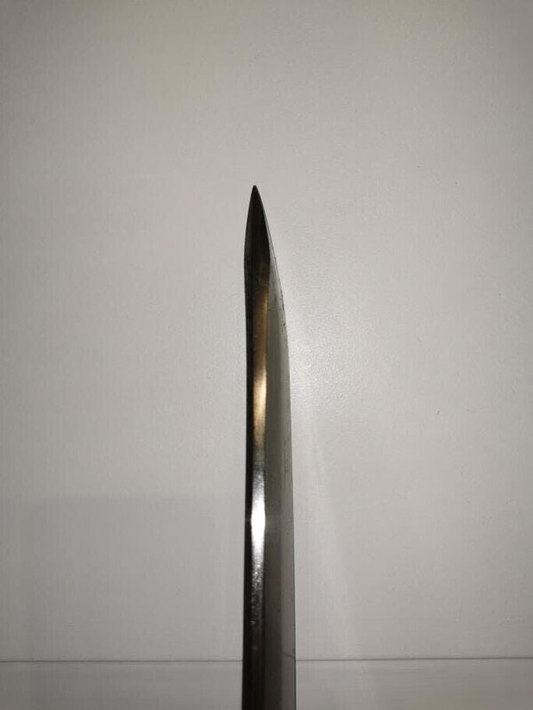

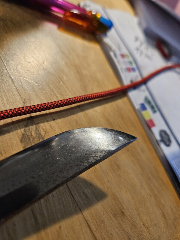

Yukihiro Posted September 28, 2023 Report Posted September 28, 2023 Being no expert in the field of WW2 Japanese swords, I must say that I am unsure as to the quality of the blade I am posting - the kissaki, in particular, looks a bit off to me. Could you tell me whether there would be the slightest chance for this blade to have been at least partially traditionally made? The seller thinks the blade might have been water quenched but a seller being a seller, he will invariably tell you what to you want to hear from him. Quote

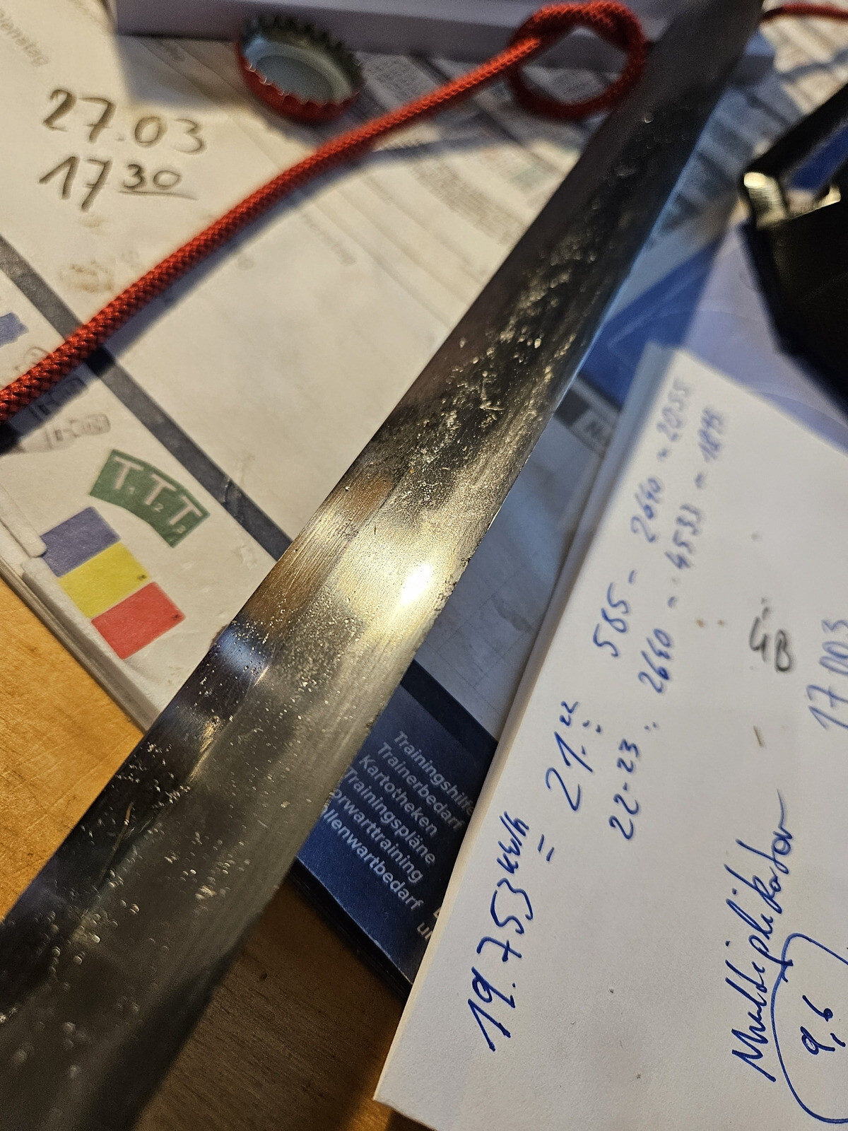

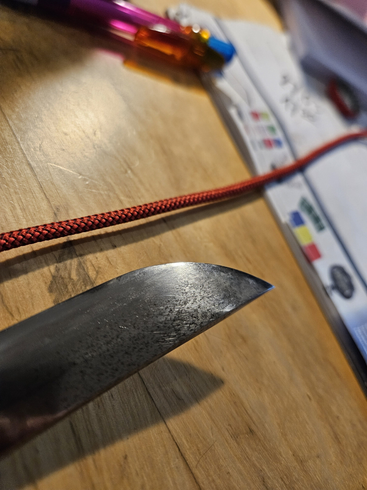

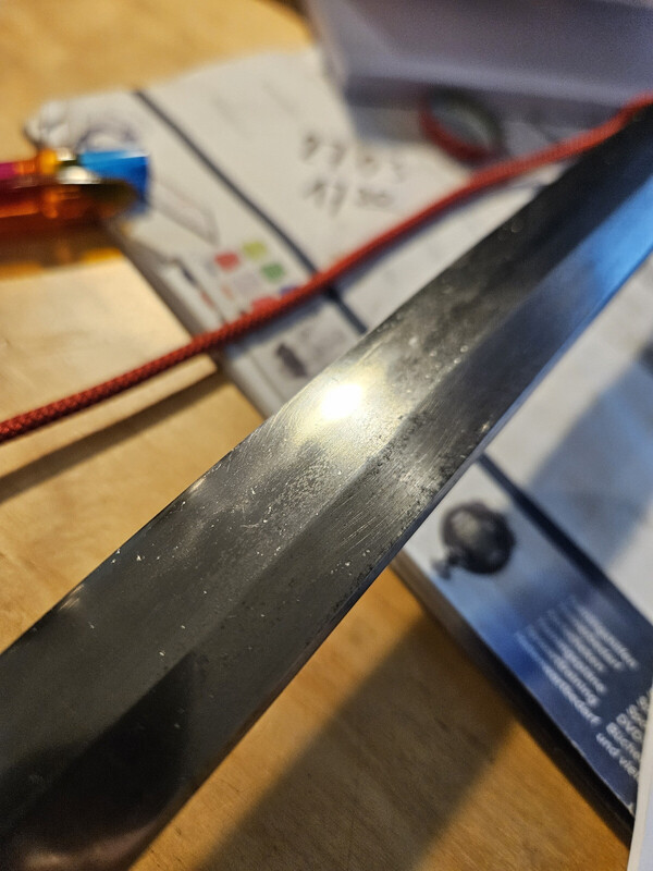

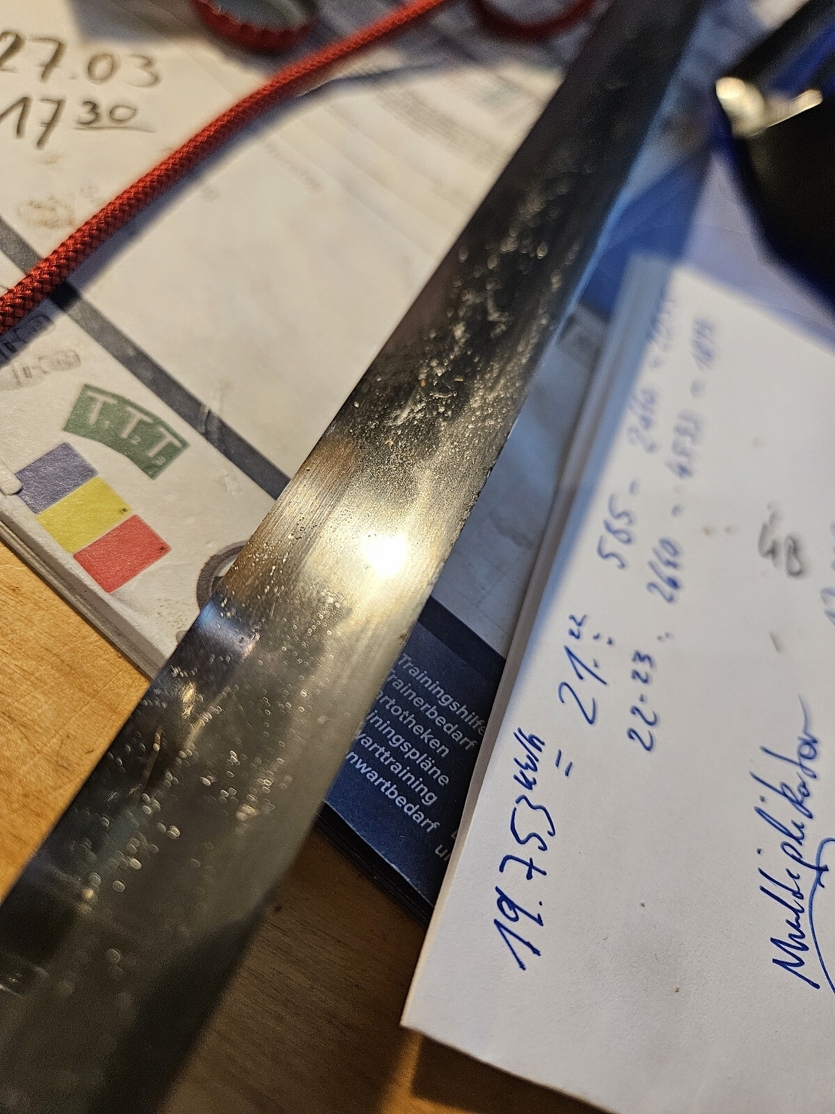

Yukihiro Posted September 28, 2023 Author Report Posted September 28, 2023 Here are some more photos. Quote
Jcstroud Posted September 28, 2023 Report Posted September 28, 2023 Would it be possible to take a picture of the nakago aka tang would help in determining where it was made, and maybe when. I am no expert but in my opinion it is partially traditionally made ,maybe oil quenched.but lacks a yakote. John S. 1 Quote
Yukihiro Posted September 28, 2023 Author Report Posted September 28, 2023 The sword does have a Seki stamp on the nakago, which would point to a mere showato, but I'd like the blade to be judged on its own merits: do you think it is of any interest or is it yet another mass produced gunto blade? The seller told me it had been shipped from Japan with an export permit, but I suppose that does not mean per se that the sword is something out of the ordinary. Is the lack of yakote a flaw or do you think the kissaki was meant to look like this? Quote
Jcstroud Posted September 28, 2023 Report Posted September 28, 2023 Looks to have been polished off years ago.the kissaki resembles a Takayama- to late war were thicker but not like first design. Not a flaw just well worn. 1 Quote

ROKUJURO Posted September 28, 2023 Report Posted September 28, 2023 Didier, the photos and the condition of the blade (which seems to have been sandpapered) do not allow to make a safe assessment, but I do not see a typical oil-quenched HAMON. This blade has to be seen in-hand by an expert, I think. 2 Quote
