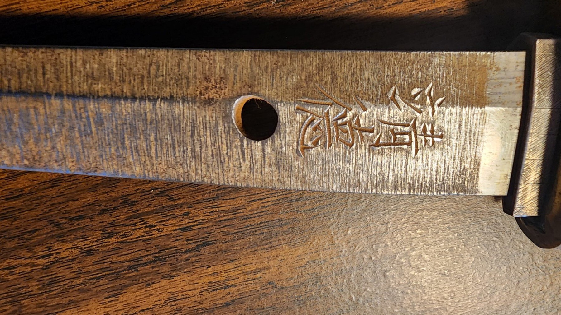

MtnView Posted September 27, 2023 Report Posted September 27, 2023 Greetings, I am hoping for some information about a sword I received from a family friend about 45 years ago. I didn't know where to turn until I heard about this message board. Any help/info would be appreciated. The letter that accompanied the sword was dated 5 Dec, 1945 from a Lt Col. at the HQ of the 1st Cavalry Division. He was stationed in Gamagori, Japan at the time. Attached are some photos. Please let me know if you need a view of anything specific. Thank you in advance for your help 2 Quote
John C Posted September 27, 2023 Report Posted September 27, 2023 Looks like the sword is dated 1939. John C. 1 Quote
Kiipu Posted September 27, 2023 Report Posted September 27, 2023 昭和十四年八月吉日 = A lucky day in August 1939. 1 Quote
lonely panet Posted September 27, 2023 Report Posted September 27, 2023 Kenzo kotani Yasunori was the student of kajiyma Yasunori. Which is the above smith. Once is apprentice was awarded the similar name he changed the shape of his nakago. Could you please show more. I bet its a cracking sword Quote

lonely panet Posted September 27, 2023 Report Posted September 27, 2023 Cracking is slang for good. The smiths from the yasukuni shrine school aka Nihonto taren kai are know for superior gendai. Hamon, hada, overall shape. Being earlish is should have a koto appearance 1 Quote

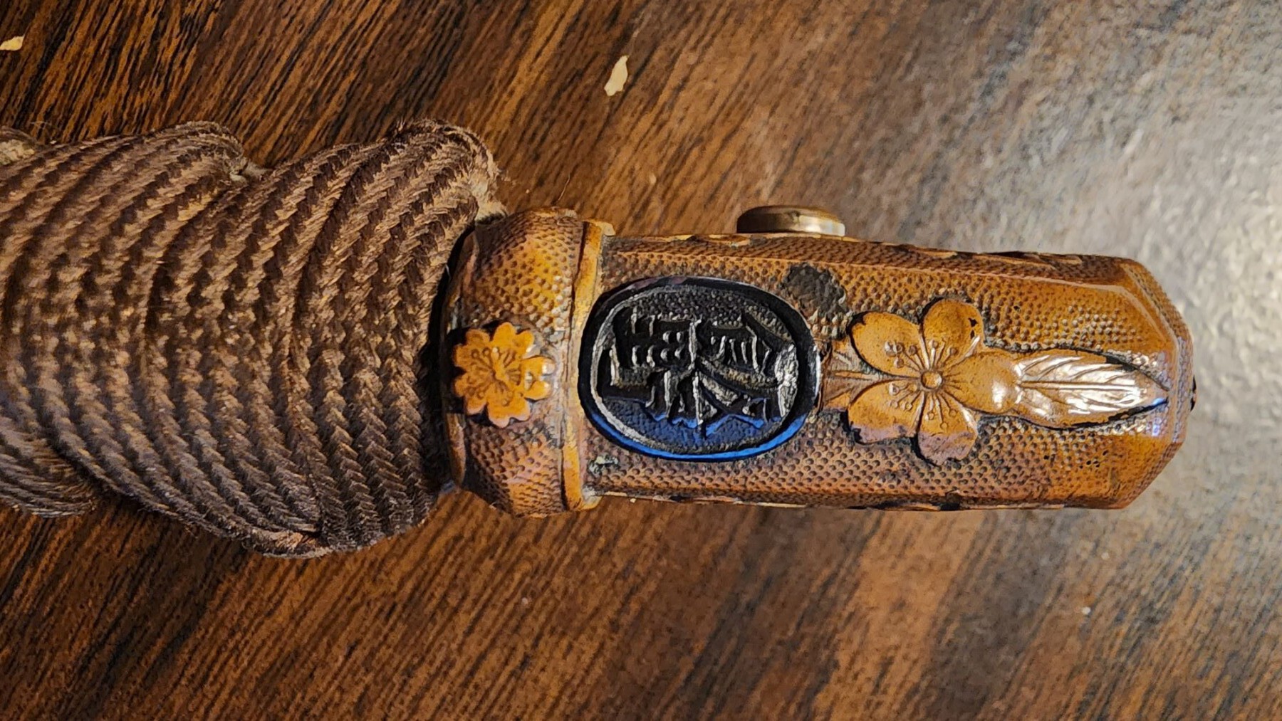

PNSSHOGUN Posted September 27, 2023 Report Posted September 27, 2023 What we all hope to find, keep it safe and be wary of any offers to buy it. The silver insert on the handle will be the Japanese officers surname. Quote
SteveM Posted September 27, 2023 Report Posted September 27, 2023 飯野 = Iino. Iino with a double i (not Lino) 1 1 Quote

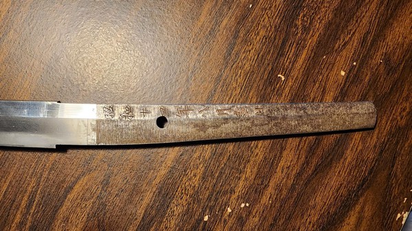

Stephen Posted September 27, 2023 Report Posted September 27, 2023 Please show the full nakago without any fittings ie habaki. Remember blade up nakago down. Very blessed man. Quote
MtnView Posted September 27, 2023 Author Report Posted September 27, 2023 Thanks for all of the input. Although I've always been fascinated with Japanese culture, I am finding myself ignorant in this area and am enjoying the education you are giving me. Stephen: are these the views you are looking for? Quote

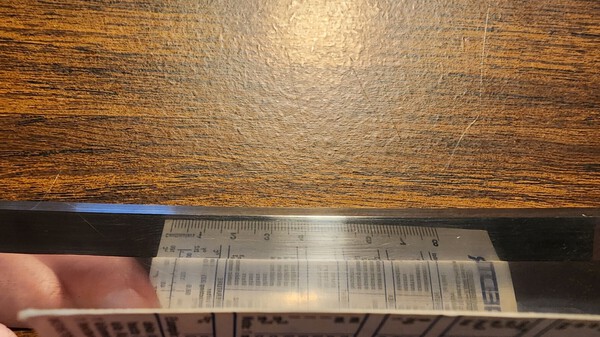

MtnView Posted September 27, 2023 Author Report Posted September 27, 2023 Are the lines where the tang meets the blade the laminations or something else? Quote
PNSSHOGUN Posted September 27, 2023 Report Posted September 27, 2023 Those are polishers marks, or "Nagashi". Different schools have some variations on how the lines can appear. There is further information at the bottom of the page: http://www.ksky.ne.jp/~sumie99/togi.html To learn more about the Yasukuni Shrine swords, you will need a book called "The Yasukuni Swords" by Tom Kishida. Quote
ROKUJURO Posted September 27, 2023 Report Posted September 27, 2023 Richard, as Stephen wrote: blade pointing upwards, NAKAGO pointing downwards. This is the way the signature can be read. Quote
Matsunoki Posted September 27, 2023 Report Posted September 27, 2023 Richard, very desirable sword. This is the correct way to show images of the nakago (tang). It can be a tad confusing when you first encounter the “official vocabulary”. Quote
