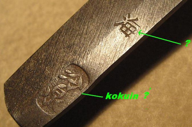

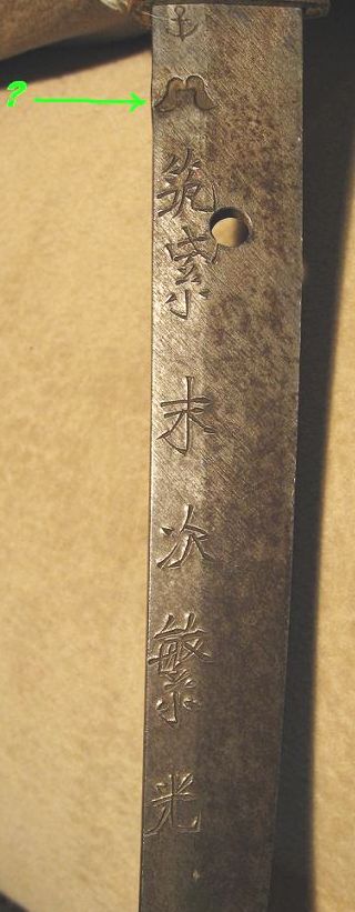

Stephen Posted December 19, 2006 Report Posted December 19, 2006 Ok heres one stamp i have not seen, any one come across this before? Seller states that the anchor without a circle just shows it went to a Navy Officer...it comes in Kai gunto mounts...and its true gendaito large Bizen choji hamon. The other Stamp is spec it has something to do with Mt. fuji, any help there? How about the kaji above the kokuin do we know what that means. I find Shigemitsu in the Gendai toko meikan on page 189...no oshigata but wold like to know what it says if you have the book if not i can scan and post if youd like to help. Thanks Quote
Bungo Posted December 20, 2006 Report Posted December 20, 2006 " How about the kaji above the kokuin do we know what that means " it means..sea, ocean. milt THE ronin Quote
Bungo Posted December 20, 2006 Report Posted December 20, 2006 the kokuin has two words in it...........can't pronounce it in Nihongo but it means " cold spring " milt THE ronin Quote
Guido Posted December 20, 2006 Report Posted December 20, 2006 Bungo said: ...can't pronounce it in Nihongo but it means " cold spring " Yup, looks like "Reisen", cold spring (not the season, but where water comes out of the ground). However, it also could be Reizei, a Japanese emperor who reigned from 967 ~969, whatever significance that might have. The single Kanji is read "Umi", sea. Quote
Nobody Posted December 20, 2006 Report Posted December 20, 2006 other possibilities for 冷泉; 1) reads Reisen which is a place name near Hakata in Fukuoka-ken. The smith Suetsugu Shigemitsu seems to be living in Fukuoka, no? 2) reads Reizei which is the name of a famous court noble. Quote
Stephen Posted December 20, 2006 Author Report Posted December 20, 2006 http://home.earthlink.net/~ttstein/shigmits.jpg reads Isukushi Suetsugu Shigemitsu correct? So the stamp has not been seen by anyone? Quote
Nobody Posted December 20, 2006 Report Posted December 20, 2006 Stephen said: http://home.earthlink.net/~ttstein/shigmits.jpg reads Isukushi Suetsugu Shigemitsu correct? The first part of it reads Tsukushi (筑紫), not Isukushi. It is same as Chikushu (筑州). Quote
Stephen Posted December 20, 2006 Author Report Posted December 20, 2006 Thanks Koichi, my typo. Quote

Bungo Posted December 21, 2006 Report Posted December 21, 2006 Oyabun, I checked the expensive Fuller und Gregory book...............page 230, figure 64, # X.............there's your " cold Spring " seal stamp. The book did not translate the kanji ( cold spring ) but identified it as Suetsugu Shigemitsu. Thought you may want to know. milt The ronin Quote
