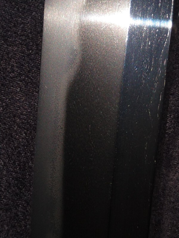

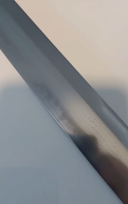

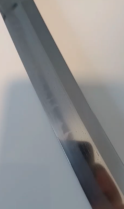

2devnul Posted October 12, 2023 Author Report Posted October 12, 2023 Hi, Sword finally arrived, I made some pictures best to my skills. What do you think? 1 Quote
DTM72 Posted October 12, 2023 Report Posted October 12, 2023 On 10/12/2023 at 10:19 AM, 2devnul said: Hi, Sword finally arrived, I made some pictures best to my skills. What do you think? Expand On 10/12/2023 at 10:19 AM, 2devnul said: Is the one I purchased a real Nihonto, Gendaito, Shinsakuto or a very good replica made outside of Japan by certified (or not) smith, that is still open question. I will love to hear more once I have the blade and can share more pictures (tell me what you look for). Expand I think you have alot to learn about photographing a sword blade. (No disrespect intended) Taking a photo of a highly reflective surface, to show the fine deatils of that surface, is very difficult. There are articles on here (the NMB) about how to photograph blades to capture these fine details. As to your second question, I would label it as a good reproduction made outside of Japan by a smith using some Japanese forging techniques, using a mix of mill steel and oroshigane, and some decent polishing using some Japanese polishing techniques. 1 1 Quote
NewB Posted October 12, 2023 Report Posted October 12, 2023 Made anywhere But in Japan is my honest opinion Y 1 Quote
John C Posted October 12, 2023 Report Posted October 12, 2023 Adam: Just my opinion, however I agree that the blade may not be of Japanese origin. Modern Japanese smiths need to be registered and certified; consequently there are not very many of them. Having gone through their training, apprenticeship, and certification, I would find it odd that it would not be dated as well as signed. Indeed, I believe a modern sword must be dated (this could be wrong, I just remember reading it somewhere). It very well could be a nice sword made in the Japanese style, however I suspect somewhere other than Japan. John C. 1 Quote
SteveM Posted October 13, 2023 Report Posted October 13, 2023 On 10/12/2023 at 11:47 PM, John C said: Indeed, I believe a modern sword must be dated (this could be wrong, I just remember reading it somewhere). Expand I asked the All Japan Swordsmith Association about this some time ago, and they replied that there was no legal requirement to put the date on the sword. 2 Quote
2devnul Posted October 13, 2023 Author Report Posted October 13, 2023 Hello, Thank you very much everyone. I was worried that it can be a good reproduction but not Nihonto. I guess buying something from Komonjo without papers is a risk and most probably end up with outside-of-Japan sword. I have a buyer for the sword and will be able to get my money back, so not a big deal. However, lessons learned. @DTM72 I will try to polish my photo-skills, thanks! Quote

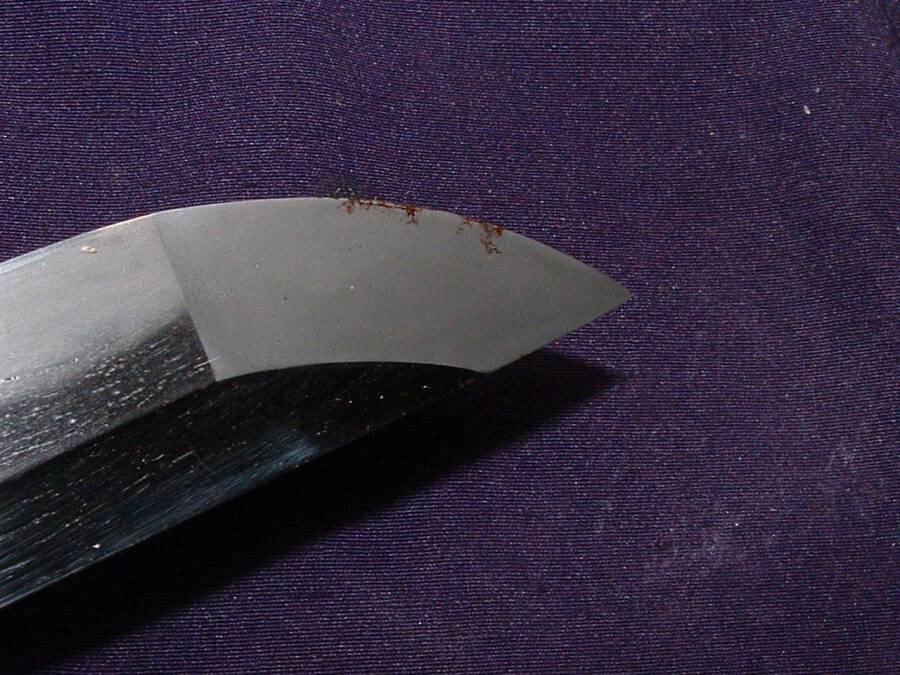

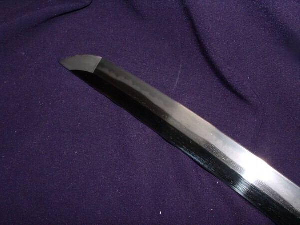

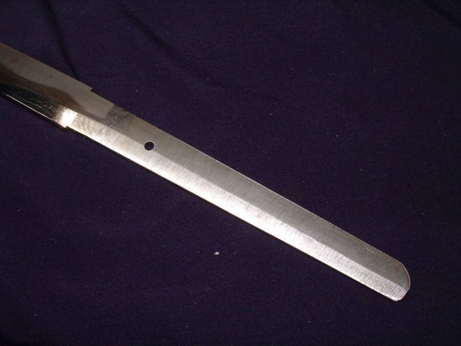

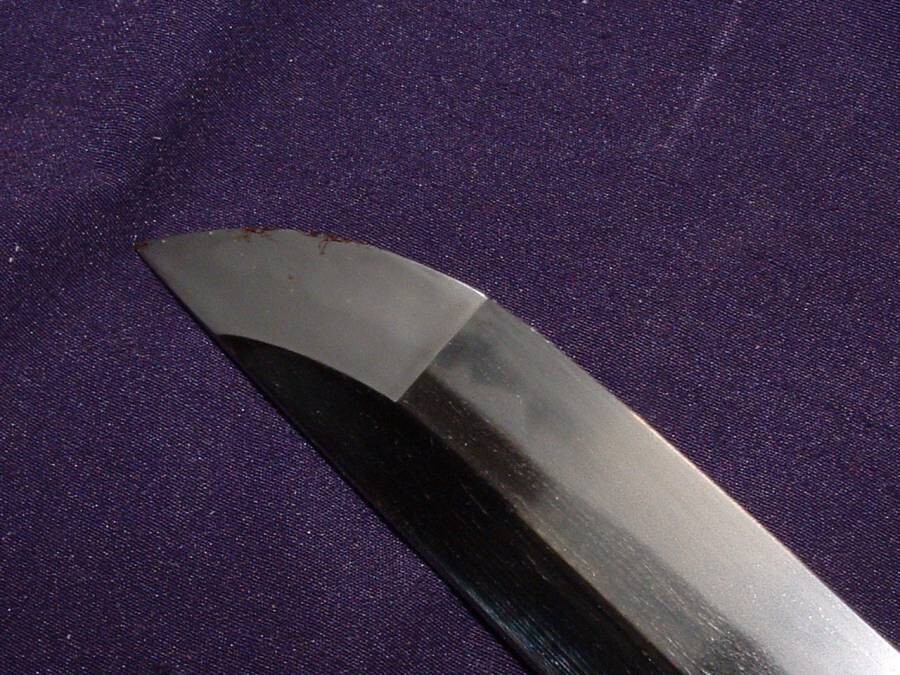

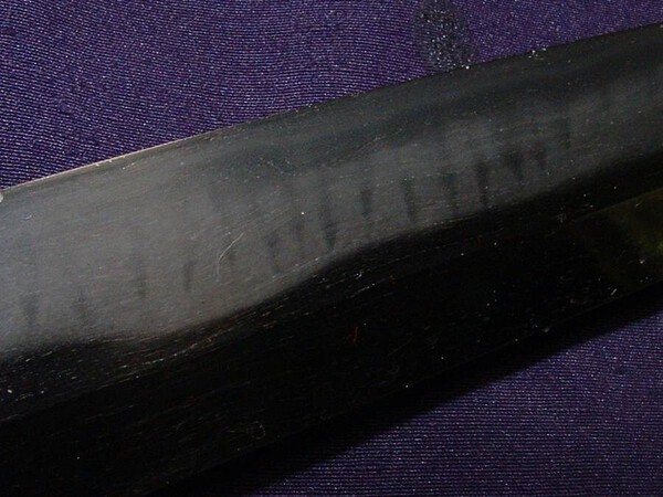

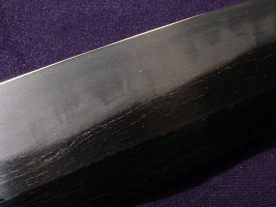

DTM72 Posted October 13, 2023 Report Posted October 13, 2023 On 10/13/2023 at 6:37 AM, 2devnul said: @DTM72 I will try to polish my photo-skills, thanks! Expand I have actually had decent luck going into a completely dark room with an iPhone or Android. Place sword on a dark blanket or other dark, non-reflective background. (with lights on) Turn on your camera phone and zoom-in to 2.0-2.5 x zoom. Make sure flash is on. Hold phone about 10 cm away from the sword surface. Turn off the light. (may need someone to help you) Snap lots of pictures. (you can always delete bad pics later. The bohsi (tip) is sometimes hard to photo. The first two pics are from a mid-Koto period (1400's) wakizashi, next 3 are from an early Edo period katana (1650-1660) Pics below were taken following the above steps. Hope this helps! 2 1 Quote
