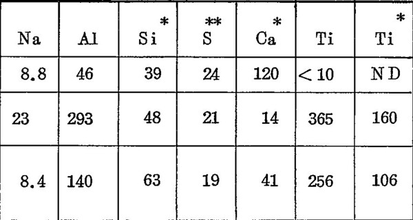

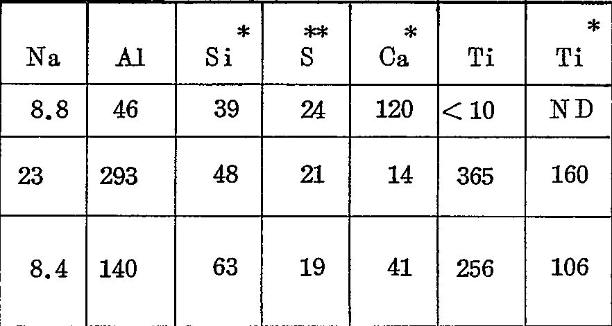

Moritsuchi Posted September 1, 2023 Report Posted September 1, 2023 Hi, I've noticed a lot of you guys are making armour, so I thought this would be a good place to ask: What modern Steel is the best equivalent for ancient Japanese steel? I've got some papers analysing impurities, but I have no clue about modern industry steels, which comes closest to the historical stuff. EDIT: These are parts per million, Carbon content was around 0.3% down from likely 3% in the raw material (these are samples for the Nara- and Heian-Period, I am going for a Kofun-Helmet I want to reproduce, thats the closest analysis I found. I've found also tables for newer material, that changes a bit of course, but the general gist of high Titanium, Aluminium and Nickel stays the same.) Probably the best would be Tamahagane? But buying 30kg of Tamahagane is out of question, I guess most of you also haven't won enough lotteries, so what do you use? Florian Quote
Arthur G Posted September 1, 2023 Report Posted September 1, 2023 Which specific type of Kofun helmet? If you can show the exact one you're copying it might help. Quote
ROKUJURO Posted September 2, 2023 Report Posted September 2, 2023 Florian, these old alloys are not available here, as the ores are from Japan. The mentioned elements are just impurities and do not influence the properties of the metal very much. TAMAHAGANE is not a standard material but raw iron with differing composition, especially in the C content. In KOFUN times, cast iron with high percentage of carbon was not known, so it must have been an early bloom iron with a very low content of C. What you want to use is iron with high ductility properties such as deep-drawing sheet metal (Tiefziehblech in German). This is used in car bodies, so you should be able to get it from a scrap-yard. You need a low carbon content to make the material easily workable. Quote
