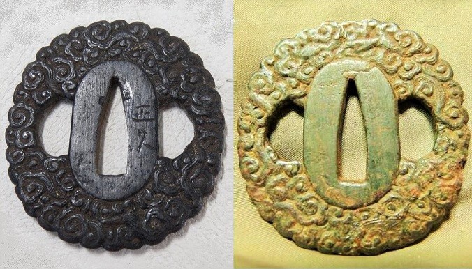

Type 1 https://www.ebay.com.au/itm/394651745141  and  https://www.ebay.com.au/itm/374483049004    https://www.invaluab...842ddc3264f54eb83033   cast irregular outline with irregular outlined hitsu  also sometimes described as Clouds rather than Waves - https://www.militaria.co.za/nmb/topic/10944-thoughts-on-edo-cloud-tsuba/

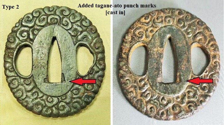

Type 2 cast in 'tagane - ato" with hitsu outlined in 'niku'    https://www.invaluab...3cd8c55943fb31afba59   https://www.invaluab...uba-363-c-2264fc3aa9    https://www.ebay.com/itm/325790662099

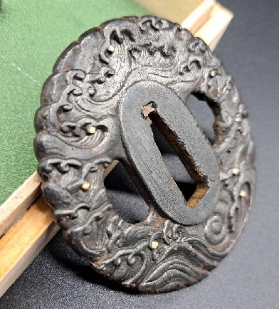

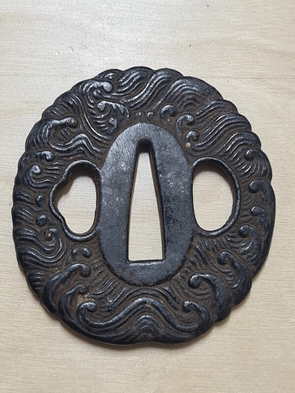

Type 4 - the mustache!   https://www.invaluab...h-a--38-c-39f4a92a35   https://www.ebay.com/itm/402977710393
I call the cast wave tsuba the "moustache/ mustache" for the double sided wave seen on both sides under the nakago-ana - you could call it the Poirot if you like.
Good old Japanese iron tsuba, heavily made with a wave pattern, pierced with kodzuka and korai ana. Signed. Good condition        image.png.cb21ecd37f47e4a4adec8370fc5645a8.png  image.png.ea81c270fcda3e886ca99ce5e584238d.png

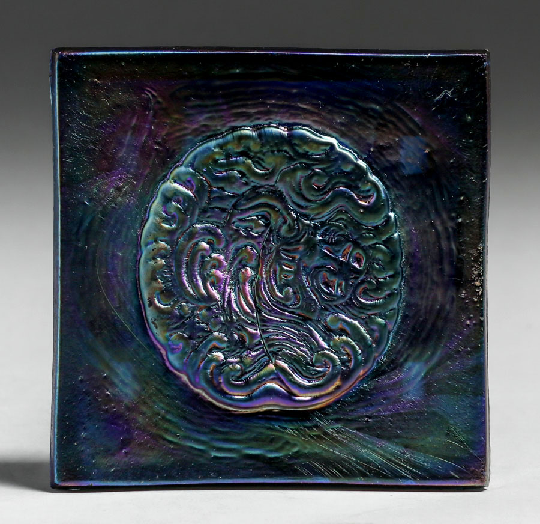

Would you believe Louis Comfort Tiffany [Tiffany Glass - Tiffany Lamps etc] was an avid tsuba collector, he tended to buy en masse hundreds at a time. One of his designs for glass tiles must have been "the Moustache" ! :o
image.png.4e525d03dbd8edea02e5cbb137d44c3e.png     https://www.acstickl...glass-tile-c1910s-2/
More information on Tiffany as well as another tsuba tile can be found here - https://www.lilliann...a-favrile-glass-tile
