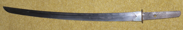

Cuirassier Posted August 30, 2023 Report Posted August 30, 2023 Hi Guys Local UK auction punt. Came with "certificate" from old school expert Bill Tagg that (in his view) this is a true original Horikawa Kunihiro wakizashi blade. Comments? Mark 1
PNSSHOGUN Posted August 30, 2023 Report Posted August 30, 2023 Not even close: http://www.sho-shin..../kyoto-horikawa.html 2 1
Cuirassier Posted August 30, 2023 Author Report Posted August 30, 2023 On 8/30/2023 at 10:35 AM, PNSSHOGUN said: Not even close: http://www.sho-shin..../kyoto-horikawa.html Expand Thanks, but https://www.christie...m/en/lot/lot-4461867 1
Geraint Posted August 30, 2023 Report Posted August 30, 2023 Dear Mark. Well if nothing else this is good to train your eye as you search out oshigata. Remember the period when Horikawa Kunihiro was working, look at the nakago patina, the yasurime, the placement of the mekugi ana, the relationship between that and the mei and everything else. The Christie's lot you linked to does not indicate whether it has papers or not, remember the auction house rules on the form of words they use and what they say they mean. Have to agree with John on this one but there were quite a few smiths signing this way over the years so the fact that it's not Horikawa Kunihiro does not mean that it's not a good sword. Just for fun here's mine, bought when the internet was not even a thing and the only books were Sword and Same and Robinson. I got quite excited for a bit! Enjoy the search, look for papered examples and those published in Japanese texts. All the best. 7
Cuirassier Posted August 31, 2023 Author Report Posted August 31, 2023 I've decided to get it polished and submitted for papers. Which is my best option (polisher and where to send it) anyone? Can it be done in the UK or does it have to go to Japan?

Guest Simon R Posted September 1, 2023 Report Posted September 1, 2023 Billy Tagg is a bit of a cheeky chappy but he's as wily as a fox. If he thought he had something that special, it would be winging its way to Japan faster than a North Korean missile.
Ian B3HR2UH Posted September 1, 2023 Report Posted September 1, 2023 Save your money Mark . It has NO chance of being by Horikawa Kunihiro. Ian Brooks 2

Ed Posted September 2, 2023 Report Posted September 2, 2023 To reiterate what has already been said, your "kunihro" doesn't stand a snowballs chance in hell of being a legit Horikawa Kunihiro. However there were many smiths who signed Kunihiro and it is possible that your sword could paper to one of them. ?? Here is a shoshin example of Horikawa Kunihiros mei so you can see the difference. 2

Cuirassier Posted September 4, 2023 Author Report Posted September 4, 2023 Thanks Guys. As Tony Norman is no more and no-one to replace him and been quoted 520000 JPY to polish and paper in Japan, I guess it will remain a secret!
Mark Posted September 4, 2023 Report Posted September 4, 2023 520000 yen is about $3500 USD. That is a reasonable cost for polish and paper. Agts fee min $500, NBTHK paper (depending on lever) $500 or more, shirasaya $500 polish $2000 (not sure blade length) habaki (if needed is extra) equals $ 3500. It is expensive but not unrealistic. Sometimes if you feel strongly about a blade you need to step up and roll the dice. That is why you do research in advance so you can be satisfied with whatever way you go. 2
Guest Simon R Posted September 4, 2023 Report Posted September 4, 2023 On 9/4/2023 at 9:54 AM, Jacques D. said: What is the title of this topic ? HORIKAWA KUNIHIRO. Learn to read properly before trying to be sacarstic Expand That is the TITLE of the thread. It is only a false signature if the maker intended to deceive by pretending to be a different artisan - there is absolutely no evidence of that. I know full well how to read - so when are you going to learn to stop being such an objectionable, arrogant little troll?
Jussi Ekholm Posted September 4, 2023 Report Posted September 4, 2023 For me the financial problem is spending 520,000 yen for restoration. As I'd think "similarish" wakizashi in polish and possibly papered might be in 200,000 - 300,000 yen range. You'll find lots and lots of affordable wakizashi in polish and with papers. 2
Matsunoki Posted September 4, 2023 Report Posted September 4, 2023 With 60 odd smiths using this kanji combination for Kunihiro, many apparently using nijimei it is totally illogical to say this is a fake signature. As has already been said, it could paper to one of the others quite legitimately. Mark was simply asking for opinions because he had a piece of paper saying it “could be”. The fact that it “isn’t” cannot per se make it a 1000% fake signature. It could easily be a 1000% genuine Mei of another (good) smith……just not the “big one”. 1
Jacques Posted September 4, 2023 Report Posted September 4, 2023 On 9/4/2023 at 2:14 PM, SRDRowson said: That is the TITLE of the thread. It is only a false signature if the maker intended to deceive by pretending to be a different artisan - there is absolutely no evidence of that. I know full well how to read - so when are you going to learn to stop being such an objectionable, arrogant little troll? Expand Who cares if it's another swordsmith? It's not a Horikawa Kunihiro, as the owner of this sword hopes. As for your attacks on NBTHK, when you have a thousandth of their knowledge, you'll be permitted to talk. And if I'm an arrogant troll ask yourself what you can be,
ChrisW Posted September 4, 2023 Report Posted September 4, 2023 Clearly this is not THE Horikawa Kunihiro. But it may be A Horikawa Kunihiro... or it might just be an outright gimei. The only way to know is to stop quibbling, get a polisher to assess and polish it if it is deemed necessary, then put it in front of the NBTHK or possibly Tanobe-Sensei. They are the best judges of what is what when it comes to nihonto; anyone claiming otherwise is a fraud or a charlatan. And if you won't do that? Then I think you know deep down that it isn't worth being THIS excited over: you'd just be stirring the pot for other reasons. So the old adage goes: put your money where your mouth is. I know I'd be interested in seeing what it comes back as!
