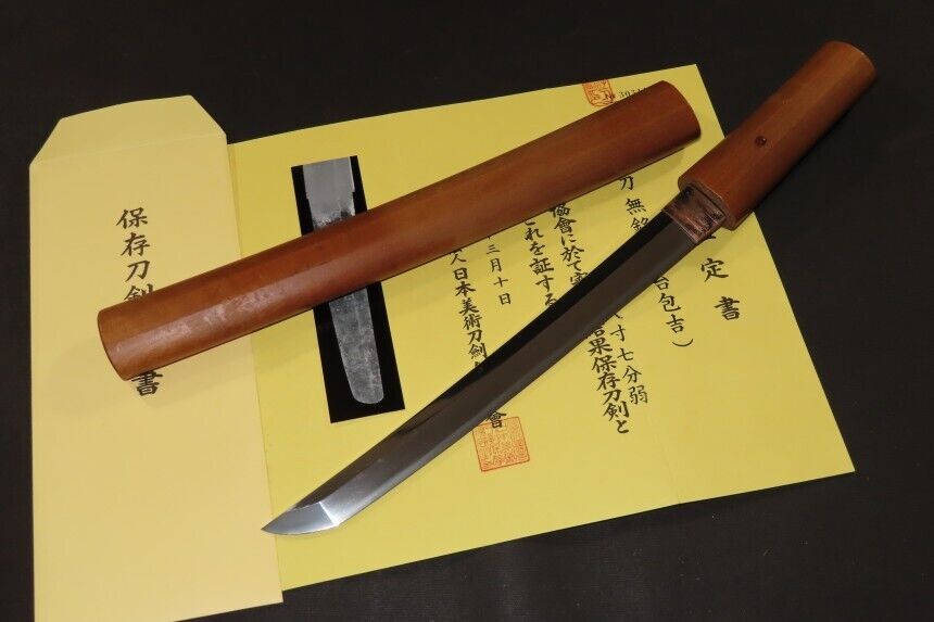

Mark S. Posted August 30, 2023 Report Posted August 30, 2023 Currently on EBay, there is a mumei tanto length blade for sale that has a shinogi line as well as yokote. As has been discussed on NMB in the past this ‘usually’ (nihonto rule - never say never or ‘always’) indicates a tanto fashioned from the end of a katana or wakizashi and wasn’t intended this way… and is considered a bit of a nihonto faux pas as tanto were not ‘made’ in this form. What is interesting is that it has NBTHK Hozon paper. Just for discussion sake, do you believe the reasoning they papered it was just as in the case of a naginata-naoshi or a yari cut down and mounted as a tanto? Based on previous discussions I was able to find, it just seems tanto with shinogi and yokote seems to be a more ‘egregious’ modification? https://www.ebay.com...r=artemis&media=COPY If this belongs in the General Discussion area, please feel free to move. 1 Quote
Franco Posted August 30, 2023 Report Posted August 30, 2023 Quote Hozon Token 1) Edo and earlier blades with correct mei, or mumei blades on which the time period, kuni and group can be identified, may receive Hozon paper. http://nihontocraft....hinsa_Standards.html Regards, 1 Quote
vajo Posted August 30, 2023 Report Posted August 30, 2023 For me it looks like a cut down Katana from shinto period. Nice Hamon with a lot of activity. 1 Quote
Mark S. Posted August 30, 2023 Author Report Posted August 30, 2023 What follows is a bit of a thread back in 2014 that I found, which is why I brought this subject up. Main portion was Darcy’s response to a question: “Question for everyone: Has there ever been a high quality shinogi zukuri tanto?” Darcy: I haven't. I asked Bob Benson about this too and he gave the thumbs down. Any tanto with a shinogi that is acceptable seems to be either moroha-zukuri, osoraku-zukuri or some other derivative. The yokote is bad news on a tanto. It's a curious thing about why it's so abhorrent. But it just looks like sin on its face. Since form follows function it would appear then to make the argument for the tanto as primarily a stabbing weapon, and that the yokote exists to manufacture a kissaki, which exists to top off a cutting instrument. Which is not of course breaking new ground for anyone here, but just interesting that it logically follows from something so simple. 2 Quote
Brian Posted August 31, 2023 Report Posted August 31, 2023 Exceptions include Boy's day and mamori-gatana that have all the dimensions scaled down. This could be a cut down wakizashi, or depending on how it looks next to a short wakizashi..maybe made that way as a scaled down sword. Quote
Mark S. Posted August 31, 2023 Author Report Posted August 31, 2023 Snicker… snicker… Brian said “mamori”… Quote

Tcat Posted June 2, 2024 Report Posted June 2, 2024 On 5/31/2024 at 4:41 AM, Amy said: Has anyone come across more blades like this recently? There are loads of blades around like this, always made from the tip end of broken swords. Avoid them. They are salvage operations in a land of very few resources - serviceable but suboptimal and with little to no artistic value. And to your last question, no. Quote
ROKUJURO Posted June 2, 2024 Report Posted June 2, 2024 Surprizingly, it seems the NBTHK could even distinguish the smith of that blade. If I read correctly, KANEYOSHI is mentioned on the ORIGAMI. Not surprizing is the denomination as TANTO. Whatever it was before, it is now less than 303 mm, so that makes it a TANTO. It could well have been made as short KO-WAKIZASHI originally. Quote
Jussi Ekholm Posted June 2, 2024 Report Posted June 2, 2024 You are right Jean. I would think it is attributed as mumei Sendai Kaneyoshi (仙台包吉). Quote
Scogg Posted June 2, 2024 Report Posted June 2, 2024 (edited) Interesting older discussion. Why, exactly, is it that shinogi-zukuri tanto with yokote are always such low quality? I understand that the form is unattractive. And I’ve seen so many that are more ‘touristy’ than anything. But does it not stand to reason that high quality blades could be suriage to such a short length, that they’d still have some level of quality and interest? When a really nice shinogi-zukuri blade had to be shortened to such an extent. Was the sword simply scrapped rather than changed so drastically? All the best, Cheers, -Sam Edited June 2, 2024 by GeorgeLuucas Spelling: yakote -> yokote 1 Quote
ROKUJURO Posted June 2, 2024 Report Posted June 2, 2024 TANTO which are made out of a SHINOGI-ZUKURI blade are not necessarily low quality, but there will be a good reason why a longer blade was shortened. In many cases, a fatal flaw provoked the loss of a good part of the blade, so these blades are probably of lesser quality. The other thing is that a TANTO is mainly a stabbing weapon while WAKIZASHI or KATANA are designed for slashing blows. These need more mass in the blade which is provided by the SHINOGI-ZUKURI design. 2 Quote
