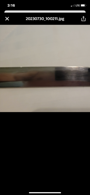

Kent C Posted August 27, 2023 Author Report Posted August 27, 2023 Thanks for the reply Mark. The blade has 3 very minute chips in it. Does this devalue it badly? Kent Quote
Mark Posted August 27, 2023 Report Posted August 27, 2023 chips can affect value. cant say how much without inspecting the entire blade hard to know exact age, i am guessing it is not dated. probably circa 1500s Quote
PNSSHOGUN Posted August 28, 2023 Report Posted August 28, 2023 Nothing to be concerned about as they don't go past the Hamon. Quote

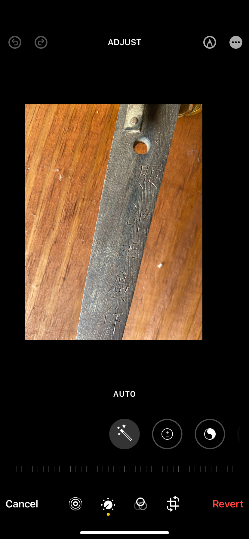

Kent C Posted September 23, 2023 Author Report Posted September 23, 2023 Upon closer inspection, I found these marks at the 2:00 o’clock position of the Mekugi-ana (peg hole). I had to use a magnifying glass to try and get a decent image. Any help to identify them would be much appreciated. Thanks - Kent Quote
Bruce Pennington Posted September 23, 2023 Report Posted September 23, 2023 Kent, That looks like a lightly struck, partial Seki stamp. The kanji below the hole looks like the beginning of a showa date. Can you show the rest? Quote
ROKUJURO Posted September 23, 2023 Report Posted September 23, 2023 Doesn't look like the same blade. Quote

Brian Posted September 23, 2023 Report Posted September 23, 2023 Showato, wartime arsenal blade. Quote
Bruce Pennington Posted September 23, 2023 Report Posted September 23, 2023 I agree with Jean Collin, these are different swords and different mei. The one you have is a Masa-something. Quote

John C Posted September 26, 2023 Report Posted September 26, 2023 On 9/26/2023 at 1:36 AM, Kent C said: Also, about what year was it made? Expand The picture you took with the magnifying glass looks like the start of a date (sho). Do you have a picture of the entire nakago (tang)? John C. Quote
SteveM Posted September 26, 2023 Report Posted September 26, 2023 Swordsmith is Hattori Masahiro (服部正廣). He was a Seki smith, making mostly arsenal swords (I think, others will correct me if I'm wrong). Wartime swordsmith, so date of manufacture is, say, 1938 - 1945. 2 Quote
mecox Posted September 26, 2023 Report Posted September 26, 2023 Kent, info on your smith Masahiro and examples: 1 1 Quote
Bruce Pennington Posted September 26, 2023 Report Posted September 26, 2023 The blade appears to be non-traditionally made. Blades with the large Seki stamp were made between 1940 - 1945, with most of them found in the 1941 - 1943 range and the massive majority of them in 1942: STAMP SURVEY Stamp 1935 1937 1938 1939 1940 1941 1942 1943 1944 1945 No Date Showa 1 1 1 7 28 24 1 3 218 Seki, large 5mm 1** 5 11 62 10 3 1 233 1 1 Quote
