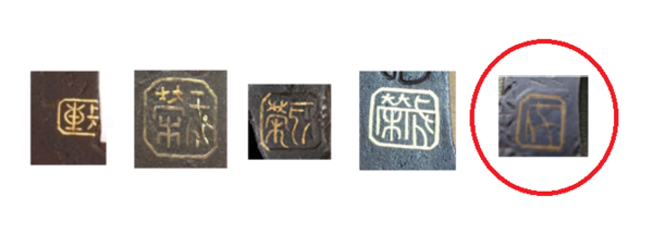

The better images are much more helpful and confirms my Seiryuken Eiju attribution - The small seal or kao easily identifies it in conjunction with the 'grass script' signature, but the seppa-dai is still odd? As Stephen has said the mimi is hand finished and a number of cast pieces were reworked.
The kao is a reasonably common one, see the circled image - these are all seals/kao used by the Seiryuken craftsmen.  I have three with the same seal of the  'Shippo' pattern.
This was a tsuba owned over ten years ago that has the same signature and copper inlaid kao. The artist Seiryuken Eiju was a member of the Tetsugendo School. I remember showing pictures to Mike Y. and having a nice educational discussion. The tsuba I had was in excellent condition for an antique tsuba, made circa the late Edo Period. @GetFuzzy2 Vern, I hope you find this helpful to your study.
