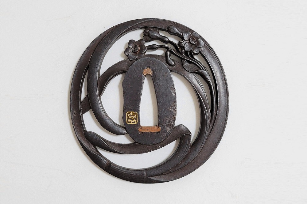

Can anyone tell me more about this tsuba
Yves
Maybe a dumb question but which craftsmen in tsuba's used a golden seal instead of a regular signature? Does such a seal contain words or is it an image of sorts.
It bears some resemblance to this one that is aparently choshu den, Kawaji Han
The Daffodil is called Suisen 水仙 or Secchuka [Setchuka?] 雪中花 (a flower blooming in snow) in Japanese. [the "Herald of Spring"]

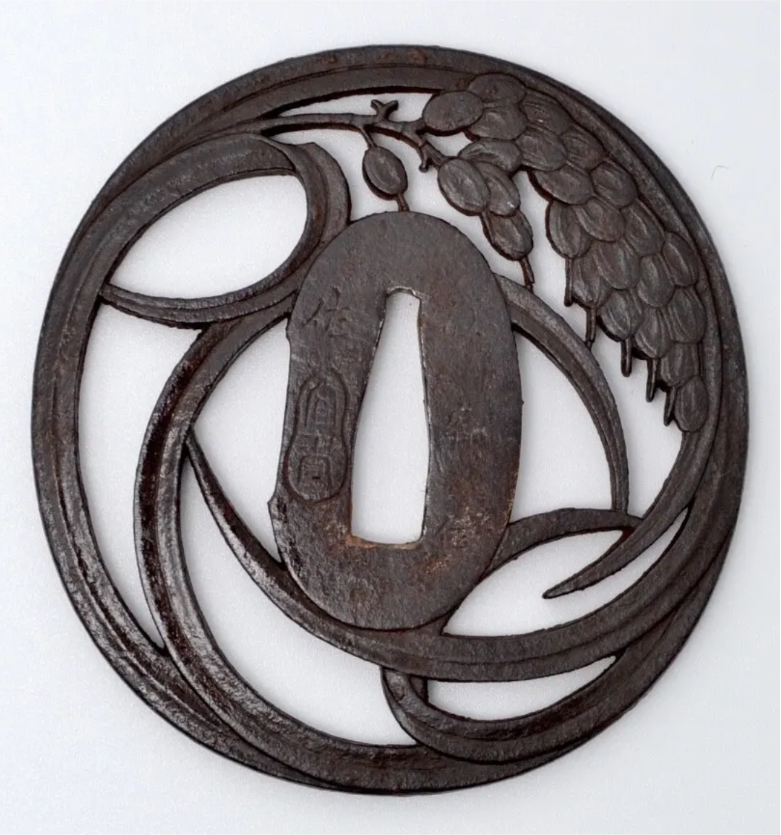

An iris or narcissus in the same layout in the Cleveland Art Museum by Tomonobu  https://www.clevelandart.org/art/1915.93

Could be Tetsugendo Seiryūken?
Most Tetsugendo also have a 'grass script' mei  - [some show signs of erasure] https://www.militaria.co.za/nmb/topic/38984-tsuba-“grass-script”-and-kao/
https://www.militaria.co.za/nmb/topic/37409-seiryuken-eiju-tetsugendo-school/#comment-387794
https://www.militaria.co.za/nmb/topic/45100-seiryuken-eiju-design-tsuba/#comment-468449   - Possible erasure
https://www.militaria.co.za/nmb/topic/41370-seiryuken-eiju-tsuba-again/#comment-425205  - lots of seal examples some close but none exactly like the first post.

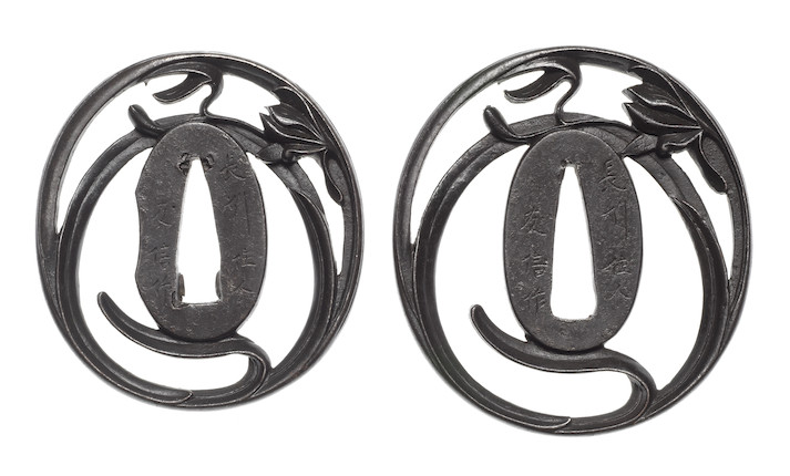

Here is a tsuba with a gold seal in a pot, also reading 谷 Tani, (Koku?) I think, possibly referencing the artistic works of Tani Bunchō rather than being the tsuba maker’s mark per se.
https://www.bonhams....-early-19th-century/  same style.

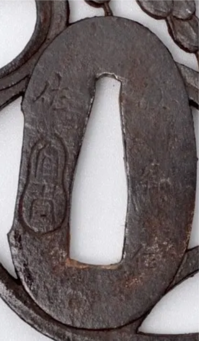

The closest I can find to the seal on the original post is this one - https://www.bonhams....arly-19th-century-2/   Attributed to Tetsugendo Shoraku (Naofusa) - if true it means Naofusa used several slightly different seals over his life time. :dunno:

I have a similar tsuba which started me on a journey to find any info relative to this style.  I believe mine was made by Takahashi Masatsugu.  I am going to make a post about this tsuba asking for information regarding it.  The gold seal is called a “kao“ and is a stylized signature that an artist would use to label their work.  Also used by other powerful or notable figures throughout the hierarchy of Japanese life in those times.

A bit of a long shot maybe, but could the seal be that of the guy who added the gilding? I have a Kaga tsuba with only a seal on and I’ve long suspected that the Kaga zogan was added to embellish an already forged plate.

Hi, that is also a briljant tsuba and I agree. However it seems that in this style the tsuba are quite small and around 65-70 mm meaning they are more for wakizashi, which kinda defeats the reason why I bought it in the first place. I will however keep it as I really like it.

Yes, I bought it from them. Very good and high quality items. Price is likewise. They are also very good to deal with. Unfortunately it turns out the tsuba is a tad too small for the katana I wanted to have made. (ca. 7 cm) and originally more likely to be intended to be used on a wakizashi. I had bought it anyway because the tsuba is elegant and subtle.

I have bought it as I'm really in love with this tsuba and it's waiting to be fitted onto a new sword (nihonto) I have made. The smith will make the tang fit this tsuba.
Are you asking about this one, Yves?
And originally did you mean they will make the tsuba fit the tang?
